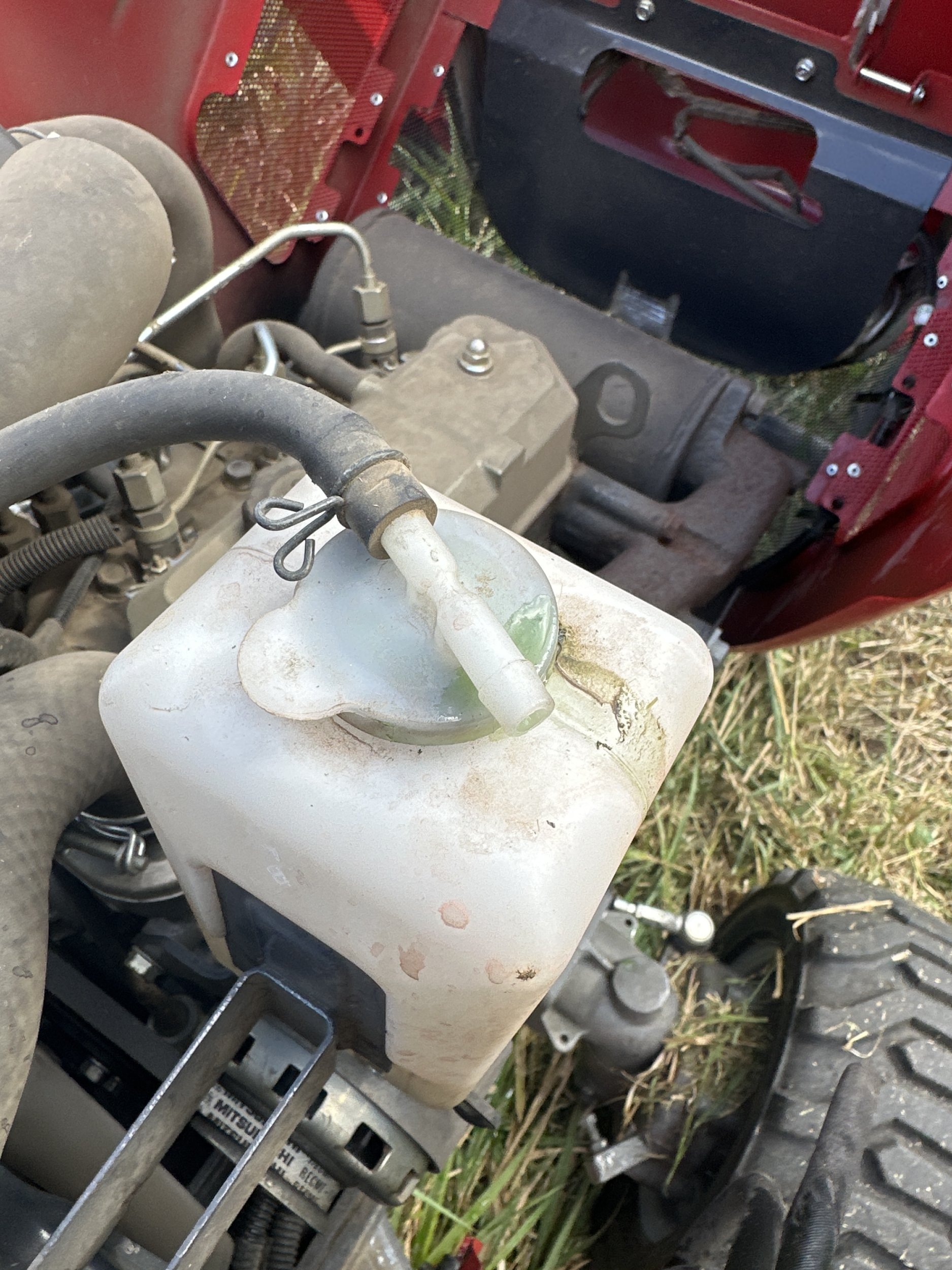

Been brush hogging for the past several days and today, I noticed that the engine was overheating. I immediately dropped the throttle and opened the hood to find coolant spuing out of the reservoir. I shut the engine down so that it hopefully wouldn’t run out of coolant. The reservoir boiled for a while and is now low on coolant. I’m not an engine guy, but is there supposed to be another hose attached to this cap? Or is this open side on the cap just for steam release? Been trying to find a parts diagram with no luck.

/ GC1715 Overheating #2
no other hose attached. cap itself should have hose that drops into tank.
pull the screen in front of radiator (metal screen may need to move air filter intake tube) and clean it.
edit: missed the fact that the overflow tube that exits near frame of tractor was missing, sorry about that.

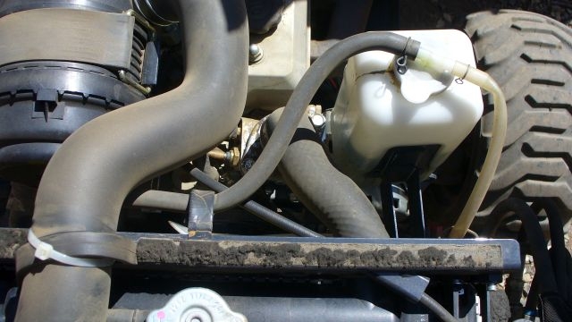

/ GC1715 Overheating #3
The overflow looks fine.

/ GC1715 Overheating #4
Dave is right. Some of these have the overflow hose from the base just beneath the radiator cap going into the overflow jug bottom and then the hose leaving the jug at/near the top goes down and out to the atmosphere under the tractor as waste. Of course you need to refill your coolant with the 50/50 antifreeze/water mix. Most importantly find out why it boiled over. VERY likely as Dave said you have the screen in front of the radiator or the radiator itself plugged up with chaff, grass, dust and crud. I find compressed air and a spray nozzle handy for cleanout. Unlikely it is anything else but if the problem persists after cleaning it is a real necessity to get to the bottom of the issue.

My GC 1715 has a over flow tube going from cap of catch reservoir down to below tractor chassis....

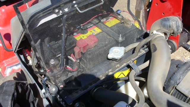

Also I would check the screen in front of radiator to see if plugged with grass and debris....

most likely would have seen the battery light on and heard the belt slapping the radiator as it flies off, GC series VERY tight there. rad is mounted on "rear" side of engine and fan/alternator very close to stuff.
I'm betting the metal screen (slides up and out of rear of radiator) plugged. been there few times myself.
