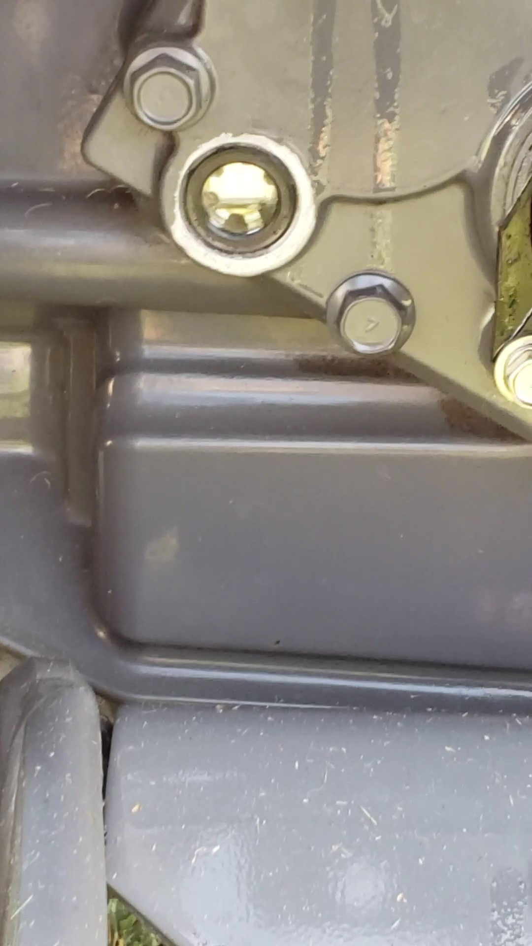

   / GC1715 Blowing hydraulic fluid
#36
Shot video and uploaded pictures you can see sight glass isn't full but fluid is coming out fill tube.

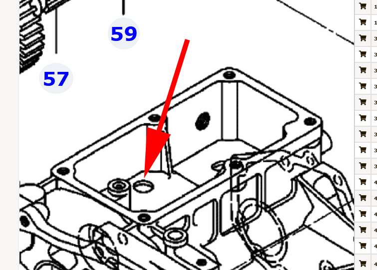

   / GC1715 Blowing hydraulic fluid #38
Seeing the last images you posted my immediate reaction is that you have some kind of blockage inside the transmission that is preventing the fluid from flowing properly. The transmission is separated internally into sections and there are ports between these sections that allow fluid flow. Fluid returns to the top compartment that is connected to the fill tube. There is a port between this compartment and the one below it where the sight glass is located. This makes me suspect that there is something blocking that port.
   / GC1715 Blowing hydraulic fluid #39
This is the compartment that the your fill tube connects to and where the fluid returns to. Port is marked
   / GC1715 Blowing hydraulic fluid #40
I'm with Hube on this.
