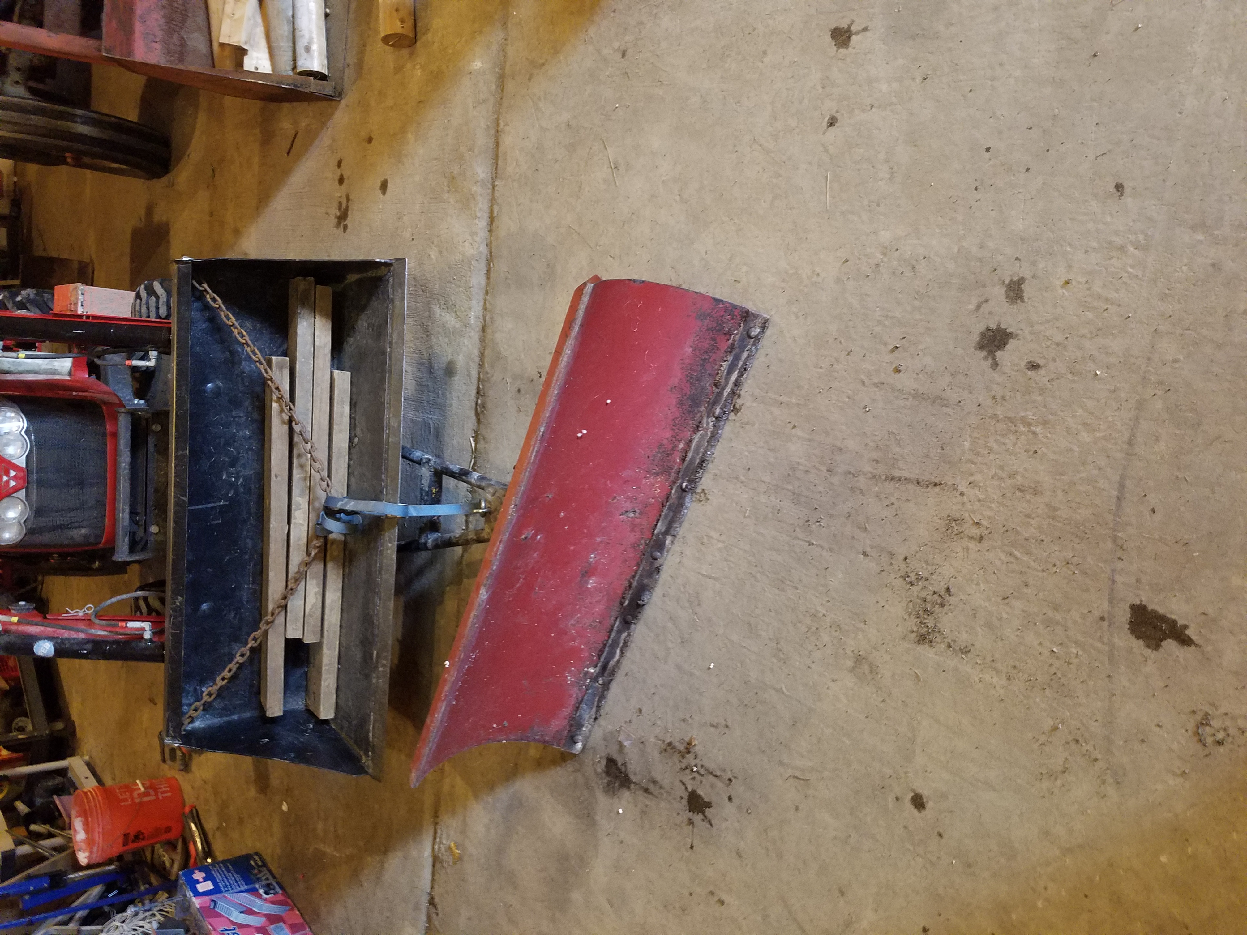

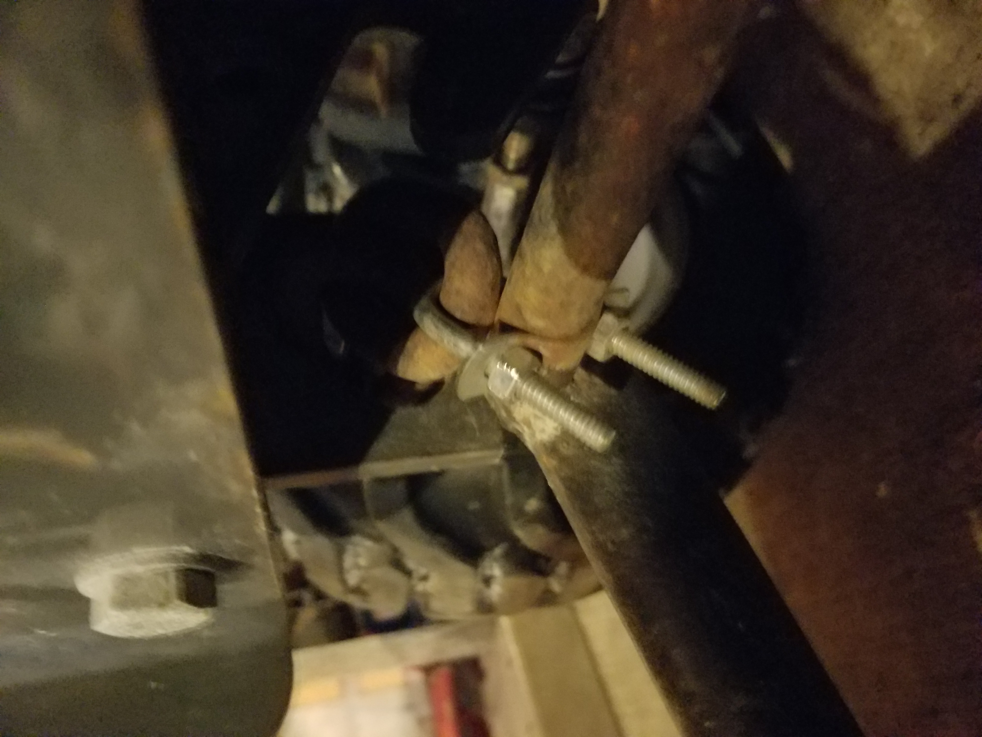

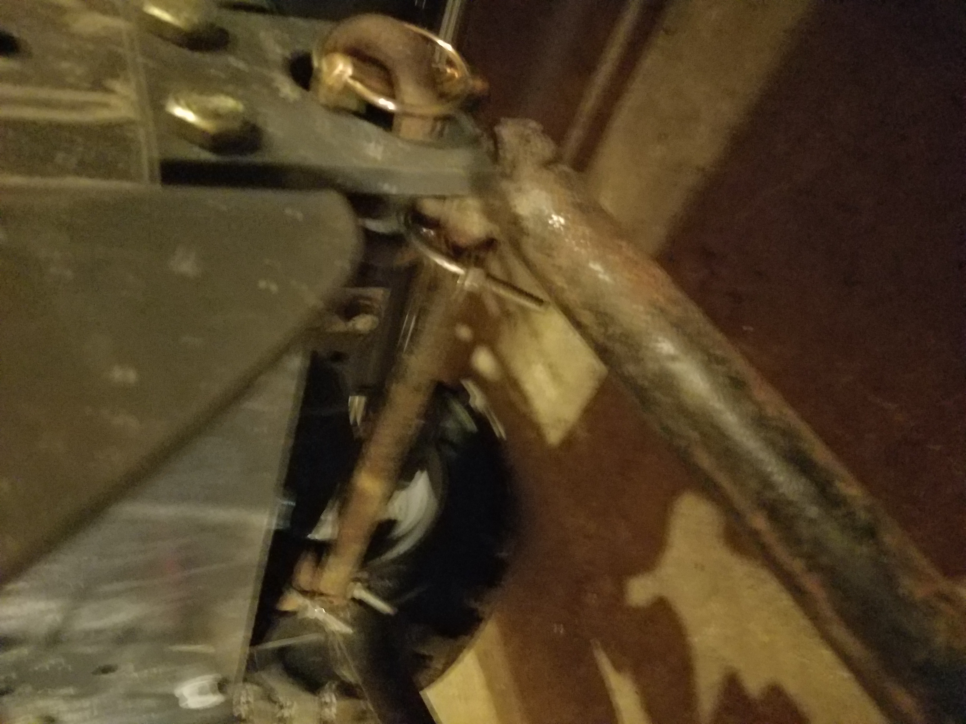

I wanted to have a front plow to utilize in addition to my back blade. I had an old plow from a wheel horse tractor i wanted to try to install. I cut two links of a big chain off for each side then lynch pinned it to the tractor after connecting it to the existing brace of the plow frame with a u bolt. Connected a strap to an eye on the frame and then to that chain on bucket. With only 2 links on the back it makes it too short to sway back and hit anything on my tractor. I know i will need 2 longer lynch pins for strength. We are supposed to get a few inches of snow tonight so I can try it out. 1517680186583.jpg

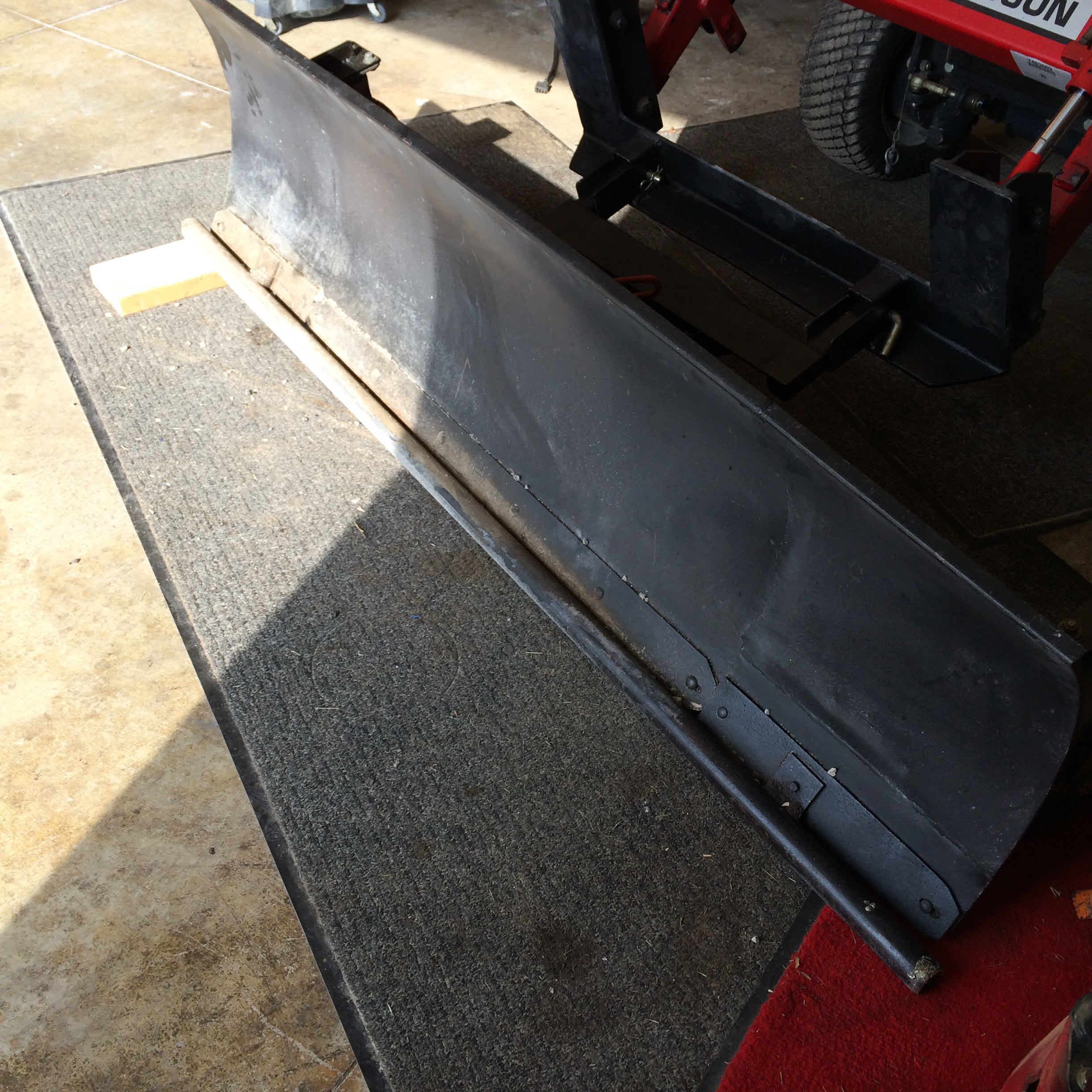

This is made from two Bolens tube frame plows.
Works great.

That's a really sweet set up
   / Gc1705 with old wheel horse plow and frame #4
Thanks. It was more of a test when I did it.
It worked so well, I just use the prototype.
You should try to find some thing to add some width to the blade.
I started with a 42" plow, and added the outer part of a second plow to each end.
