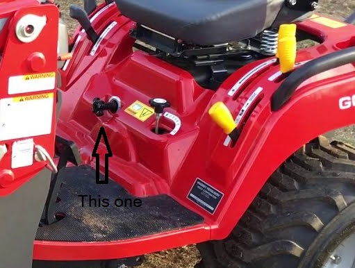

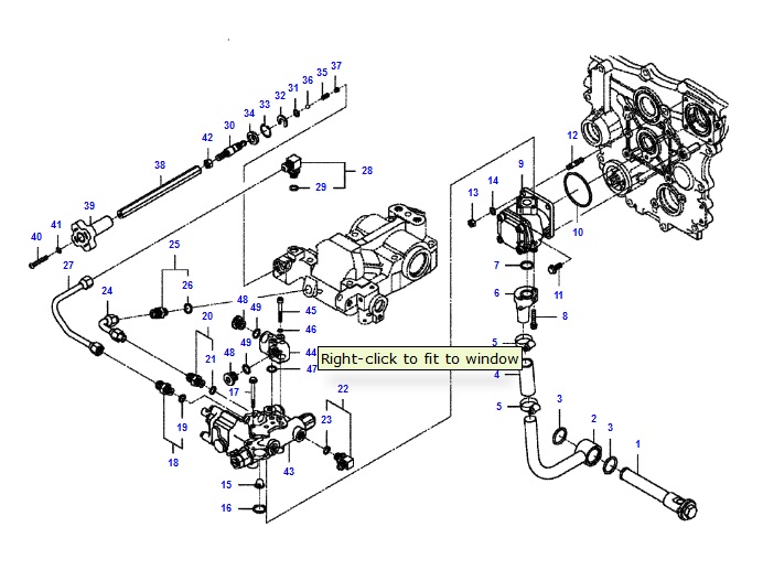

In the parts book there are 2 adjustment knobs for the MMM. The height adjustment is mechanical for the height. The other knob controls the speed of raising/lowering. It also affects the 3pt as well. Fully closed it will stop the 3pt from moving.
#39 in the pic.
The shaft #38 threads into another shaft #30, both have to turn.

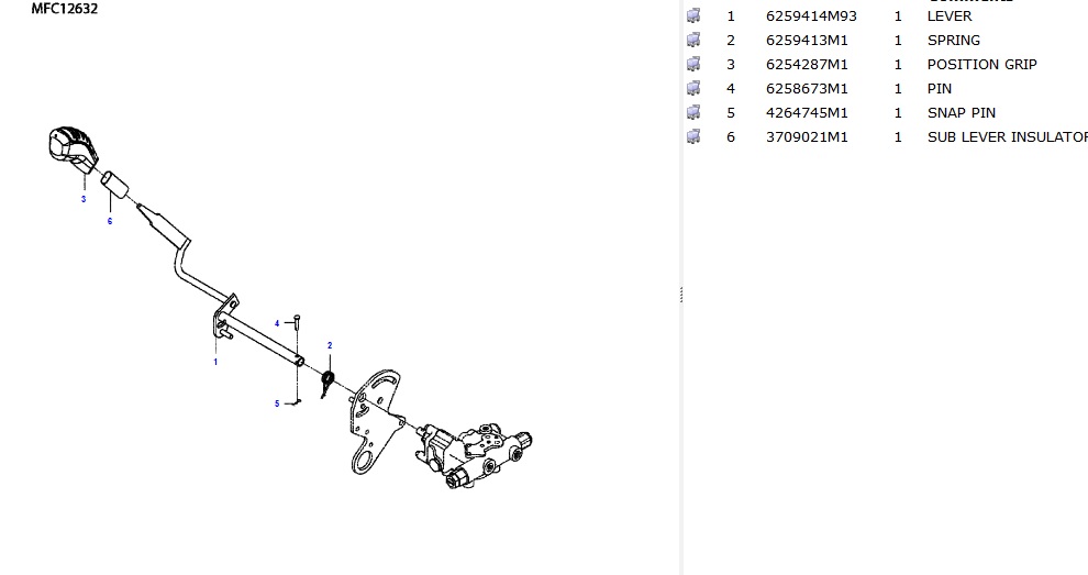

/ GC1705 - Multiple Issues - Hydraulic Concern - Feedback Welcomed #20
Check that the shaft for the 3pt raise/lower is moving. Sorry about the poor pic. The shaft goes under the front of the fuel tank to the valve block. My GC2300's 3pt lever has a connecting sleeve held on by a pin with a clip. Yours is probably different, but check for free movement with the engine off.
