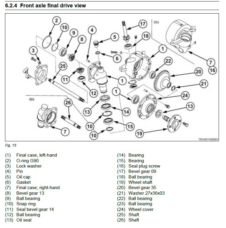

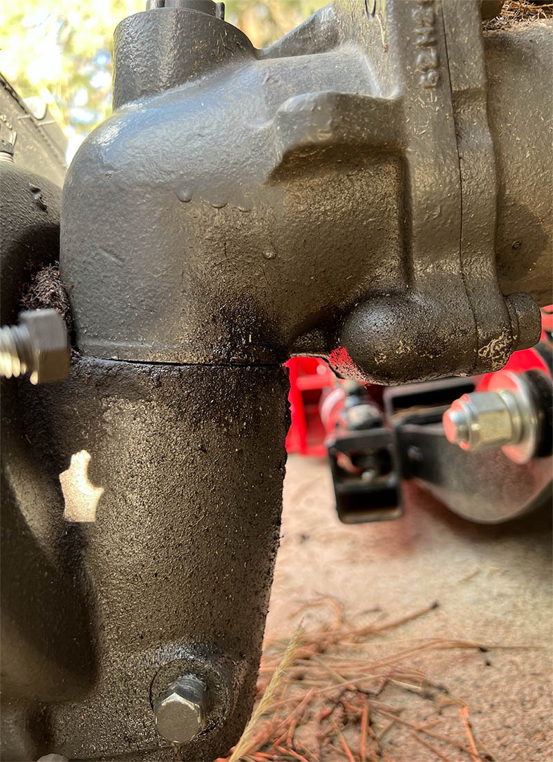

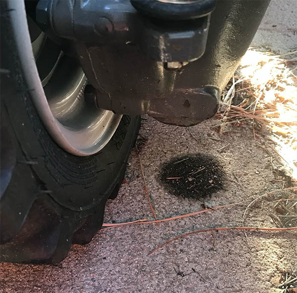

I have a GC1705, and it appears that the front axle seals have leaks on both sides. Can someone familiar with the topic confirm I am diagnosing this correctly?
Looks like I need to replace the oil seals listed as #13, as per the below diagram, and that is the only part I need to buy?
Anyone know what causes this?

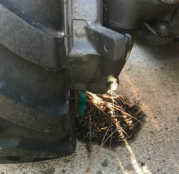

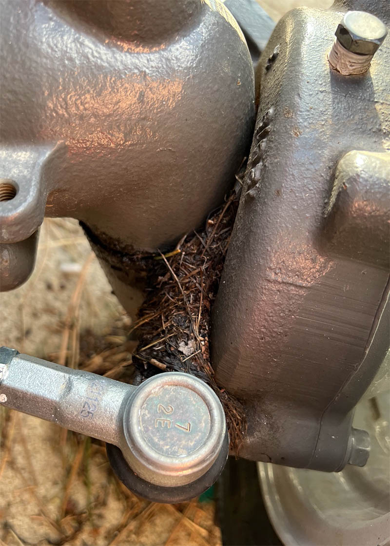

I am at 283 hours, so this seems like a premature failure to me. I wasn't sure if it could be related to overloading the front axle with bucket or forks... I feel like I have done that before. I saw one post, where a person mentioned the dealer commenting getting leaves shoved into the axle can lead to this, and as you can see below, there is a bunch of stuff caught up around the tie rod end area.
I assume there is no harm using it in the meantime, provided enough gear lube is present? If I recall correctly, I just need to verify by opening the cap at the top of the first picture to confirm enough gear lube is present.

The seal leaking is always caused by other issues that allow the outboard to have excessive vertical slop in it. Usually the kingpin bushings are shot and they are easy to replace. Just replacing the seal won't cure the issue as it will start leaking again as the seal cannot seal with excessive slop in the outboard. I suggest at least buying a set of kingpin bushings before taking it apart. it the kingpin is also worn (unlikely bit could be, that will also need to be replaced as well. The bushings are inexpensive and easy to replace. Kingpins, not so much but you won't know until you take it apart. I would order the bushing in advance in as much as parts availabilty is a crapshoot today.
Easy to diagnose too. Loft the front axle and try wiggling the wheel and kingpin vertically. If there is slop (wiggle), the bushings are shot and if it's been like that for a while, maybe the kingpin as well.

Just a note:
The left front knuckle on the Hurlimann leaked persistently from the day I got it (used) .
I topped off the gear oil nearly every time I used the tractor.
Then I cleaned off the area and pulled the grass out from the swivel joint to have a look, The axle has not leaked a drop since!
So, have a look. ;-)

Usually, once a radial seal starts leaking, they don't quit leaking until replaced. The other issue is how the front axle is vented and if that vent is plugged with trash. The axles have to breathe (either by dead air space above the lubricant) or via a to the atmosphere vent or the axle will become pressurized as the lubricant warms up. Why the differentials on your car or truck have a vent hose on them. If they weren't vented to the atmosphere, the outboard axle seals would leak. In reality the radial seal on each outboard has a very small contact area so any vertical movement in the outboard can cause the seal to weep lube oil. I've replaced a number of them on my large Kubota's and in every instance, the kingpin bushings were shot which allowed the vertical movement of the outboard. Easy to replace to the correct sized bushing driver or appropriate size socket and hammer and remove the worn ones is a simple matter of driving them out with a punch.
