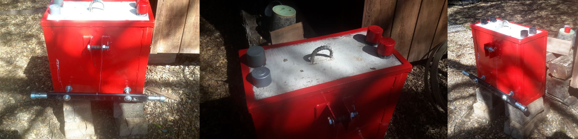

I made a 2x2x1 foot box (4 cubic feet) filled with concrete for my GC 1715... Concrete weighs in about 150 pounds per cubic foot... Box should weigh in about 600 pounds... BUT mine took eight 60 pounds bags of Quickcrete (480 lbs ?)...
This comes from manual and how to calculate weight of ballast...
This is what I made....

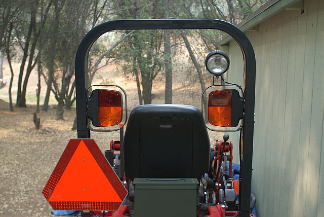

Used 2 inch black ABS tubing cast in concrete for tool holders, rattle can caps keeps "stuff" from accumulation it tubes...
Might also consider moving tail and turnsignal lights in board..... Damage one, and its $127 to replace....
Don't ask!...
Dale

Thanks Dale. The ballast box looks great. I love what you did with the lights. I'll try to do the same with my lights.
Also, the headlights are not very bright. I'll try to find some LED bulb replacements and add some additional lights on the ROPs.
You have to swap the left and right side lights to get them inside... I used a couple of washers between ROPs and lamp fixture to keep from crushing wires and just used ties to tie wires down ROPS...
Dale
