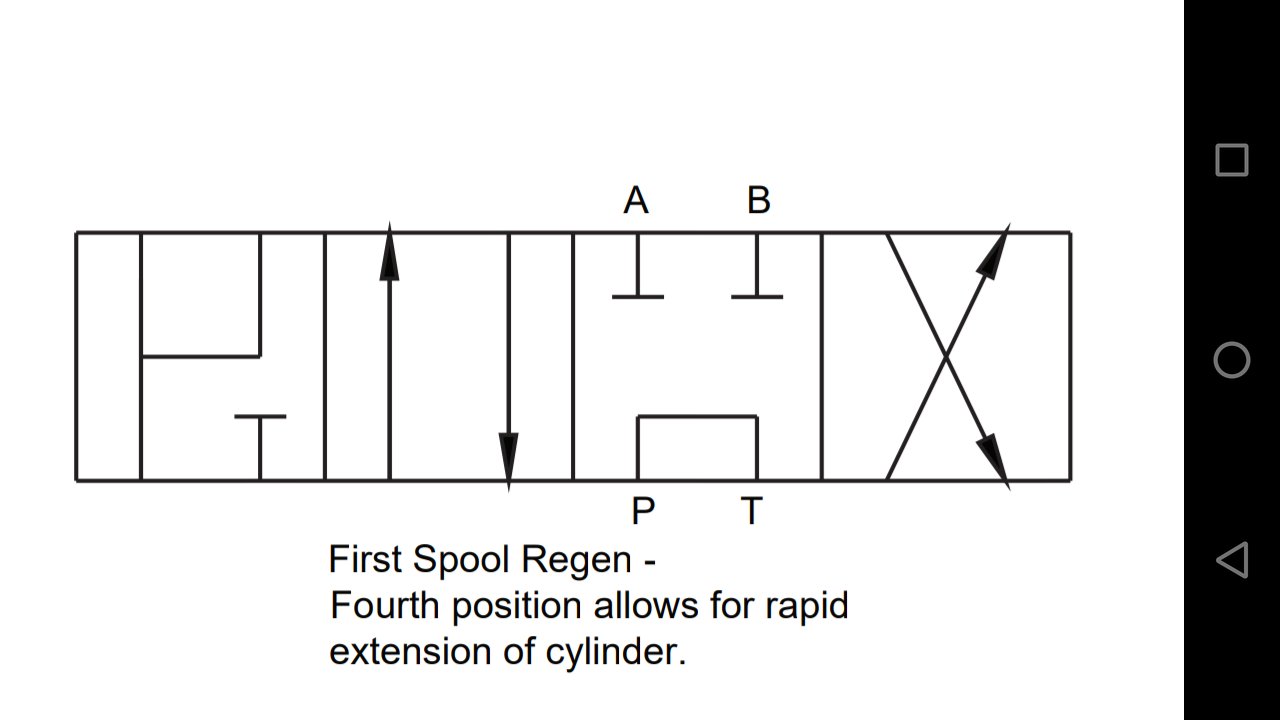

Respectfully, you are incorrect. As I said before, the quick dump or regen dump feature ties both hydraulic lines to the bucket dump cylinders together with the high pressure input line from the hydraulic pump (or the next valve closer to the hydraulic pump).
It works because of the difference in surface area between the base end of the cylinder and the rod end of the cylinder.
Because the rod end has a greater surface area, the force pushing the bucket to dump is greater than the force pushing the bucket to curl.

Here is the flow diagram for the bucket circuit of the Surplus Center regen valve that I linked to before:
Each box is a different position for the bucket circuit in the valve, the top two connections are the lines to the bucket (A and B) The bottom two are the pressure inlet (P, on the left and T, on the right).
Note that in the far left box (regen dump), the P, A and B lines are connected.

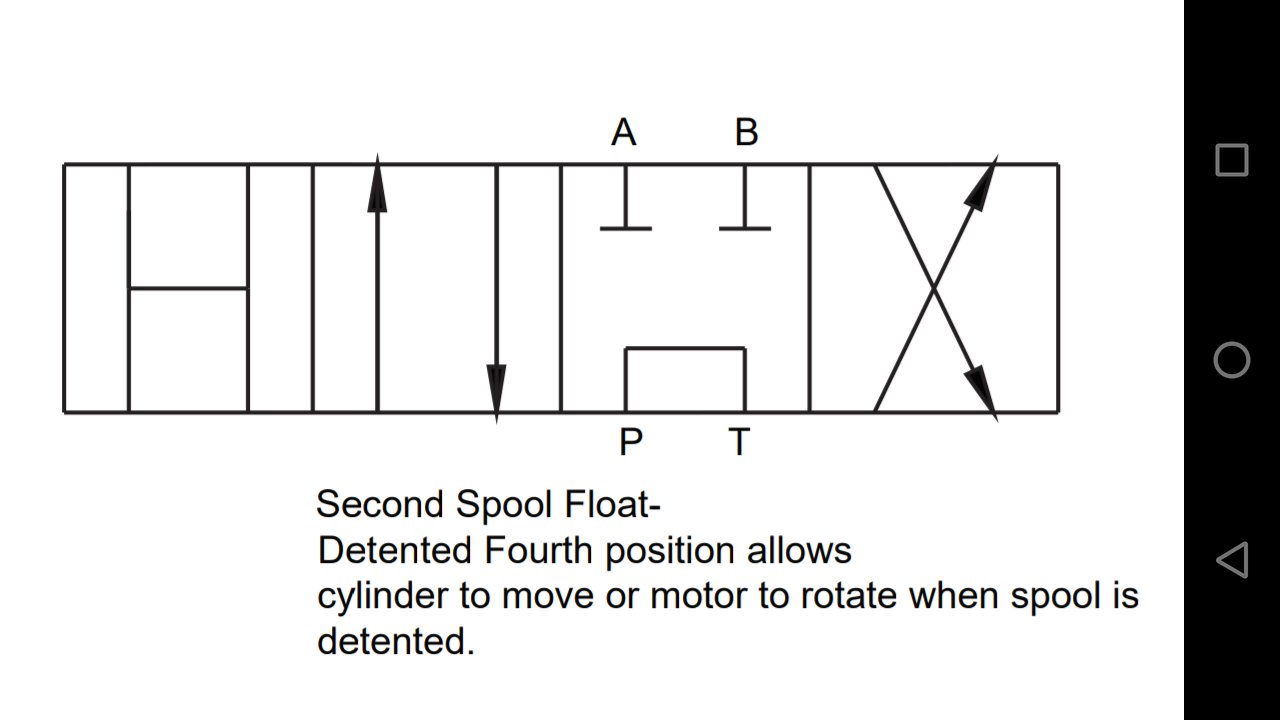

Here is the flow diagram for the loader arm circuit of the Surplus Center regen valve that I linked to before:
Each box is a different position for the bucket circuit in the valve, the top two connections are the lines to the loader lift cylinders (A and B) The bottom two are the pressure inlet (P, on the left and T, on the right).
Note that in the far left box (float), the P, T, A and B lines are connected, this is different from the regen circuit and is why the loader will lower in float vs raising.
In theory, if you swapped the lines for the loader lift and bucket dump circuits, it would lift with regen dump position if the pressure difference was enough.

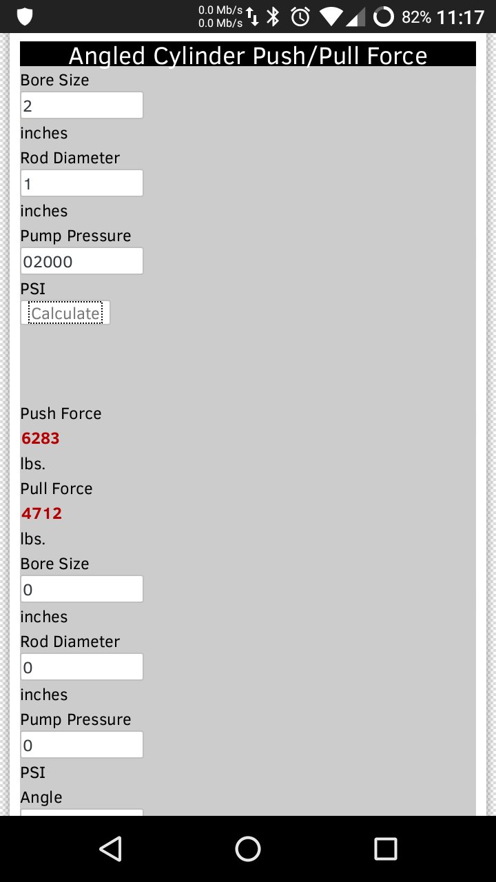

As for the pressure differential, with a 2" bore, 1" rod cylinder and 2000PSI fluid, in regen mode, you would have 4712# trying to retract the cylinder and 6283# trying to extend the cylinder per the Surplus Center calculator at: Surplus Center
So, each cylinder would be trying to dump with 1571# of force.
