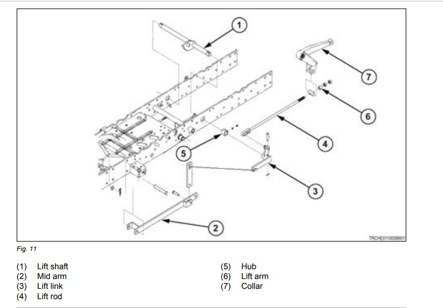

Kind of seems like arms and collars are pinned to shaft, have not looked real close but cursory glance they seem to be its only locked in by pins and collars(arms) ... To my dismay the shaft rides in two sleeves in frame with zerk fitting that there in no way to put grease gun on zerks (also no listed in lubrication guide) ,,, Was trying to do more than cursory glance to se if practical to partly disassemble shaft enough to put 45° zerk fitting in sleeves but then again I don't use mid mount mowers so wear on shaft is not is a issue for me...
Might try removing pins/collars/arms/hubs and sliding shaft over enough to get clearance to access fan...
Kind of seems to me if you can get hubs (5) off shaft (out of frame rail) you may get enough angle (motion) to remove lift shaft...

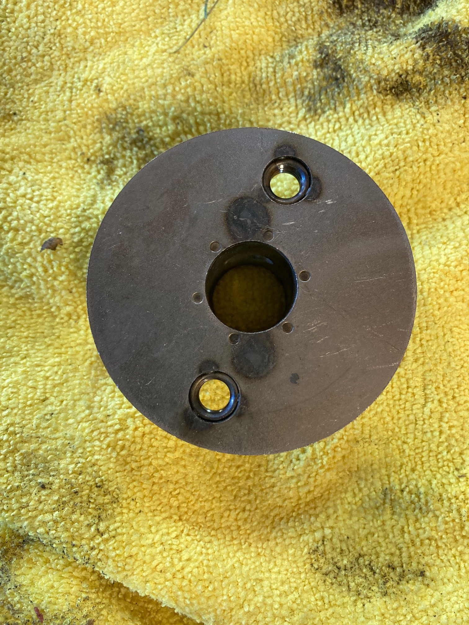

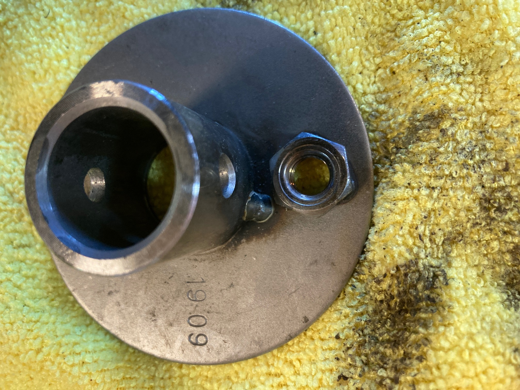

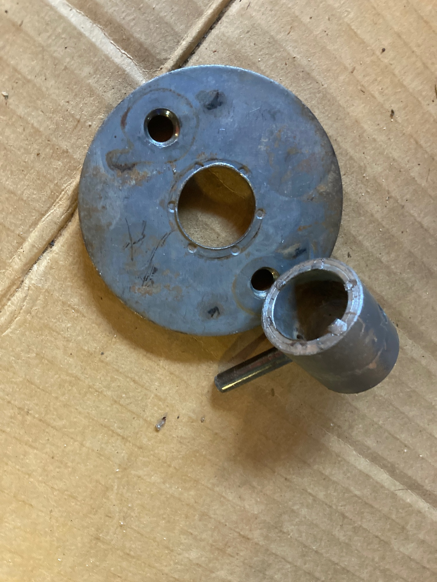

Well, it's fixed and here's what I found. The fan itself was intact but the hub that it bolts to had come apart. You can see some tiny spot welds that failed. I suspect fatigue failure due to normal vibration. The fan and hub collar were spinning free on the shaft and the hub mounting bushing was still attached to the shaft via a roll pin. You can see in the second and third photos that the new hub had the same spot welds, but...it was reinforced with two tack welds on the front face. It looks like I wasn't the first to suffer this failure and they have improved the part.
Luckily there was no shaft damage. Getting the old parts off and the new parts installed was a project. All I can guess is that they assumed the fans would not have to be replaced.
