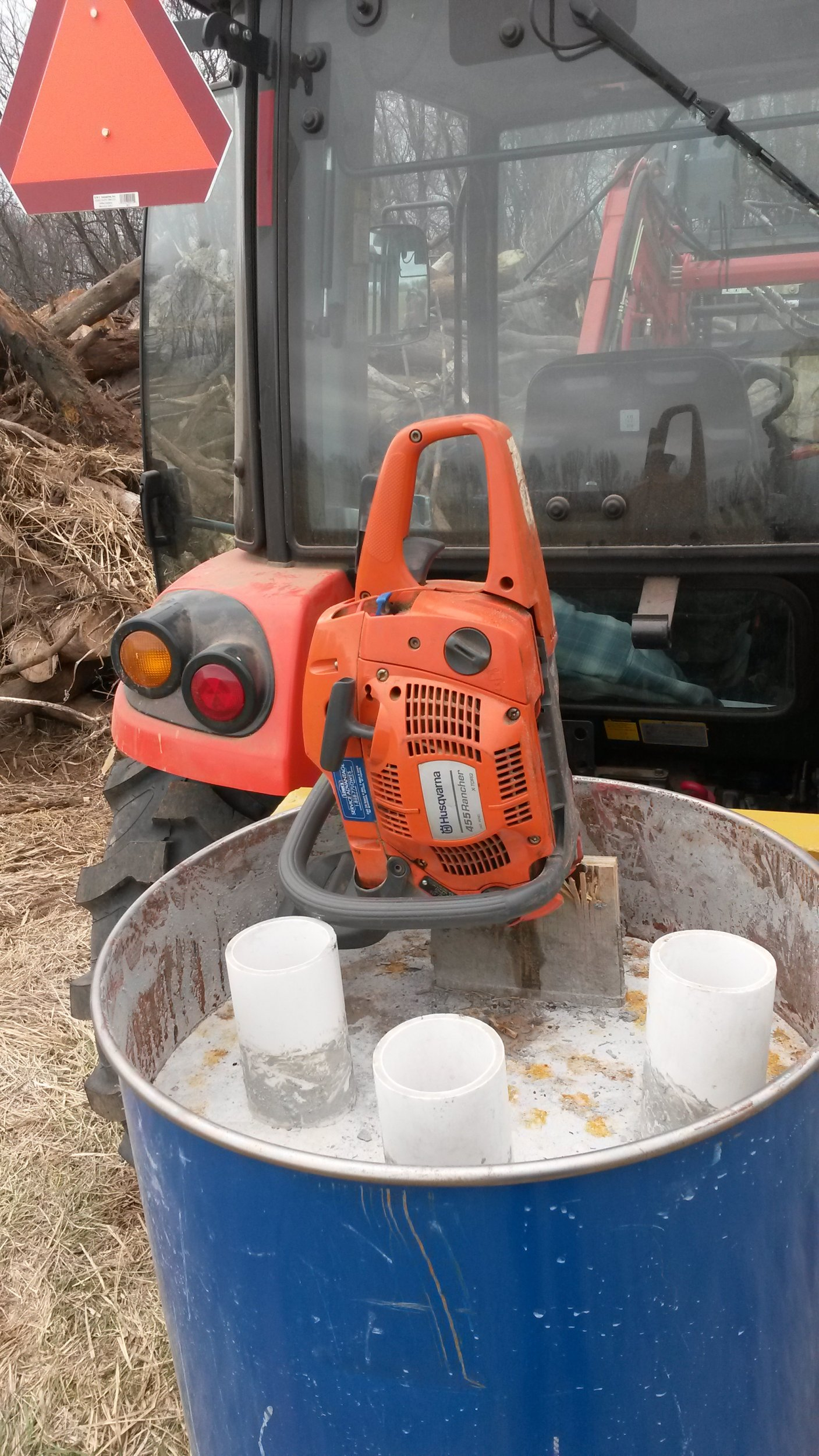

I did the same as above - but mounted my barrel on a TractorSupply Carry-All. I also inserted 3 4" PVC tubes and a chainsaw scabbard. It's a great and CHEAP weight but also carries my shovel, rake, pick ax and chainsaw.

Found a pic. By leaving the concrete recessed about 6 inches from the top, you can also toss lots of small tools in there. The PVC also sets below the rim so I can put a lid on the thing if I need to leave it out.

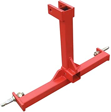

Just add weights to something like this..

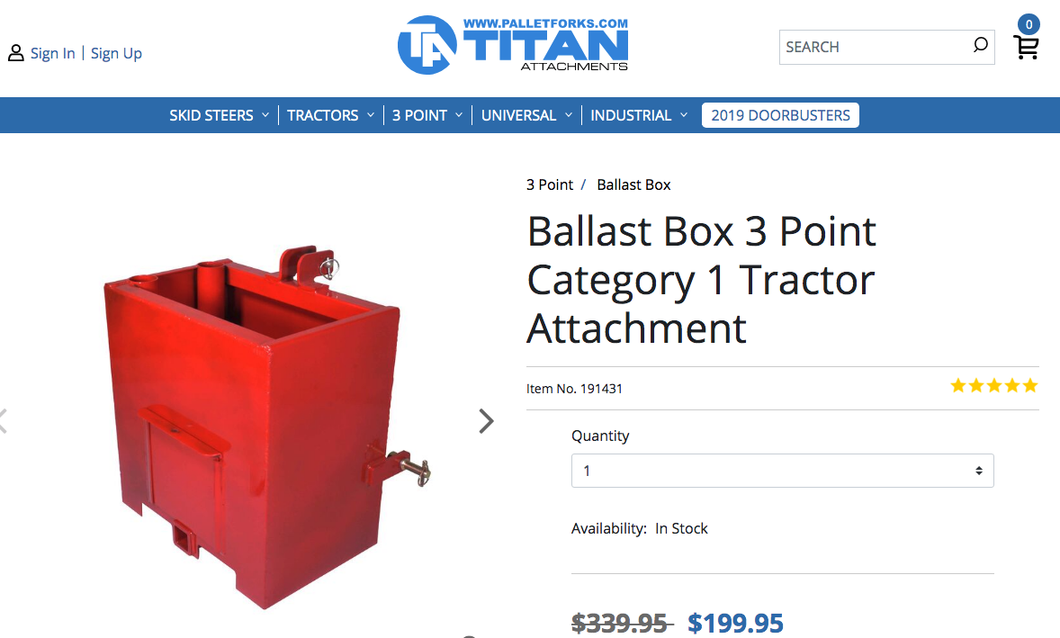

Here's the one I got a couple of years ago. The screen shot has all the details, 'cept the red one is no longer available and the sale price is over...
That vevor link is the same unit - better price.
