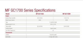

Hey all, new here, just ordered a gc1725m tlb.
Looks like the 23 develops peak torque earlier (65nm@2000rpm than the 25 (65nm@2200rpm)
At least in the Australian spec, pic attached.
That would suggest different valve timing to me. Given we’re naturally aspirated and they wouldn’t have a lot of wriggle room with air fuel ratios due to emissions, I wouldn’t think it’d be all in the fuel. What do you reckon?

daman1, in the context of discussing at what RPM the engine develops peak torque, why does it make a difference where the torque is measured? I would have thought that the torque curve would be about the same shape regardless of where it's measured, perhaps incorrectly? Genuine question, I'm a massive noob.
With that said, I reckon it's measured at the flywheel. 2200rpm@65Nm is 14.3kW which sounds about right.
The PTO delivers 13.8kW@540rpm which is 244Nm so the 65Nm is probably too low.

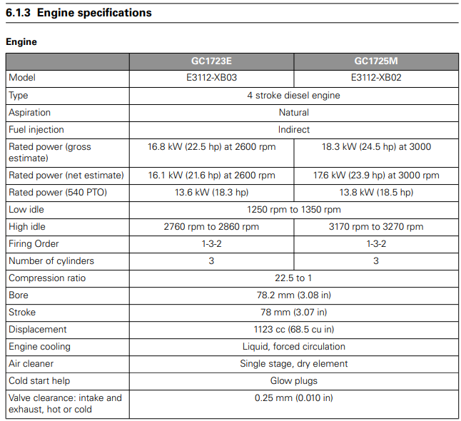

Here's an extract from the manual which shows they're slightly different engine models (XB02 and XB03). I can't find Iseki's specs on those engines though sadly.
Does anyone have access to a parts catalogue? It'd be interesting to see if they use different camshafts.
Yea,I seen that too, That's what a dealer will tell you and that's true workable horsepower when it comes to a tractor, you want to know what PTO horsepower is for future Implement purchases.
That's what's confusing I have the parts manual on hand and service manual neither one shows a different part number but I'm going to look again just in case I missed it.
