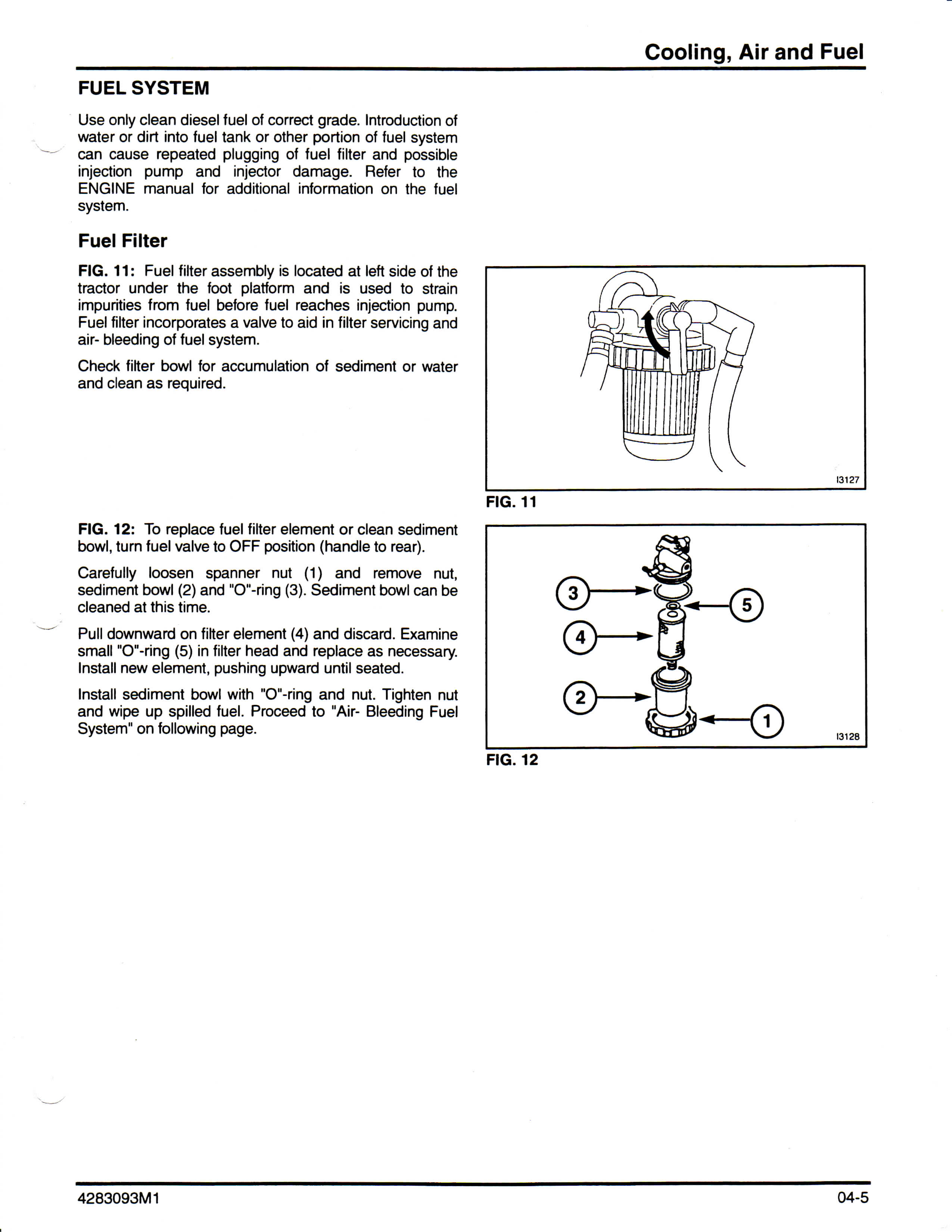

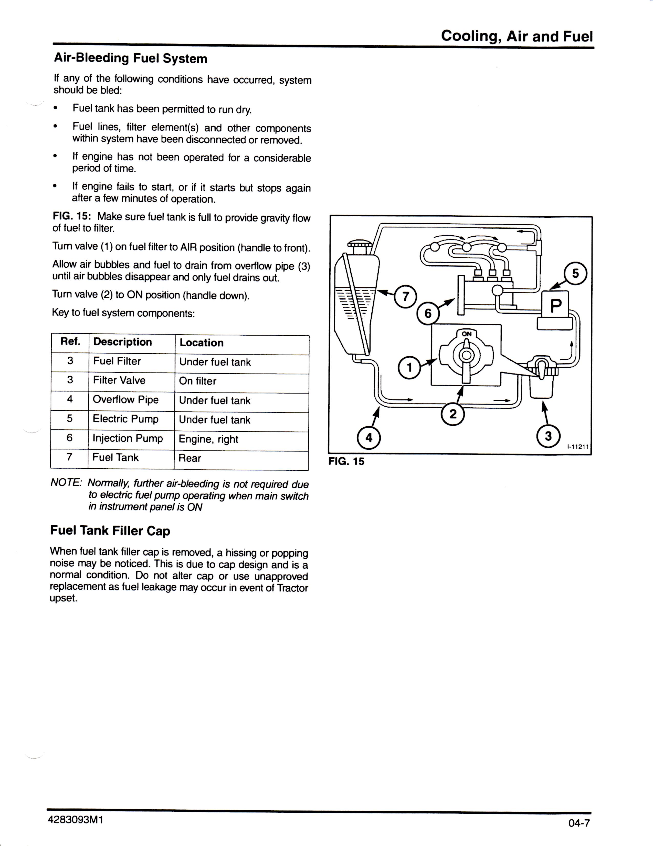

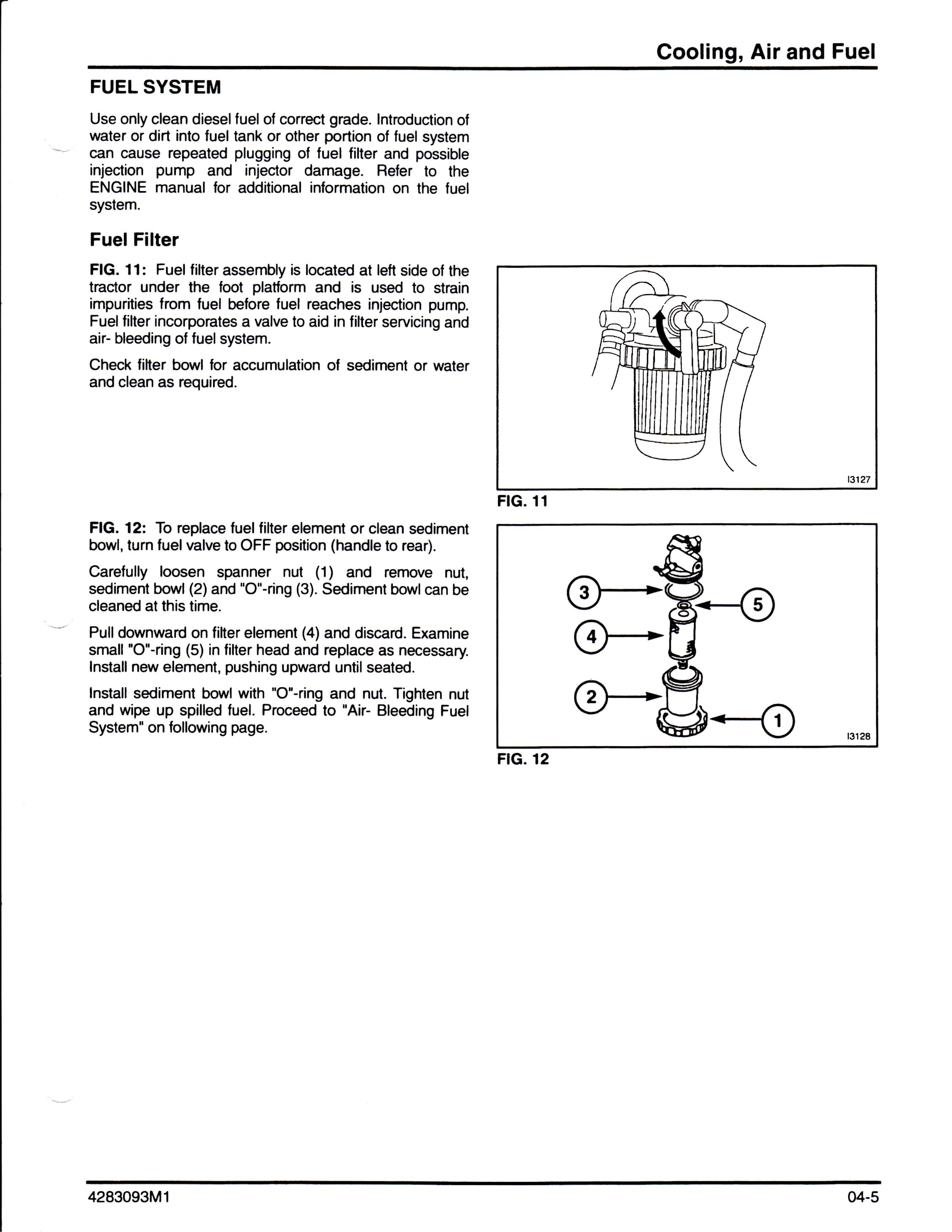

It痴 me again! Is there a fuel filter on this puppy ��
Yes, here are 2 pages from my GC2400/GC2410/GC2600/GC2610 Shop Manual that should be helpful. The fuel filter is almost underneath your left foot when sitting on the tractor.

Thanks MF RED. I was looking under the hood and was wondering why I couldn稚 see it. Once again you致e been very helpful and it痴 much appreciated.
