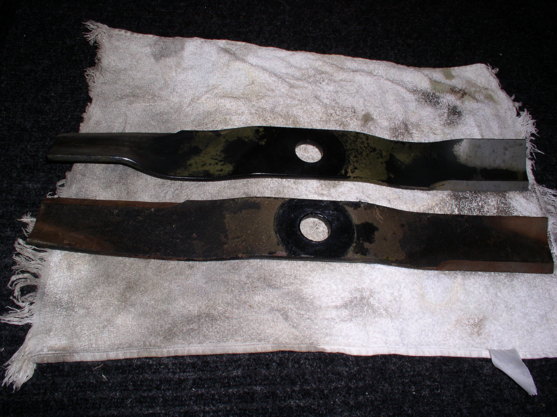

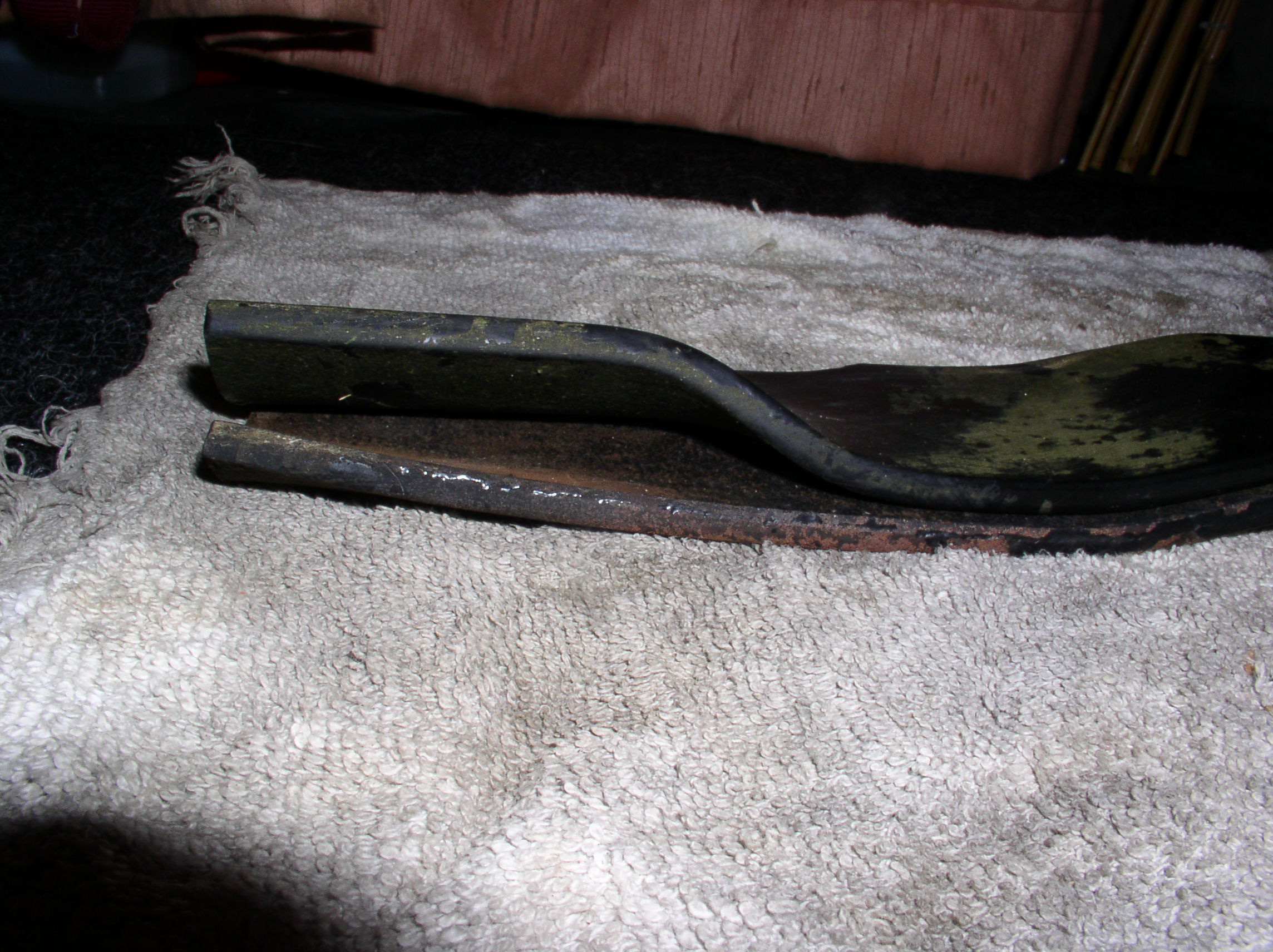

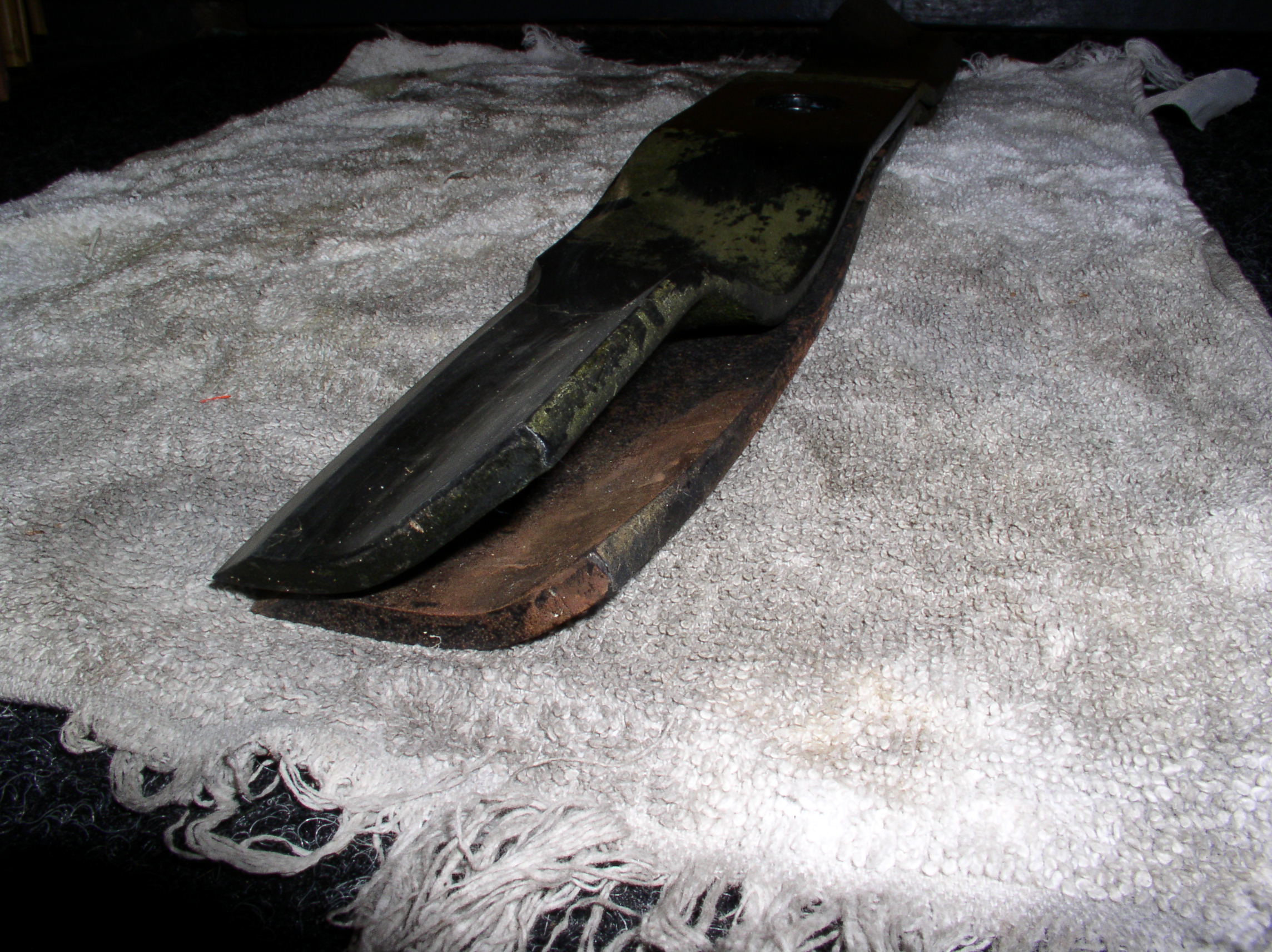

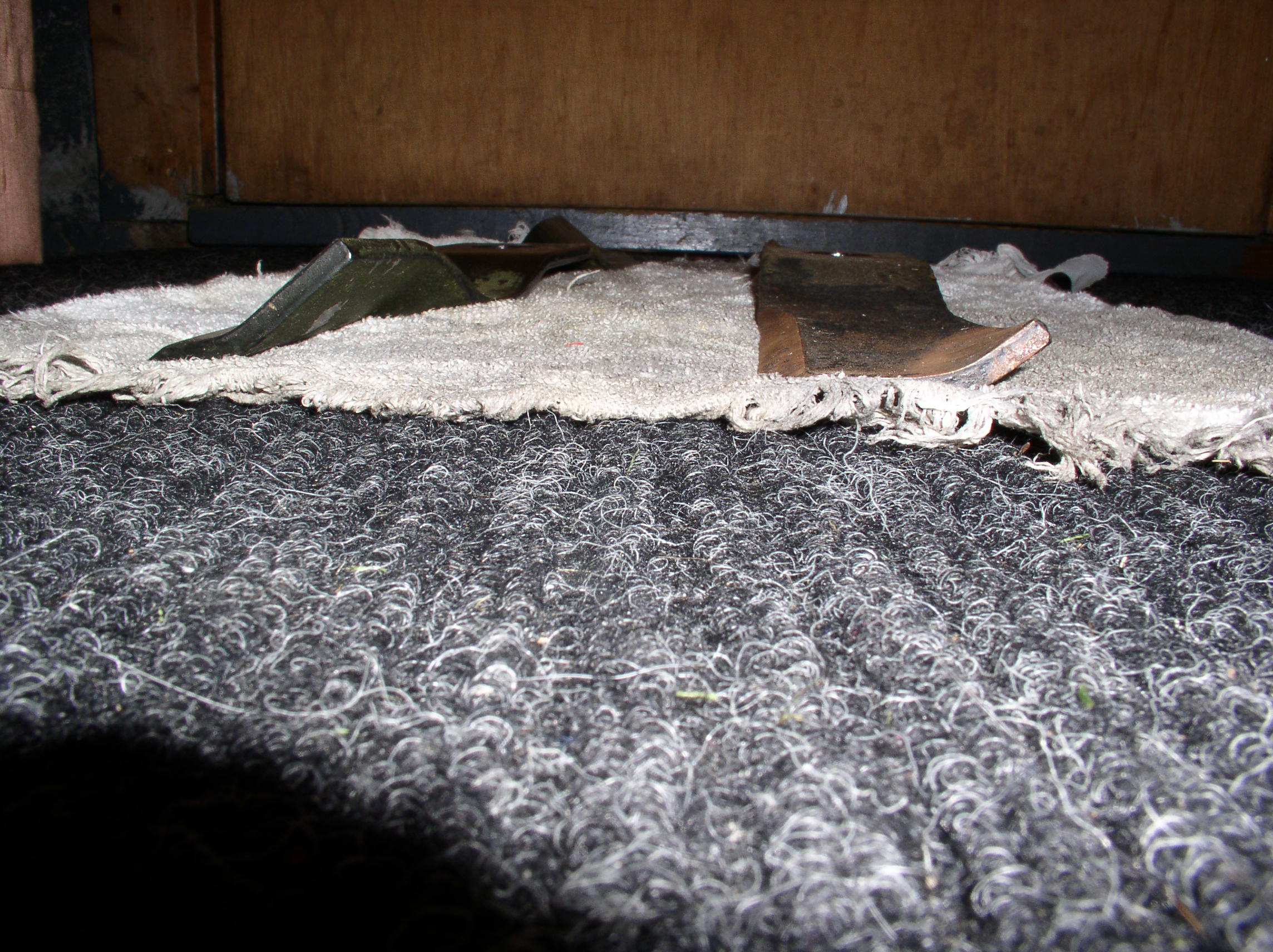

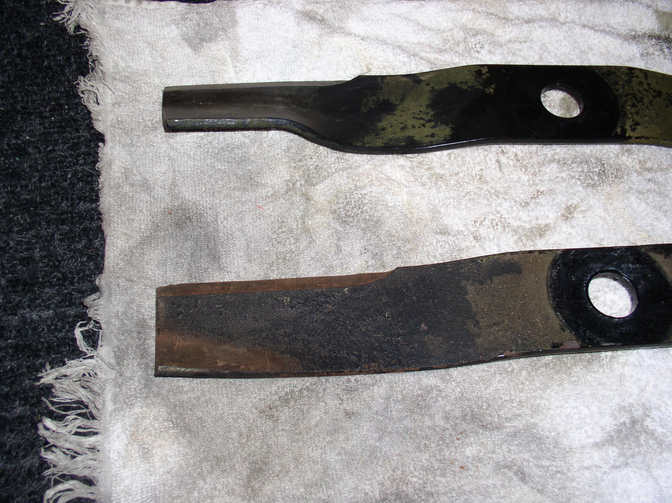

   / Gator Blades and B3030 60"MMM #7
Toolguy,
Here are some pics of the two blades. They are not greatest but you can clearly see the huge difference in lift between the two. Hopefully this will help you and anyone else who is looking for these blades. I know it took me a long time and effort to track these down and it was worth it. On the flip side, my stock mower blades and these new ones didn't come with a sharp edge at all. I had both sets sharpened and the repair shop that sharpened them for me couldn't believe they were new. Do yourself a favor get them sharpened before you leave the dealer.

Wow! The difference is night and day. Thanks for the pics. The gator blades made a lot more noise than the stockers. Your mower must sound like a vacuum cleaner with those blades.
What is the biggest difference that you see in the performance of the mower? I am looking for more lift to pick the grass up that the front tires run over. Can you tell a difference? Otherwise the stockers do a very good job of cutting the grass and throwing it out of the chute in a nice even pattern. If there is something that is better I would be willing to give it a try, but I don't know if I would like a lot of extra noise unless the benefit is worth it. Thanks again.
   / Gator Blades and B3030 60"MMM #9
They do make more noise than the stock blades but not ear piercing. As far as performance let me just explian my opinion on how they work because other people may say different. I find that they do give a better cut, They pick up more debris and clippings, They pull up more on the grass that was packed down from the tires and I do notice a big enough difference in the finished look of the lawn to warrant getting them. Taking it a step further, they are factory Kubota blades which other people have commented on for high quality and holding a sharp edge and are made for Kubota decks. No messing around with adapters. The extra noise they make is a clear indication that they are doing exactly what they were designed for which is to produce maximum amount of vacuum in the deck to pull the grass up for a better cut.
The only compliant I had with these blades was that the factory edge sucked.
This is why in my previous post I advised to get them sharpened when you pull them out of the package at the dealer. I think you won't be dissappionted.
