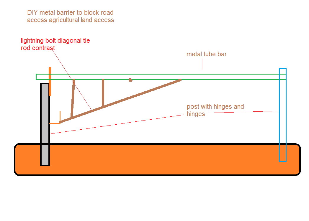

gate or mobile barrier to block access to private road agricultural land.
hello we will have to block the entrance of an agricultural land either with a metal gate or with a revolving barrier. currently the entrance is blocked by two vertical poles and a metal rope. any suggestions maybe using recycled materials iron for concrete reinforcements or metal pipes for scaffolding thanks. measurements are road width 4 meters I have to make the pillars floor stand hinges and the latch thanks. any creative economic idea?'

Similar to your drawing, make gate triangle with smaller triangles in middle for support. Make sure to dig big hole and use concrete to fill the hinge pole. Bigs forces will be trying to tilt pole when gate swings. Use pipe for gate as concrete reinforcement is not rigid for its weight

Just purchase a couple tube gates, set the stantions and lock them together and hope the tresspassers will be discouraged.

Only suggestion I would make is a buried anchor with an adjustable stay (turnbuckle) on the back side of the gate hinge to adjust/prevent for sag. Years ago I mounted an 8'± wide gate similar design to yours. It was anchored to a vertical piece of 8" I beam buried 8' or so and it still sagged. I was lucky that on the back side of the hinge we had placed some multi ton boulders to stop people going around so I just drilled the rocks and used a chain and turnbuckle.
Why such a heavy beam you ask, I worked for local DOT and it was a recycled bridge support beam and we happened to have an excavator handy so figured what the heck dig it deep and it won't sag....wrong LOL.

Pre made tube gates don't sag as they aren't that heavy to begin with. I own and operate a machine and fab shop and I'd never fabricate ANY gate simply because the pre made ones are so much cheaper, much lighter and at some poibt your tresspassers will destroy your handiwork anyway. Why bother. Just purchase a couple gates, a chain and padlock and a couple .40 retention posts and be done with it. Pre made gates always come with the hinge points included as well. Have other things to do that fabricate up gates, I have the steel on hand but prefer not to.
