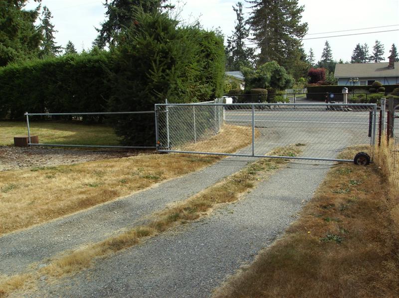

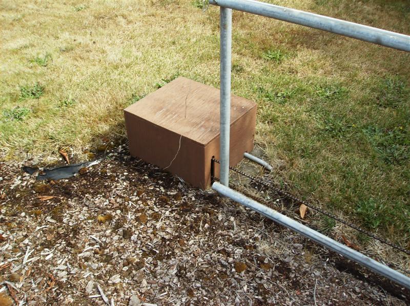

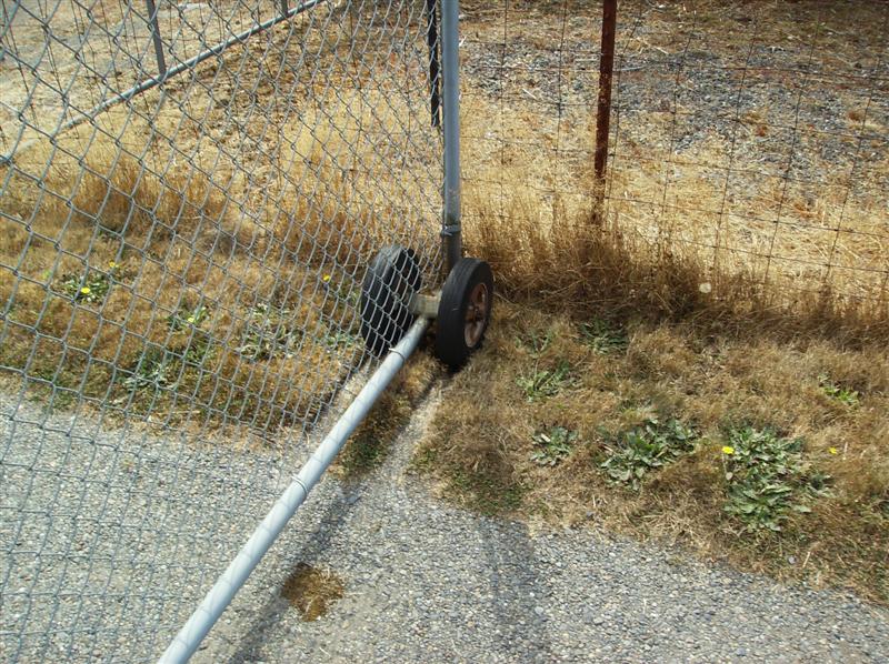

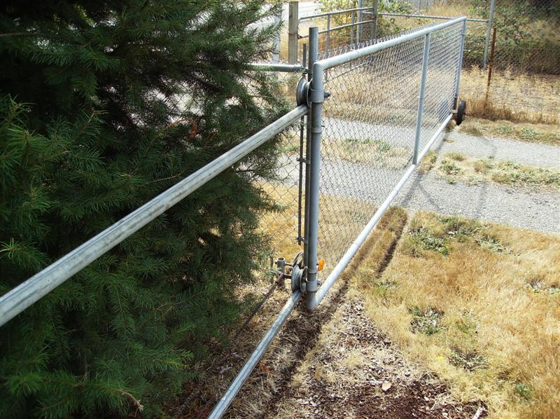

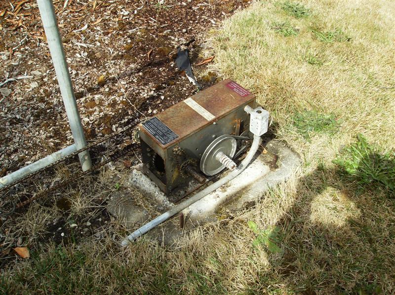

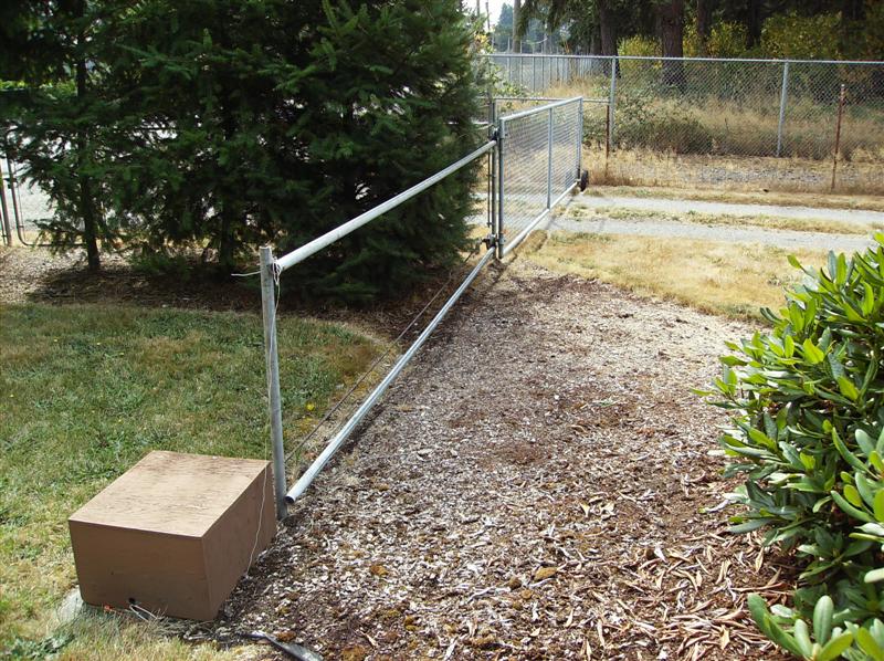

how about some pictures?
The swinger was replaced with the current slider/roller. The guts for the old swinger setup is in a pile behind the garage, I could drag it out and snap a few.
The roller that's in use now ain't much to look at. Just a painted wooded box with roller chain coming in/out and a commercial door opener inside.

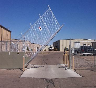

What about a gate the swings upward? It could pivot at the bottom and rotate 90 to a vertical position. The mechanics of it might be easier and less moving parts than some other designs. I've seen gates that operate in this manner but have not seen how the linkage works up close.
   / Gate opener #14
A cheap winch could be used to tip up that type of gate.

Like said, nothing much.
   / Gate opener #17
but the problem I've seen with these is keeping the track clean unless you live in town.
Neighbor across the street has a asphalt driveway and uses a piece of steel angle laid out in an upside down 'V' with track wheels to fit.
Has no problem keeping it clean.
