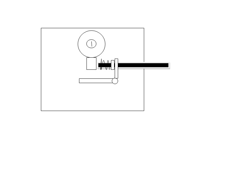

OK so a little background. We like many of you, live rural, and have a gate at the entrance to our property. Our entrance is off a dirt road, and ever since we have lived here there was a coded gate at the entrance to the dirt road. Lately someone has broken that gate, forced their way through it, but that is another story. The residents are considering removal of the dirt road gate.
We have begun closing our gate all the time because some less than desirable people have made their way down the road. Which brings me to my question. Our gate is a swinging metal gate, and like any gate I realize is only a deterrent for a thief. Our steel gate currently closes to a wood post, but I would clad that with steel. I am looking for an exterior lock, preferably one with a coded entry right on the lock (think hotel doors). I have seen some on the internet, but they are in the UK.
It would need to be operated (locked and unlocked) from either side as well, and would need probably 2" throw to lock securely to the post.
I have thought up an idea that could be padlocked from either side, but would prefer not to have to fart with another key. My idea would push a 1" bolt through my gate and into the steel clad post.
Before you ask, we have thought of a powered gate opener but like the dirt road gate those can be easily opened by pushing with a car/truck. Our dirt road gate did NOT have any locking bolt mechanism, it was simply a swinging gate that stopped against a post. This is a HEAVY steel gate, that swings on steel posts that are 12" dia, cemented into the ground. Not a lightweight setup. Also in case of a power outage, I still want to be able to get in or out.
My gate is nowhere near that heavy, and can be broken, but I still want the deterrent.
So, any suggestions on the lock?

Last night I was rummaging through my mind (LOTS of empty space there) and drew up this little idea.
The horizontal bar is a handle, one on each side, and the black bar is the locking bar. The handle will rotate downward and pull the spring loaded bar back. The round part at top left is a keyed double sided deadbolt that when locked will prevent the black bar from sliding back.
I think I can build this.
As you can tell I do not use Autocad or even anything remotely close (Word). Most of my ideas start like this and I build them from drawings in my head.:eek:

What happens if your not home and the fire trucks need to get thru the gate ?
