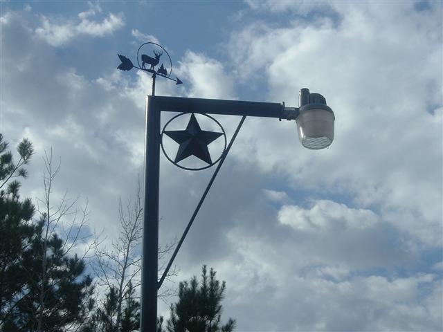

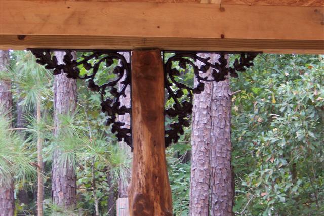

TNhobbyfarmer said:
I'm curious what you mean by metal brackets at the corners. I'm open to all suggestions as to how to attractively complete the entrance.
I'm BIG fan of of wood, metal and rock combined together. When done right, there's nothing that can compare.
I don't really have any thoughts as to what I'd actualy use, but have a dozen or so ideas running around in my head that I've considered for my own application. If and when I ever do it, I'll have to make a decision, but until them, I'm always looking for ideas.
King Architectural Metals wrought iron metal balusters finials casting steel ornamental forged gate fence stairs Access control is about the best source of corner brackets and metal items to create something truly unique. It's all up to you, what you like, and your imagination. Tying your posts together with your cross beam with an original design that you come up is what I find to be allot of fun.
Here are two pictures of what I've done. The light is on my driveway and something that I made. The second picture is of my gazebo with the brackets that I bought from King Metals.
Eddie

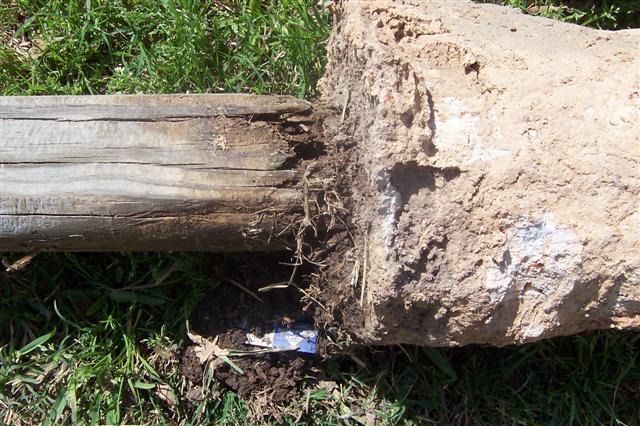

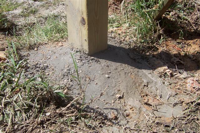

I don't have any first hand experience on how long Cedar will last in the ground. I know that diferent species of cedar do better then others. Soil and weather conditions also make a difference. It's really a local situation that you might just have to take a wait and see aproach. If it starts to rot or move on you, then you can always drill another hole or two on either side of them, fill with concrete and some channel iron that you can bolt to the sides of the posts.
It's an easy enough fix that you don't have to deal with right away, and maybe never.
One good way to help a post last as long as possible is to get the water away from it as fast as possible. I'm a contractor, remodeler and a handy man. I do a little of everything including fence repair. Posts almost always rot out at ground level. I've read all the stuff about putting rock at the bottom and doing this and that to keep the end grain off the ground, but I've never seen a post rot out at the end. It is always at ground level as you can see in my first picture.
The only way that I've seen to make a post last is to build a crown up around the post to shed the water and keep it above standing water. I do this with dirt and/or concrete. I also do this with wood and metal posts. It's cheap, simple and just good practice.
Eddie
