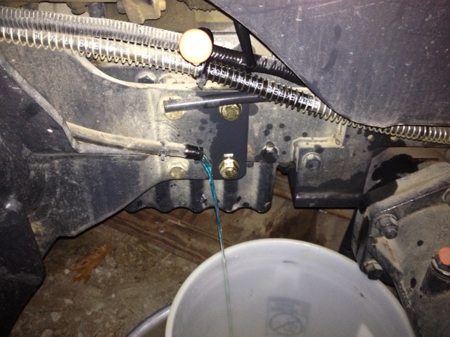

Give your twelve year old son a pat on the back for knowing the difference between gasoline and diesel, which by the way his old man doesn't know. :laughing:You can smell the difference!
   / Gasoline in diesel tank
#12
   / Gasoline in diesel tank #13
Now the biggest question is, what are you going to do with the contaminated fuel?

Be sure to use a pump or siphon to remove the last bit of fuel from the bottom of the tank. Not all will drain off from the fitting. I had water get in my fuel and drained as you did, but kept getting water in filter. After checking I noticed the tank fitting set just above the bottom, leaving about 3/8 inch of fuel when empty.
Hope this helps
