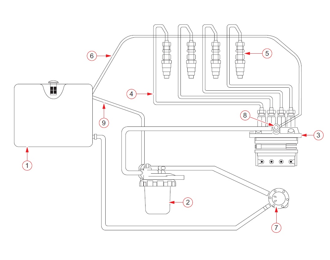

Hello.
I have a DK40SE and dumped 3 to 4 gallons of gas into the less than 1/4 full tank last night. And in case anyone is wondering, yes, my 12 YO son is having a ball with this.
Any words of wisdom or advice on how to get back to where its safe to crank the tractor? The tank is really hard to get to and the manual is a joke. I would rather not take the tractor apart but I don't see a tank drain any where.

Here is a diagram of the fuel system on a DKxxSE:
Item 7 in the picture is the lift or feed pump. It is a simple diaphragm pump that gravity-feeds from the fuel tank and provides a modest pressure to push fuel through the filter. It may be slow, but I'd try disconnecting the hose from the tank at this pump and see if it will gravity-drain.
Thanks to all for your replies, I got something out of each one.
Thanks for the diagram ritcheysvs. It is a great help and reminds me I need to get a manual.
I will try gravity draining this am and let you guys know how it went.
