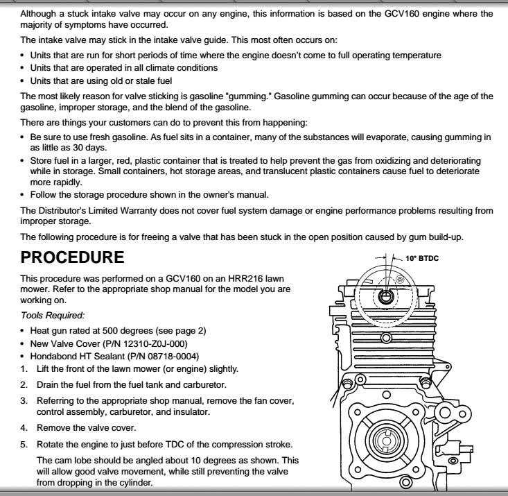

Just had Honda deny a warranty claim on a push mower with less than 25 hours on it. Seized an exhaust valve due to "owner negligence". Even though all the equipment gets fueled with 93 which is supposed to have minimal ethanol in it. They claim that even in the middle of the season if the machine is gong to sit for more than a few weeks, you have to run it dry. Cylinder heads are cast as one piece with the block, so are not serviceable. $600 piece of scrap now. Total BS.
You mentioned an exhaust valve stuck, this procedure is for intake gumming. Interesting they recommend using heat.
I know this issue is is not really for those who know whats inside an engine but for those who do, I had EXACTLY that problem on an EU2000i, from using an old steel gas can that had "varnish" in it. It was so obvious (after the fact ) I could smell varnish strongly in the Honda tank. Pretty sure the fresh gas absorbed varnish from the old can, and then "got in" my Honda.
I used carb cleaner to unstick the valve by spraying it into the intake stem (above and below) and working the valve spring up and down. It was almost instant success, within about 10 or 20 pressings of the valve it was completely free. I did not remove the valve spring, just worked the (surprisingly soft ! ) spring with a prybar. I don't know if carb cleaner is the wrong thing to use and was careful to avoid getting it on any rubber. As don't recall rubber seals on the valve stems. I had this notion that I needed to unstuck the piston rings too, so actually let it sit in the cylinder. The generator was only a couple months old at the time. Its been several years, the engine runs perfect.
The Honda EU2000i engine has very soft valve springs (I think) because the camshaft is composite (looks like black plastic). The engine is pretty low RPM and constant. Not sure if your mower has a similar constructuion but thei is what I found inside my (under warranty) generator. In any case nobody ought to debate whether an EU2000i engine goes the distance with a plastic camshaft. But I think the soft valve springs make it more vulnerable to varnish. Honda sells these worldwide, I'm certain they've experienced every type of warranty problem imaginable (including mine).
In any case as I wrote before if everybody is dumping gas on the ground after 30 days that's a bunch of hooey but it does CYA for Honda. Here's Honda Job Aid PJA55119
