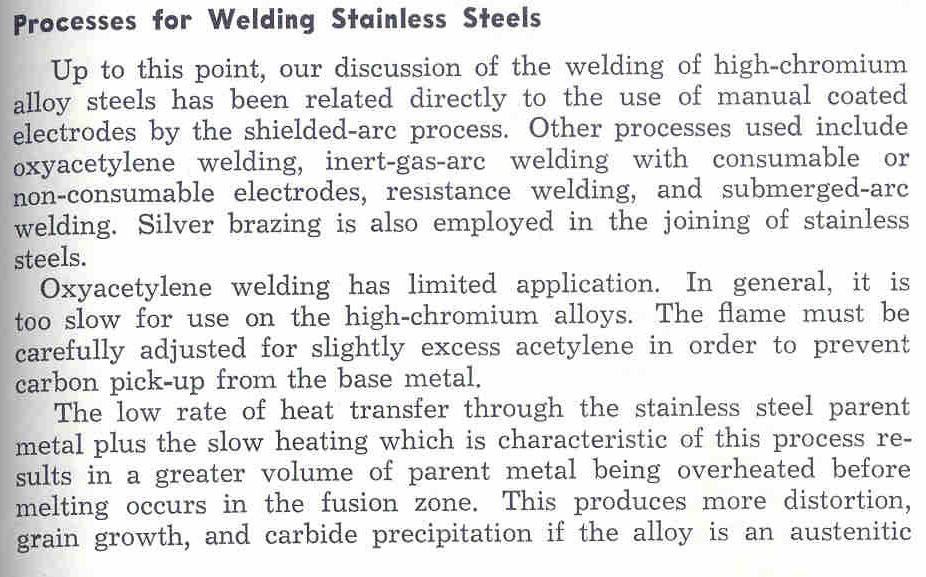

Is there anything other than brazing that can be done to join these two dissimilar metals? It's a gas only proposition.

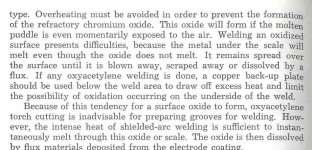

I found a little, (very little) bit about welding stainless steel with O/A in one of my old books.
Tig, and SMAW are probably the two cheapest processes to get going. Mig would mean a tri-mix gas which most people don't have on hand.
