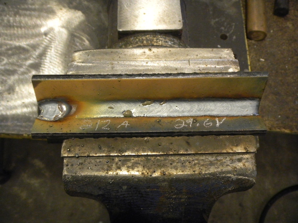

I did little searching on TBN, but did not see much about welding gasses for MIG.
I have done a little amount of wire welding(enough to be considered dangerous):) but I am used to stick welding. I have just purchased a wire welder.(after years of wanting to get one, or a TIG:D) I was wondering if there are many negatives to using m2 gas for my steel welding(and also stainless). The main reason is: the company I work for keeps this around(and also a buddie who lives very close) so if I need an exchange even on Sundays I can just go get one of theirs and pay to have them refill mine during the week while I am working wherever I am during that week(construction life:mad:). I have also noticed it lays a much cleaner bead(but it sounds a lot different than I am used to. How is the penetration diff is the weld any stronger/weaker? So what are the negatives? If any. And so on...
Thanks to all for any info
Eric

Have any of yall used m2 before to know what I mean by sounds different:confused:
It dont sound like the bacon cooking like im used to.
More like a hiss instead

90% argon 10% c02
linweld is the main supplier

Oh I see, never heard it called that before. Strange I just started playing with that mix.:laughing:
what is it called where you buy it?
   / Gas type m2 #9
   / Gas type m2 #10
90/10:laughing:
