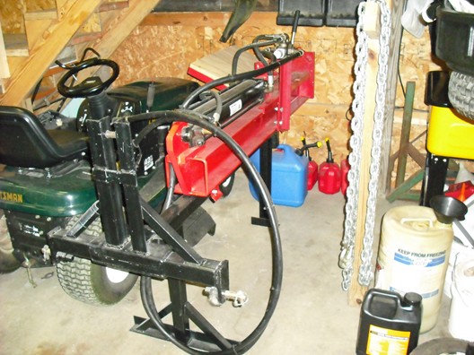

This is a no win fight. I personally made my own 3 point splitter that goes horizontal and vertical. Hours are nothing. I maybe use it 10 hours tops in one year. Big deal, its a tractor. Even if used at this rate for the next 25 years 250 hours is nothing on a tractor..
Chris
