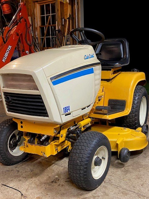

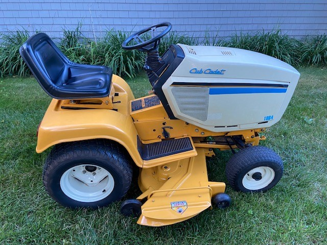

I was referring to the earlier Cub Cadets from the 90's to early 2000 with the Sunstrand hydro's - for example I found this 1864 this summer with 185 hours and had the deck blasted and epoxy painted. Then went thru it changed the valve covers, engine and hydro oil and now its ready for a new home.
