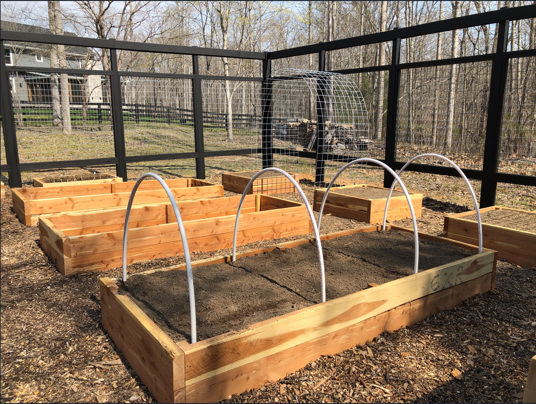

I was not informed ahead of time that'd I'd have to build accessories for the garden. Had to figure out a way to support netting to protect broccoli and the like from cabbage worms(?) -- see attached rebar + 1/2" sched40 pvc -- and apparently I need to build something to support tomato plants.

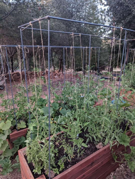

For tomatoes I built a frame from #3 rebar - about 6 1/2' tall legs (3 legs per 20' piece) - I think the frame is the next size up rebar (#4):
I like using rebar in the garden because it pretty much disappears when you take a few steps back, plus it's cheap and easy to get.

Instead, to get tomatoes to go up and for max production, you trim some of the lower branches, and you tie or tape or velcro them to the support - which can be as simple as a bit of twine hanging from above. That's why we set up those rebar things, so there's something up there that you can hang lots of twine down.

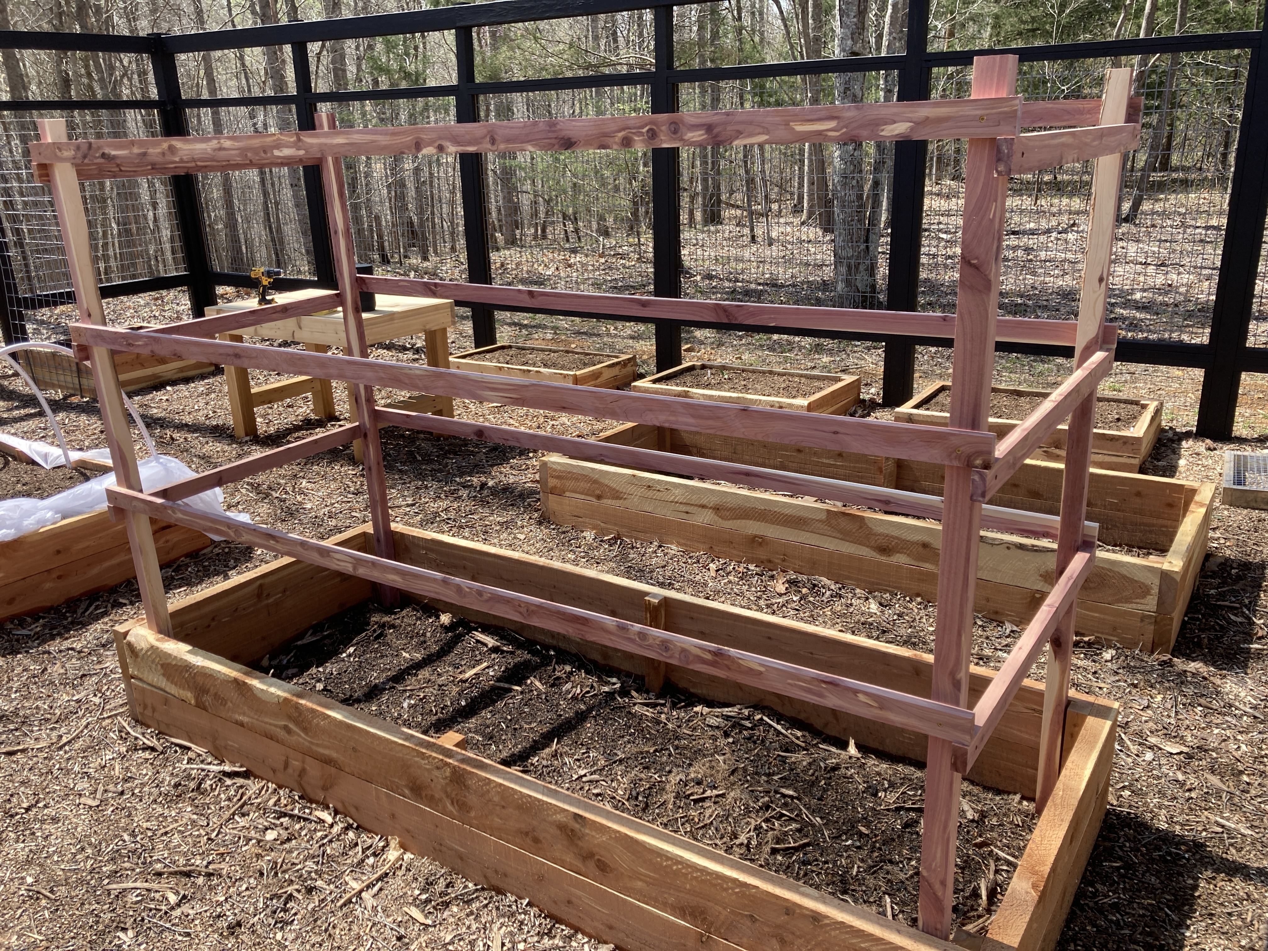

I don't understand all the details with tomatoes, but I believe our desire it to avoid having to tie the plants to anything. We'll see how the whole-bed tomato cage thing works out. I spent yesterday cutting down 2x6s into 2x2s and 1x2s. Will start screwing it together today, though I realized last night that at its finished width(38") it won't fit through the garden door, so I guess I'll be assembling on-site.

I need to buy more 1x2s tomorrow to finish it, but here's the wood 'matrix' idea I'm going with for our one tomato bed:
It's a 3x8 bed and we'll do one plant every square foot. So I'll run two more 1x2s the length of each level to split it into three on the long end, then staple 1x1s running perpindicular every 12" in the other direction.
The total height is 66" above the dirt, with each 'level' spaced 18" apart.
A complicated solution, but blends well with the beds themselves and gets a lot of scrap lumber out of my shop which I'm happy about!
