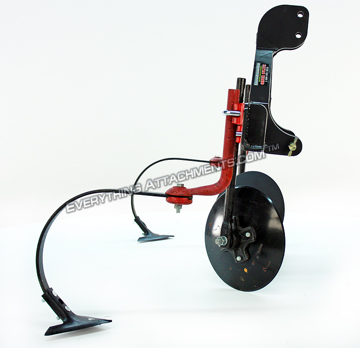

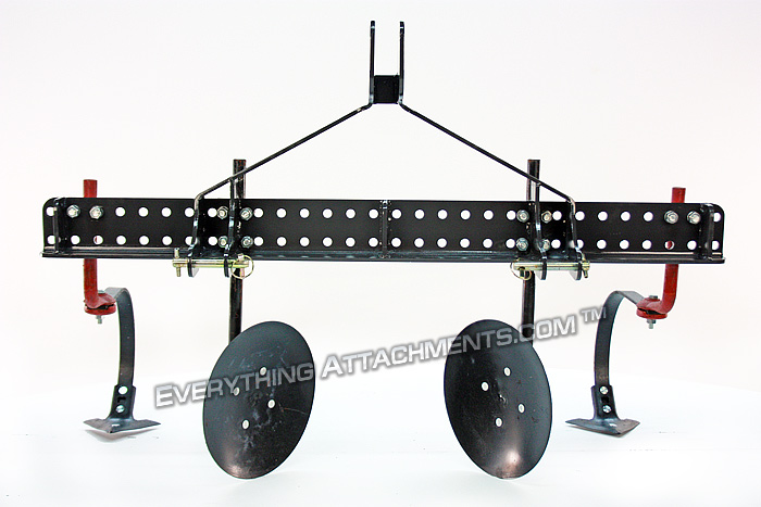

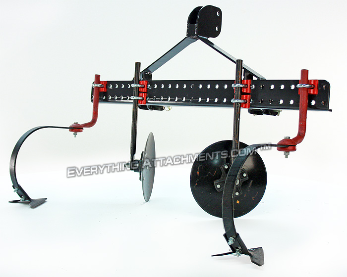

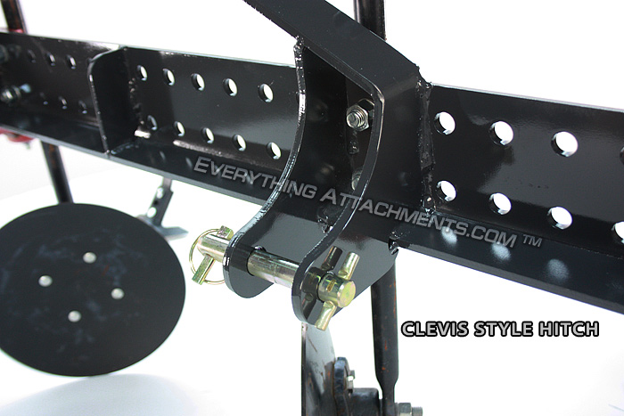

Ok, just got the pictures of the prototype of our first implement manufactured in house. . . the GB-60 Garden Bedder. Let me know what you think of the design. These will ship in two packages via UPS to your front door for the most convenience.
A couple of features are the rounded corners on everything to keep you from getting cut up or ripping your jeans as well as the stronger clevis style hitch and Quick Hitch Compatibility to Speeco or John Deere Imatch hitches. Plenty of Width Adjustment options, and two knuckles securing the bedder discs from flaring out providing a rigid raised garden bedding system.
The prototype is two tone "Kubota Chassis Grey" on the frame and red knuckles and sweeps. Final version will be the industrial yellow that won the TBN color discussion.
Ok, let me have it, what do you think?

Is using the drilled plate much cheaper that diamond bar or tube? Bar/tube makes adjustments much easier as you just need to loosen the bolts and tap it over, verus taking the U-bolts completely out etc.
/ Garden Bedder Prototype
This whole piece is cut out of high quality plate steel and holes are punched out. Then bent or broke in a press break making this a more expensive to build, but an improved design that will last. When you tighten the Ubolts, you get a firm grip from letting the bedder discs turn or twist. The style you spoke about on the Leinbach GB-48, if you happen to overtighten the set screw, it can pull the nut off the welded tube.
Either way, it is 4 nuts to loosen and remove to change bed width. To change the angle you simply loosen the bolts and turn then tighten. The one you are looking at is the Everything Attachments GB-60, and the comparison unit would be the Leinbach FB-60 which uses the same Ubolts, but our implement has two rows instead of one to make the stem and bedder disc rigid.

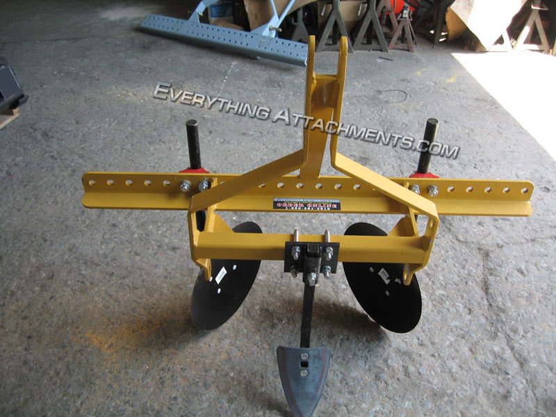

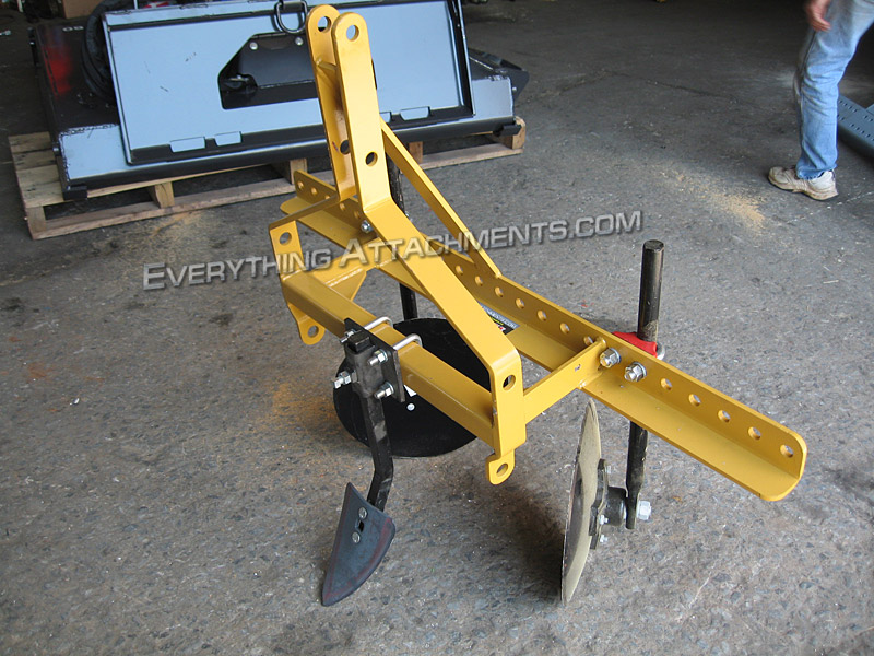

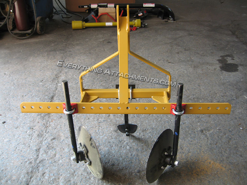

Attached is the GB-50 prototype (shown with optional furrowing attachment that is really close to completion. It is quick hitch compatible as well, has narrow and wide pins, and uses one knuckle instead of two so that would take some work out of it for you.:thumbsup:

I like the looks of them. I think most users would play a little with the bed width but once they find the perfect size they would leave it set there. You could offer extra knuckles as an option if someone made multiple bed widths, so they could loosen and move the hiller from one knuckle to another easily. I don't think that is a big deal though.
Good Idea about the extra knuckles. . .
/ Garden Bedder Prototype #6
Actually I was just thinking of a regular 'toolbar' with clamps etc. so you can mount up what you want.
What about an optional knock down/roller bar to level behind the hippers? I have to go back over my beds with a rake to smooth the edges.

Nice basic design. I built something similar using an old cultivator, which had a d-frame rather than a single bar. I mounted the discs on the stems (aka stem cranks) that held the springs and sweeps. Works well. From that experience, I have four suggestions. Firstly, the two sweeps are probably unnecessary. A cultivator is a separate beast. Secondly, provide a single stem and spring with a chisel or small planting wheel rather than a wide sweep to mount centrally as a furrower. Thirdly, an optional roller or drag to level the hill as Charlz suggested, with the furrower following it. Finally, an optional tiller mount for some popular tiller brands, such as King Kutter, would make for a one-pass system. One imaginative TBN poster came up with a similar arrangement. See this thread:

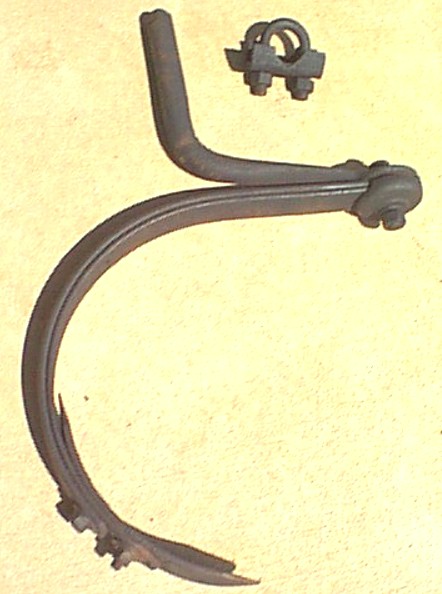

I am looking to replace some U-bolts on a cultivator of mine and I am having trouble locating the correct size. The size used on these bedders, assuming the shank rod diameter is 1 1/4", look to be the correct size. Any leads would be appreciated. Thanks.

We have new 1 1/4" kits for $15 or Used for $7.50 each. Also have lots of the used crook shanks that fit into these receivers and also plenty the used curved C tines (most with points attached). $25 each for 1 complete used assembly including clamp + shipping. Ken Sweet

We have several of the good used C-shanks with clamp and a used point for $25 each or 5 for $100 + shipping. Ken Sweet
