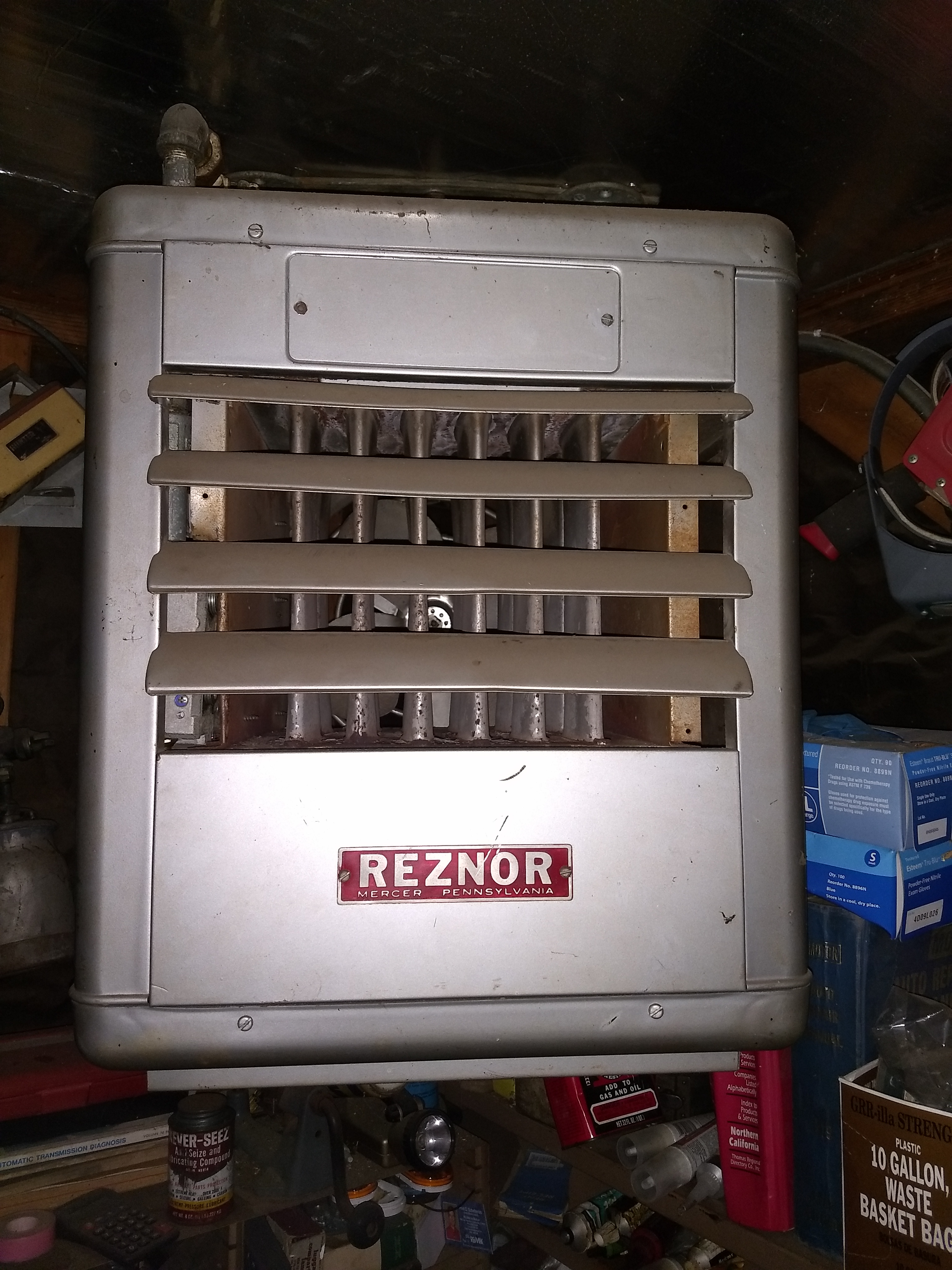

I have a Reznor unit . Possibly 6500 BTU and they go for about $1000 around here plus install. Just another idea on how to hook them up . I have the thermostat just inside the main entrance door and a lighted when on, off/on wall switch beside it and when I leave it's easy to turn off if needed. I also have a small 'bullet' type LED light mounted on the outside of my shop that I can see from my house that is on when the furnace is so it's an instant reminder that the furnace is on or off. To hook this up I just installed a receptacle on the wall and powered it so that it is on when the furnace is on. Then I just used a plug in charger from a rechargeable tool and powered the LED light with a low voltage . I also have Google Home and since I'm somewhat lazy, I bought a compatible receptacle/ switch for the furnace and now I can turn my furnace on /off from my house or anywhere there is WiFI with my phone. Hope this makes sense. I also have a another building that I can't see from my house and sometimes leave the door open by mistake. I have a contact switch on the door and it powers another LED light that I can see from my house as well. I know you can buy a unit from the hardware store that does the same thing but the LED light is much brighter.
al
Some good ideas, thanks. I plan to mount the heater in the far corner and the thermostat in the opposite corner near the door. A switch and an 'on' indicator light will be added to the plan!
