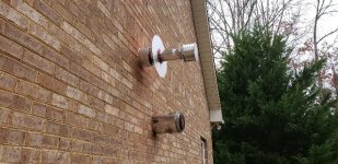

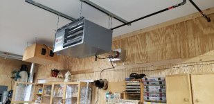

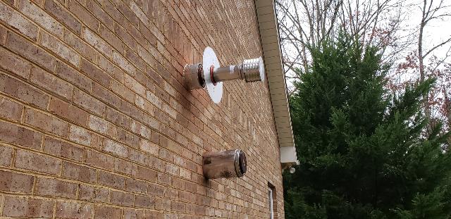

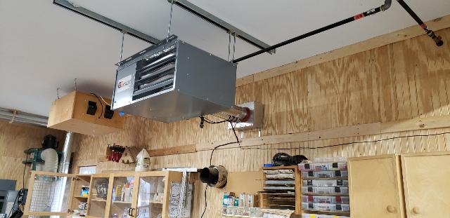

I went with a Sterling GG45 and horizontal sealed combustion. About $1k self-installed less the Natural Gas line.
Do check local codes and use the exact venting required by your heater vendor. Rules keep getting stricter. My venting was almost as much as the heater.
Do get help lifting the unit into place. Don't be like me and lift it with 4 $0.25 garage sale pulleys and some clothes line. :)
   / Garage/Shop Heater Installs?
#26
Thanks for posting and the pics. Quite a bit less cost than the Reznor 45 sealed if you did it for $1K.
