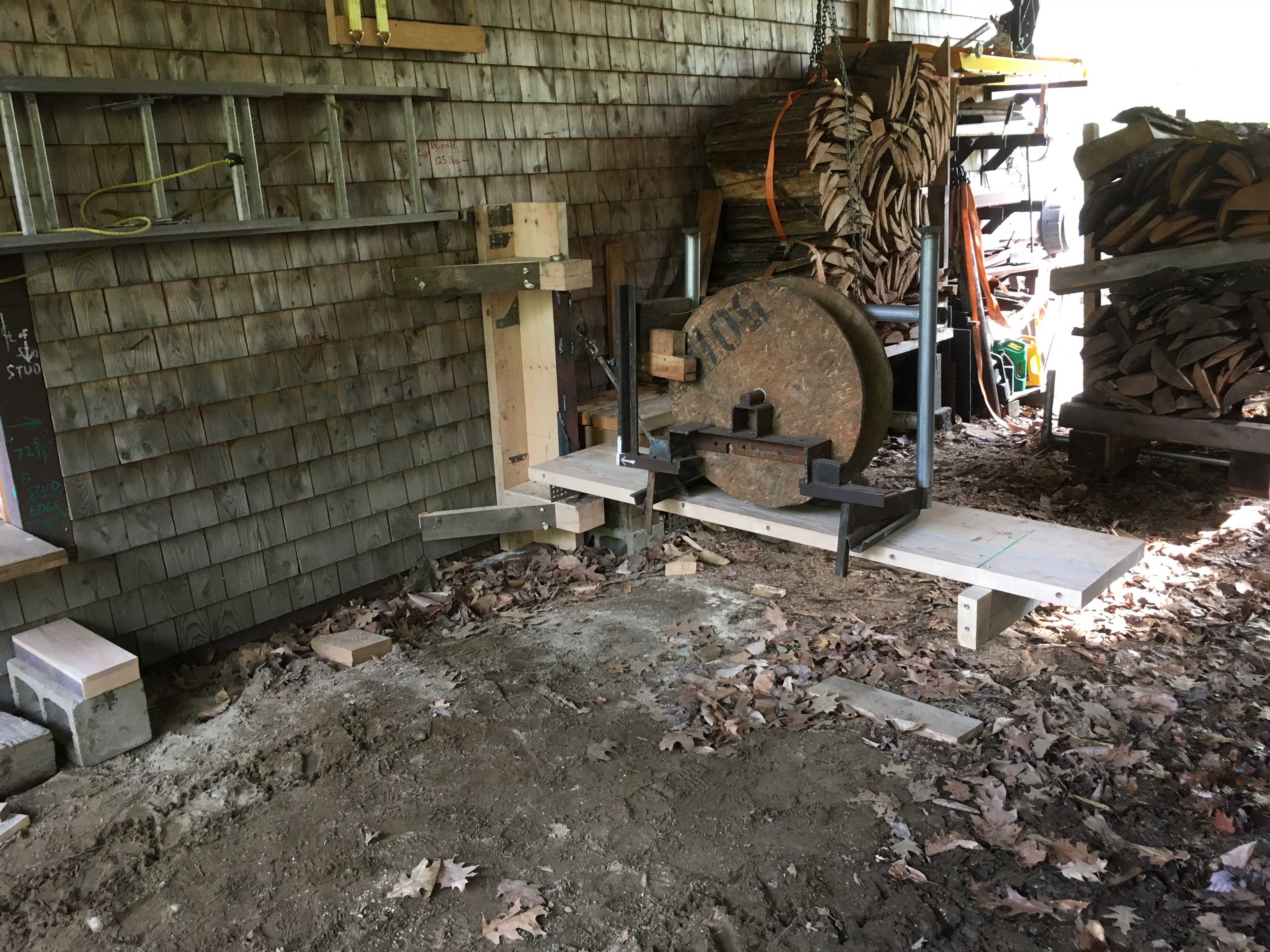

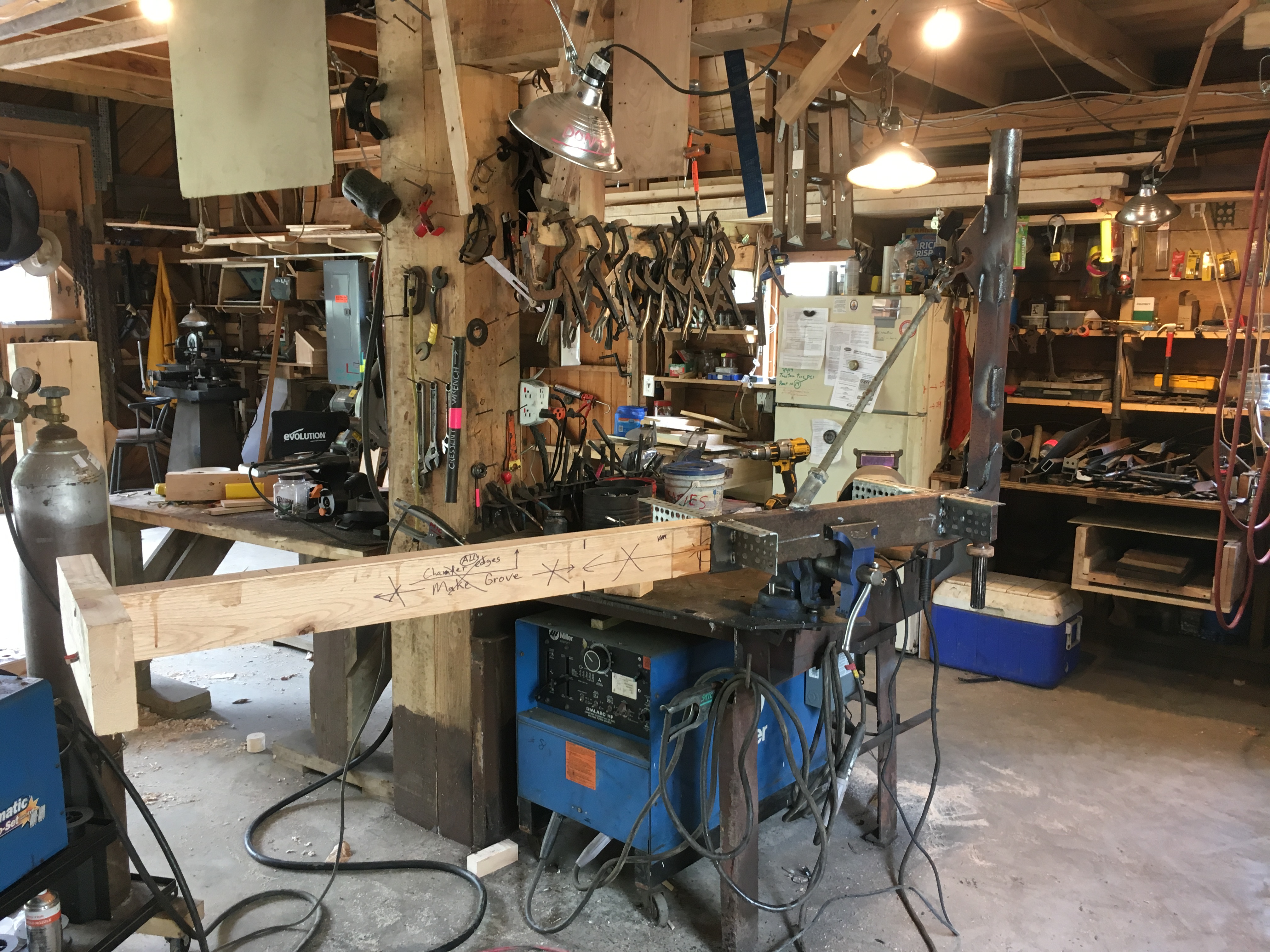

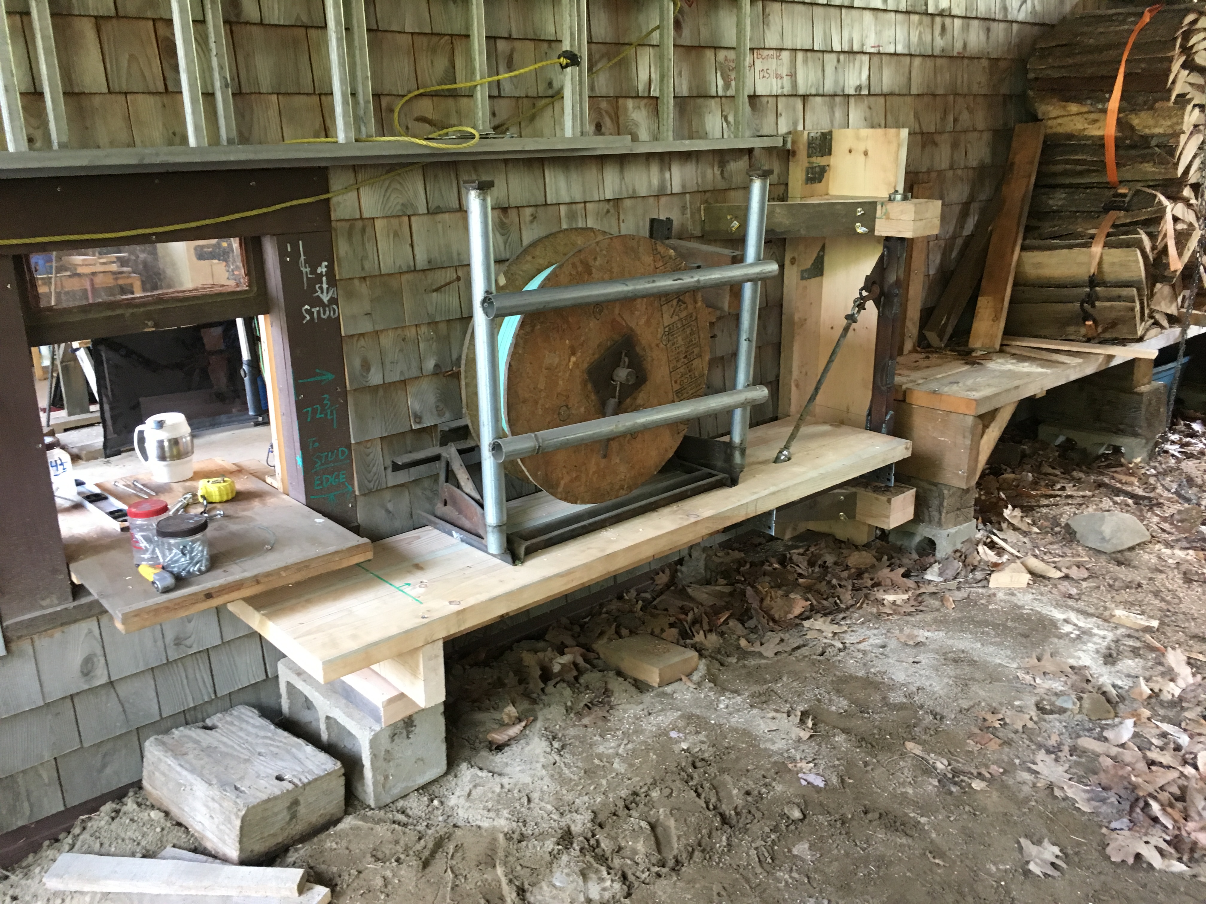

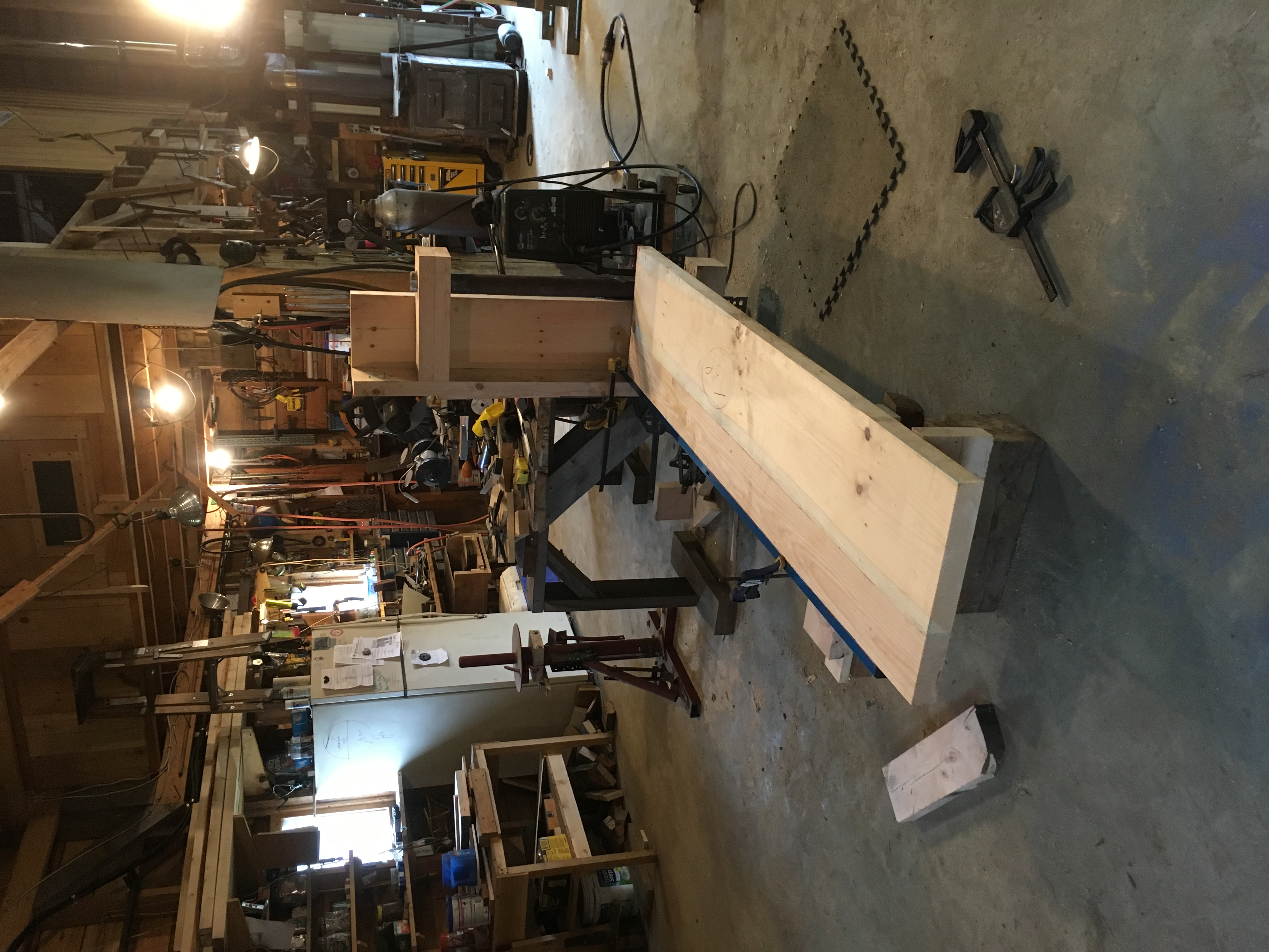

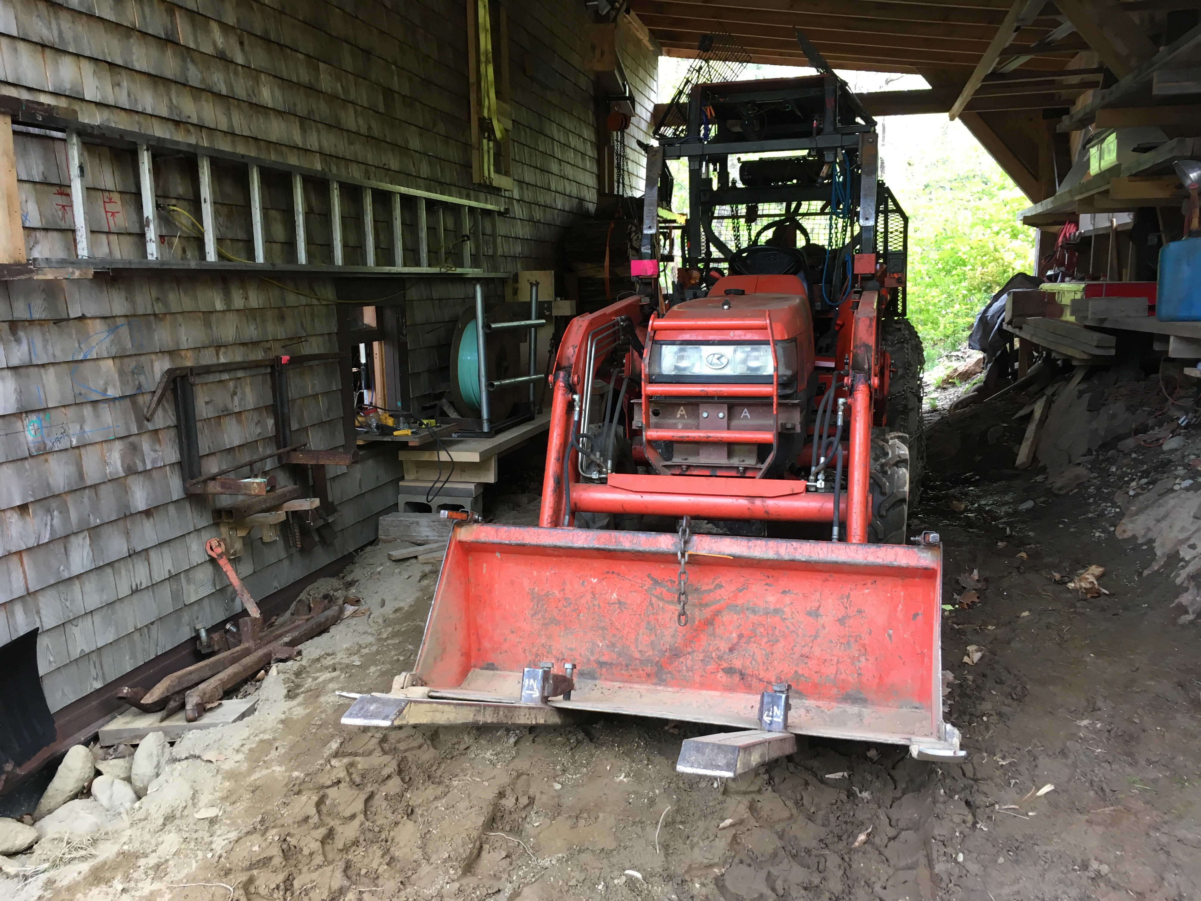

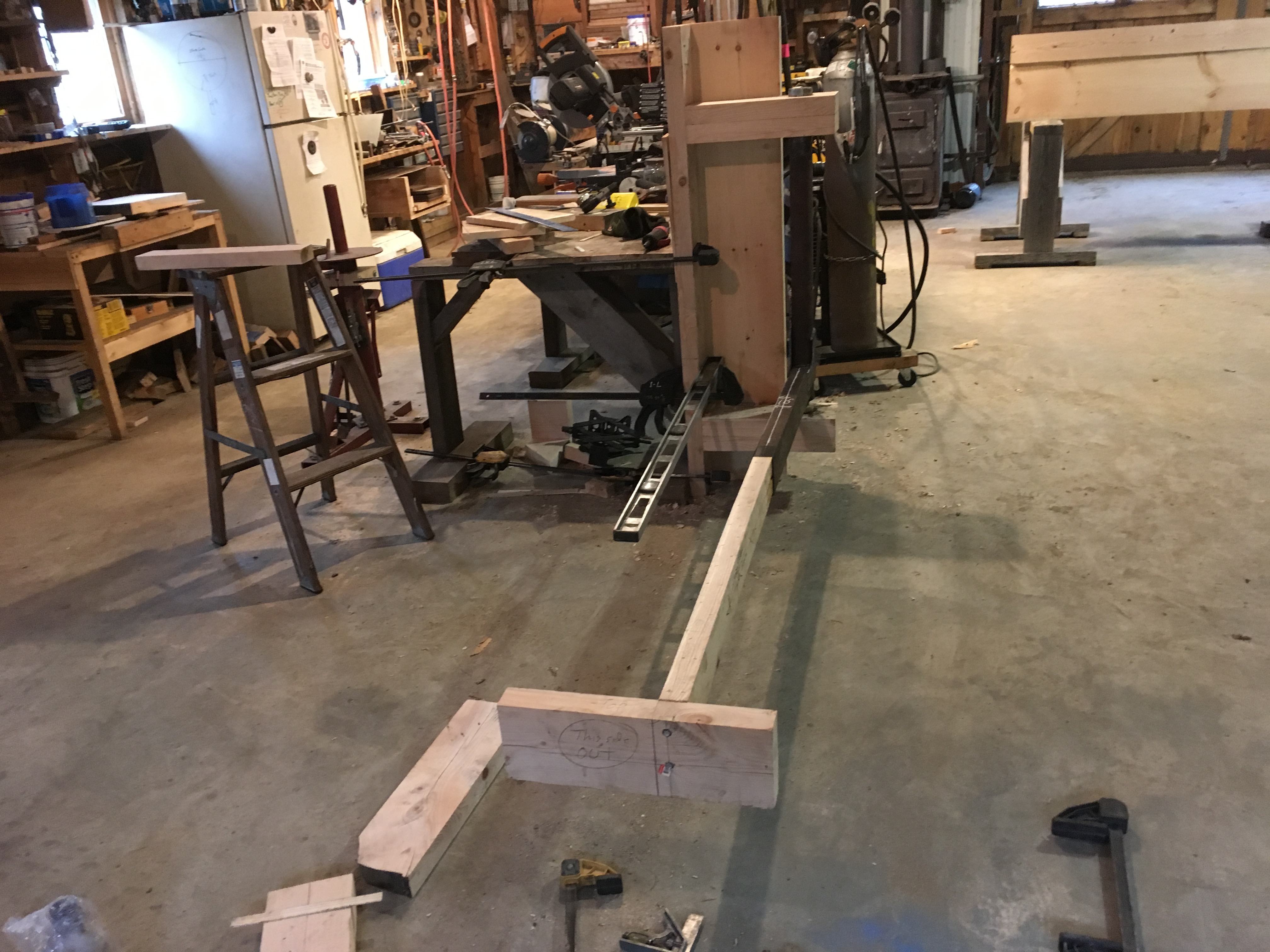

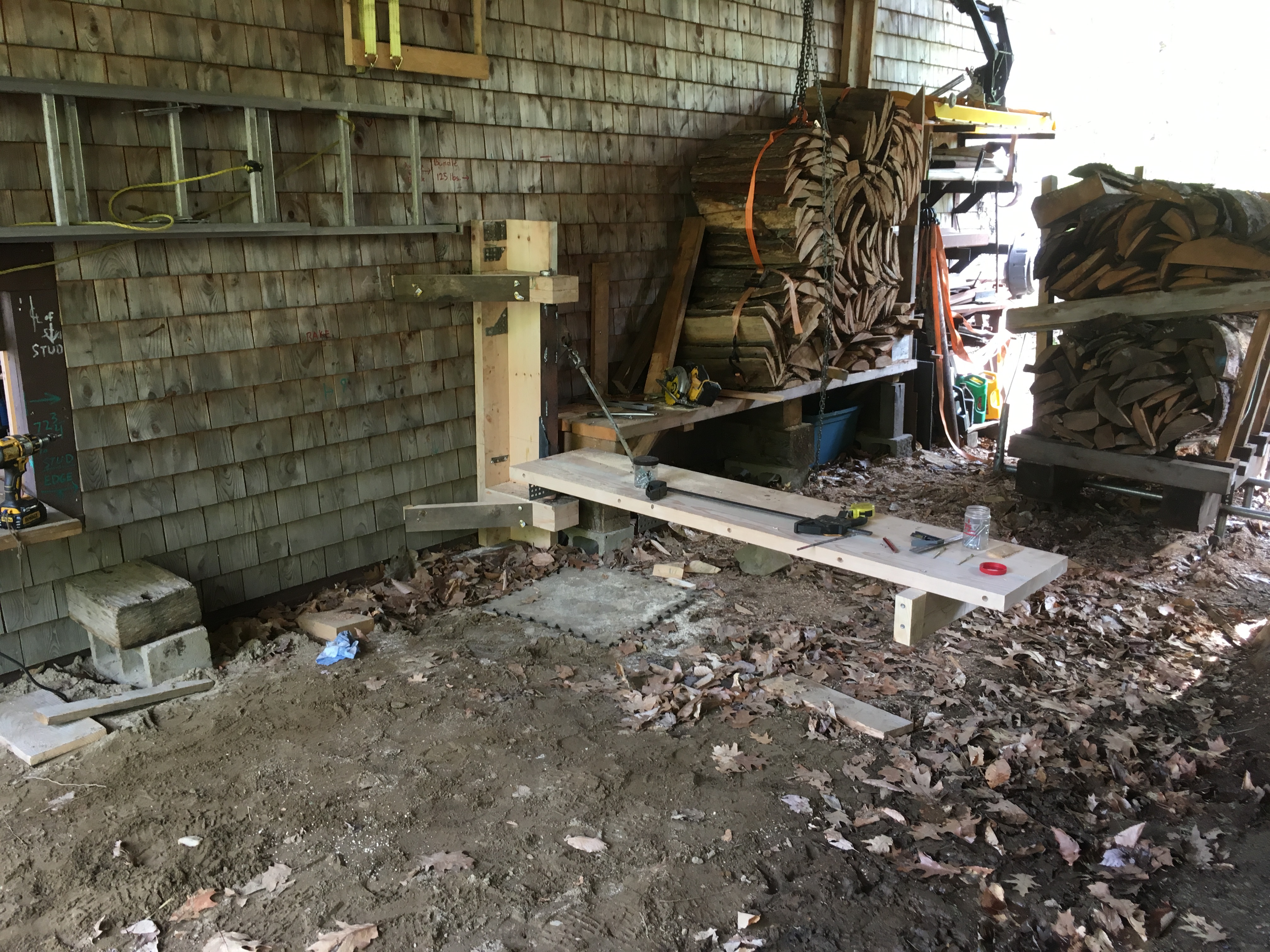

Since my garage rebuild back 6 years ago I made a lot of shelves or a lot of shelf's but this was my first swing out shelf. I ran out of floor space as soon as I built my garage so to help over come this technical difficulty and make a shelf thats easy to get to, unload/load on my strapping holder for sawmill slabs, heres the answer I came up with.

All done, behind schedule and under budget........... I figured it took around 24 hr, but some of that was due to thinking and looking for what might work, but there was no do overs and that a diffident plus.

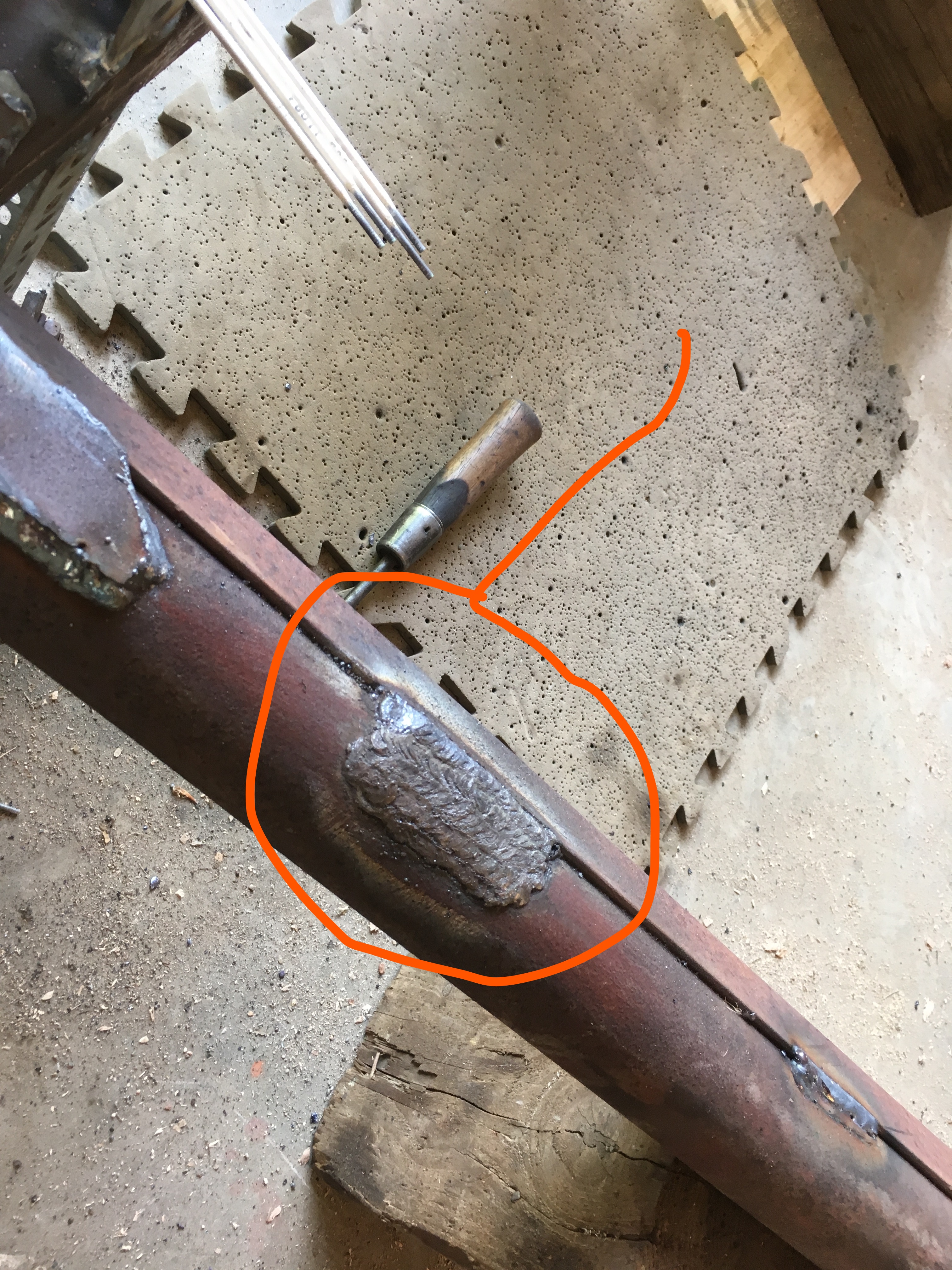

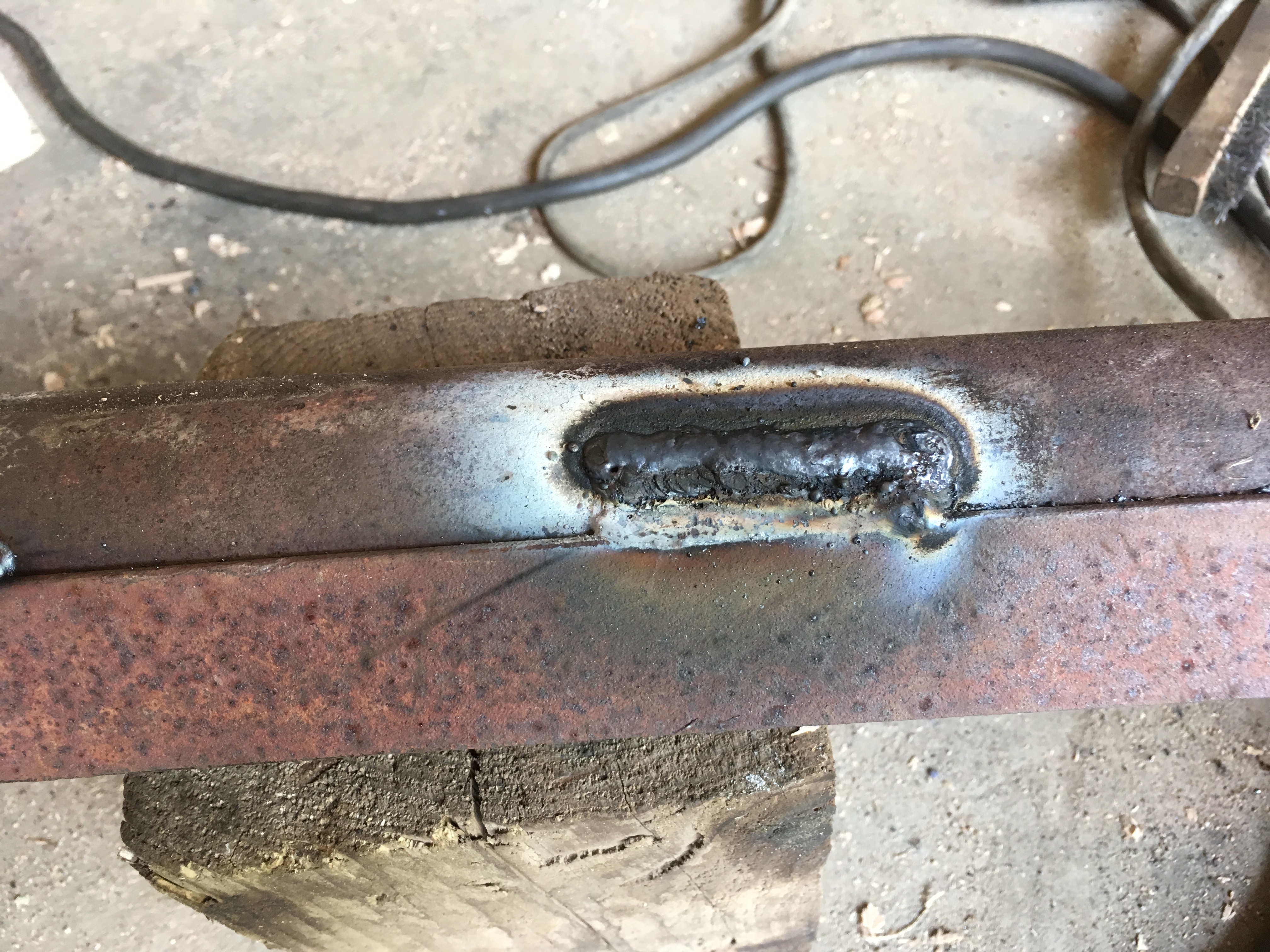

I did have a couple hick-ups welding on thin rusty drive shaft, I hate prep grinding so I ended up burning through, that's ok if it would stop getting porosity so after 10 minutes of that I grab some weld over anything 3/32 6011 and welded right over it. I tried DC-R, AC then DC-S, it seem like DC-R wanted to penetrate burn through, AC seem like the puddle wanted to spread out first before wanting to burn through, and DC-S seemed like not wanting to spread out the puddle and not wanting to burn through so easy. So I use that setting til I got something to weld to then I switched and covered with AC, I think 6011 spreads the puddle out better and it burnt out the porosity.

Oldpath05, I've got that exact welder (the Dialarc HF). Heckuva welder, especially since I got it on a barter deal, no cash involved.
   / Garage hacks, adjustments and annoyances.........
#20
I didn;t realize I had that in my photos, I got mine 2 years ago from Watervile area, the guy want 300, I offered him $400.00 if he delivered it, guess it's a so so deal for a late 80s machine but not as good as you. I wanted something with atleast 250 amps for carbon-arc gouging and didn't $2000.00 to buy a welder with and still dont. So far I went through 10 lbs of rods with it and it's a little more complicated setting the heat then my former Century 250 amp welder, the dial numbers are percentages not the actual amps
