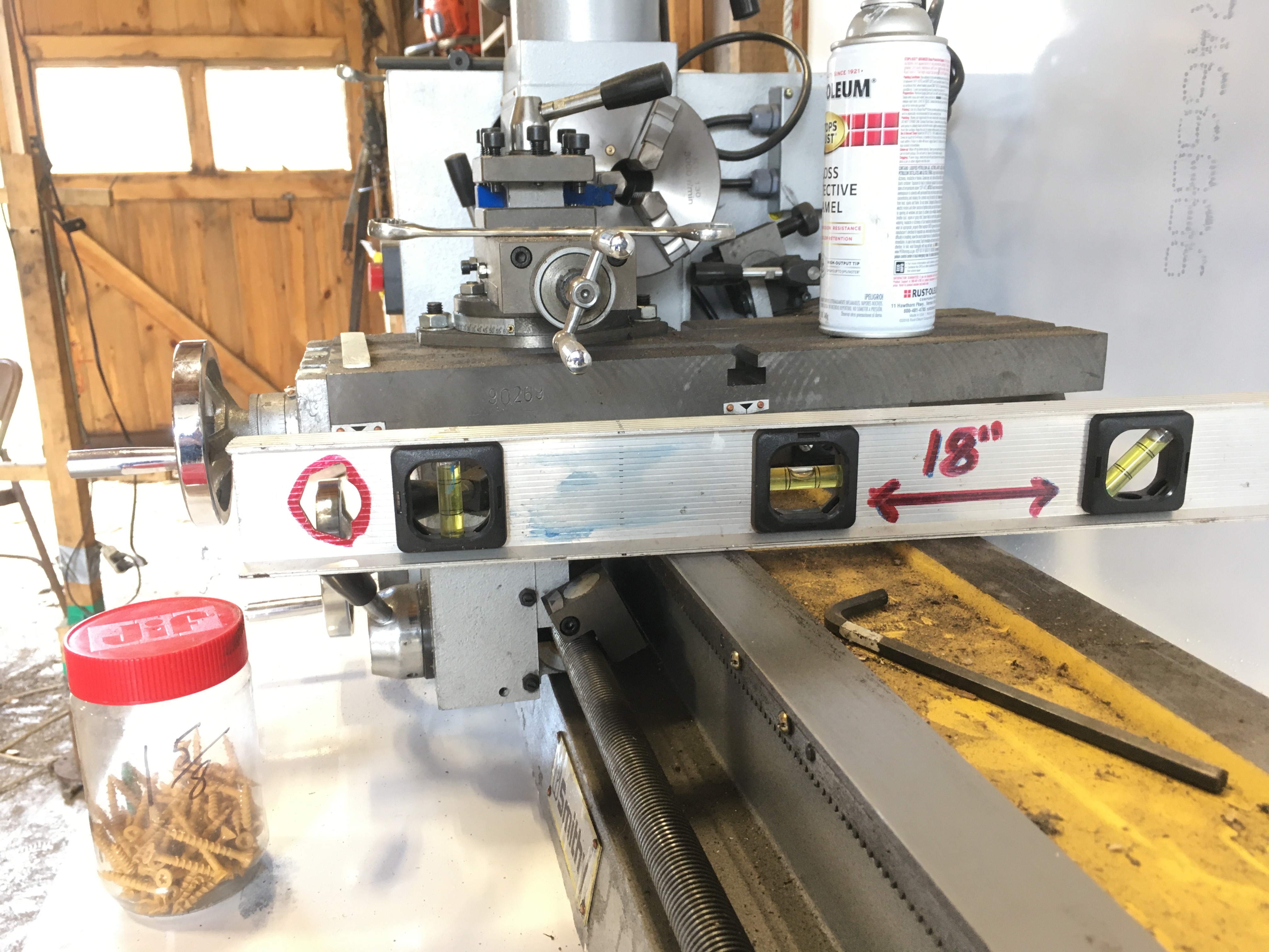

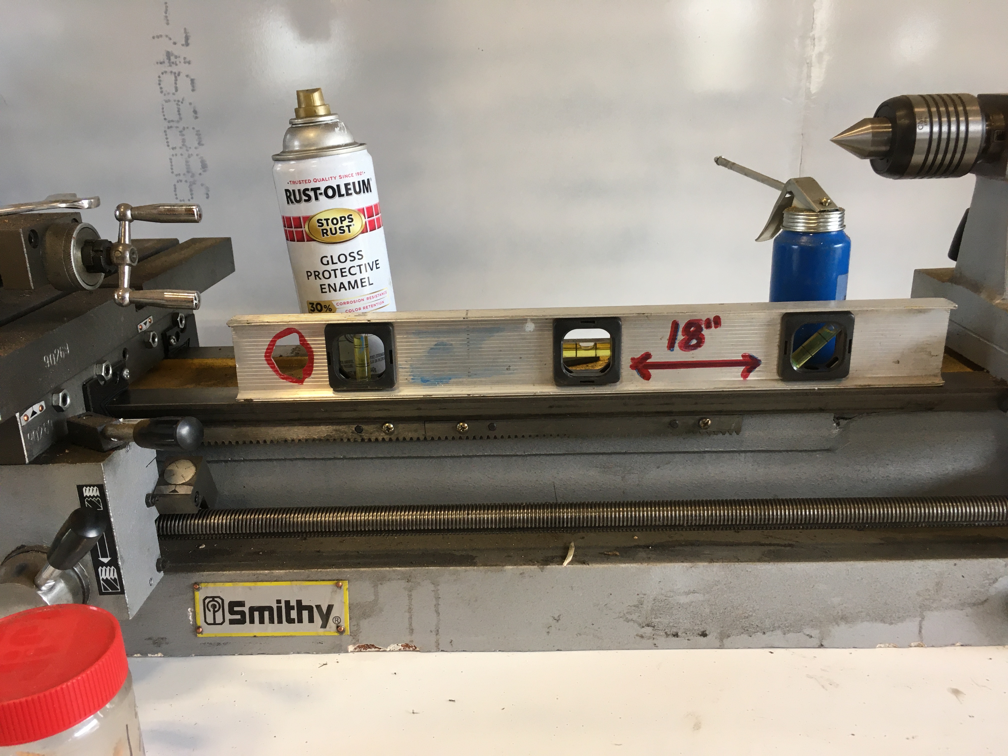

I'm usually a half bubble off but not this time.

I take it that's just for checking whether it's sitting level? Machine that small, probably there's no way to level the ways themselves.
   / Garage hacks, adjustments and annoyances......... #133
If table is in "set" position, you use shims under bolt down pads to perfectly level machine...
Dale
   / Garage hacks, adjustments and annoyances......... #134
My normal process for leveling and straightening a lathe is to level side to side at the head end first. Then level length wise without changing the head end. If the head end has to be changed to level length wise then relevel the head end afterwards. Once that is all done then straighten the tail end of the bed. Usually there are adjusting bolts to accomplish this but as in Oldpaths case there aren't any adjusting bolts so shims are used so when the bed is tightened down to the base, the bed doesn't have a twist in it or excess strain on it.
But in reality, for the size of Oldpath's lathe, what he is doing is just fine.
   / Garage hacks, adjustments and annoyances......... #135
Yeh, that's what I'm saying, lathe that size, if there's any twist to the bed, you're not likely to correct it anyways. On full-size lathes, you're not gonna be doing it justice by leveling with a regular bubble level. You need precision levels, 2 of them preferably, one placed by the chuck, the other by the tail end. That's the main concern with lathes, that the ways are parallel...it's more important than the head and tail end of the lathe being level.
