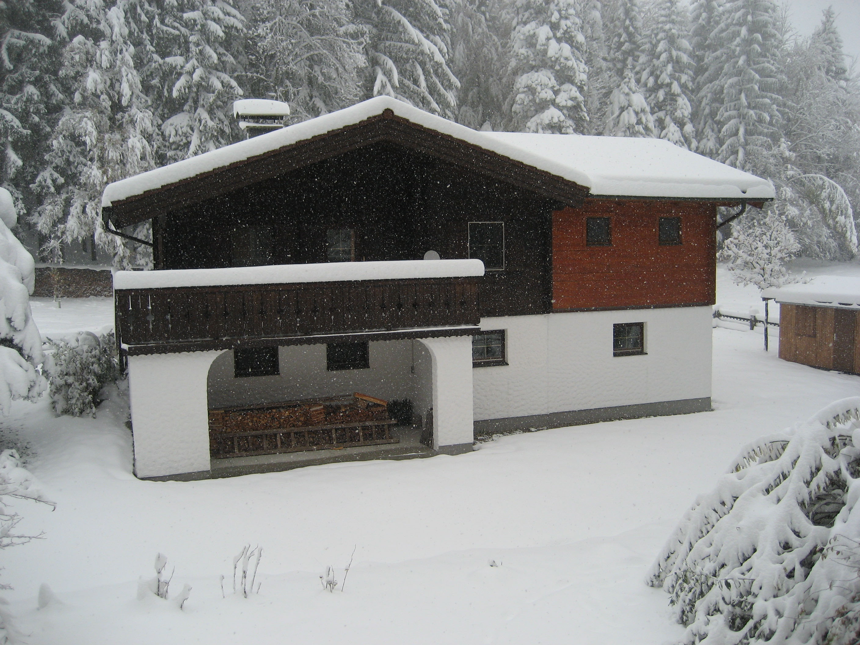

Had the same constraints when I built this cabin...
Typical construction is all concrete block which works as long as home is heated/lived in.
My problem is the home is shuttered 11 months of the year... my only choice was to go timber the upstairs living area... no mold or moisture issues because the wood is never cold enough for the moist air to condensate.
Keeping the surfaces about the dew point is the key...
I would think blueboard or spray on would help immensely.
That said, I'm also a believer in living all 4 seasons before committing to big expenses.

The cabin in a few minutes outside of Salzburg Austria on the road to the Lake District...
I added the back half in 2009 for a property master bedroom suite with bathroom... not typical as everyone has bathrooms off hallways... often even the bath is separate from toilet... what can I say... I did it my way... drew all the plans that were approved by the city plus spent months over several years on the construction...

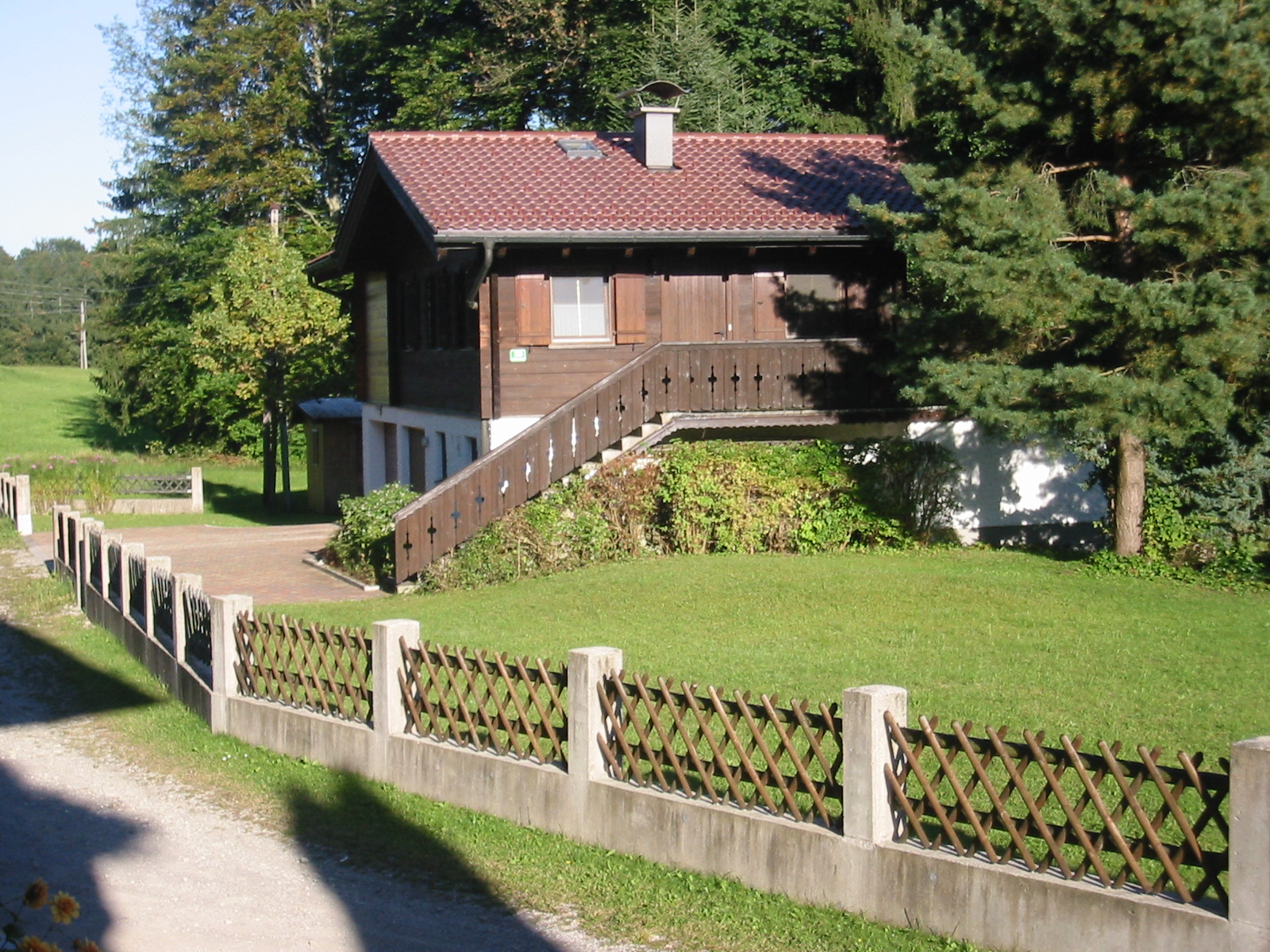

The last addition is the double garage on the other close side of the property on the right... had a lot of comments about only an American would have a summer home for 4 garages!!!

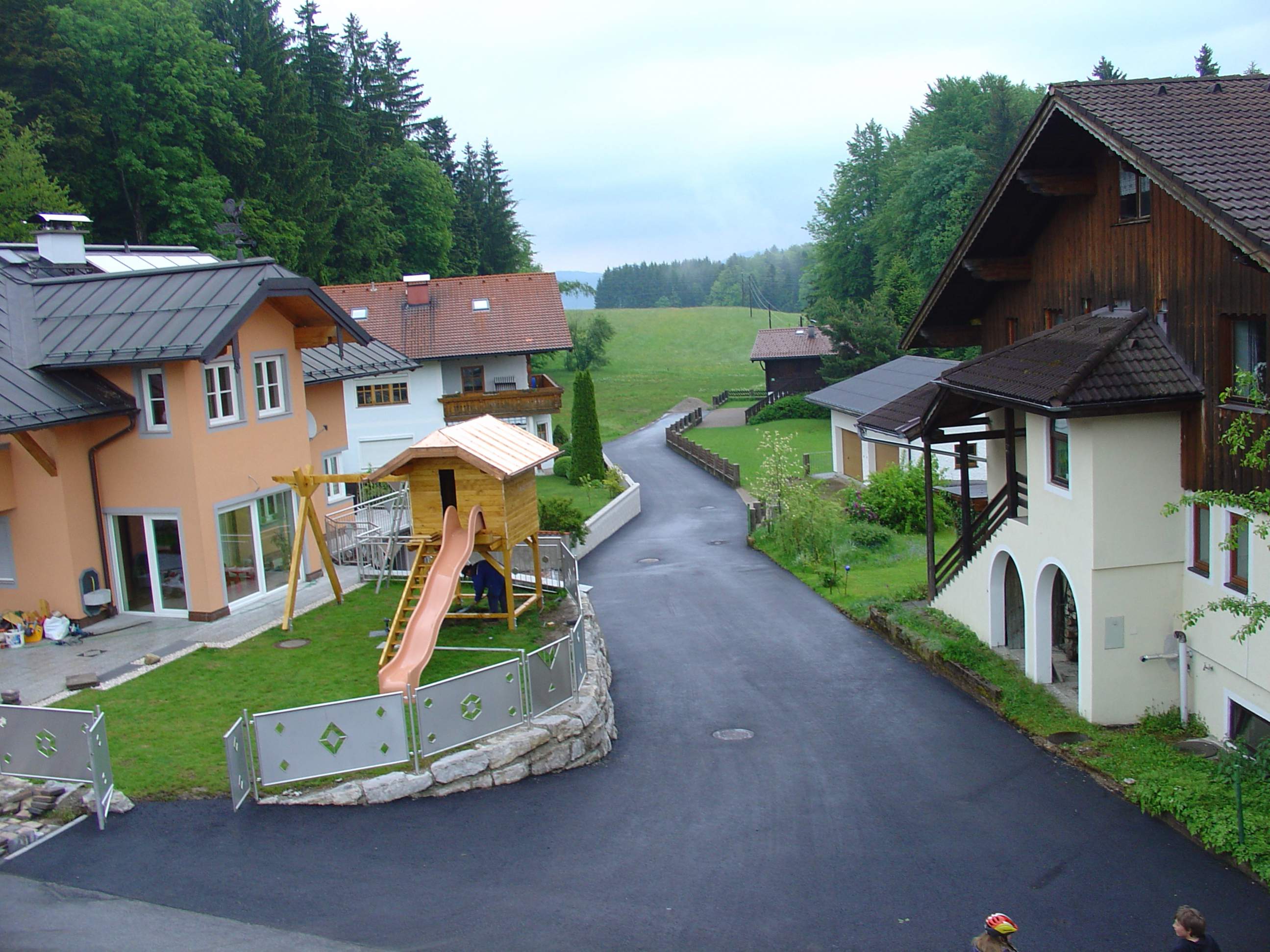

The other picture is looking is a neighborhood shot... when I built the original cabin... none of the neighbors homes had been built... for 16 years I was all by myself...
My neighbors are all trades people... the first house on the left is owned by a roofer... yes... all copper roofing... even the kids playhouse and stainless steel fence panels...
Moisture and summer humidity is a real concern there with so much block construction... radiant heating is real big and does wonder to control humidity... if the floor is warm a lot of livability issues go away.
