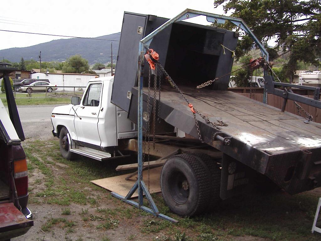

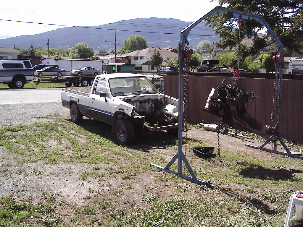

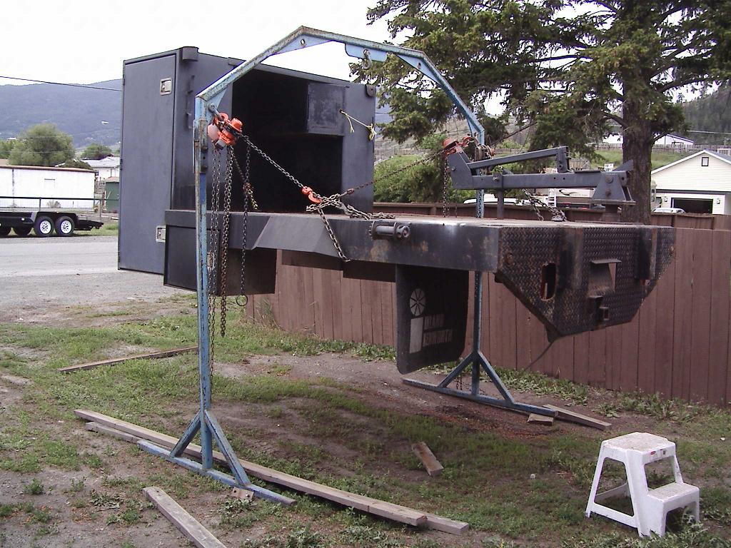

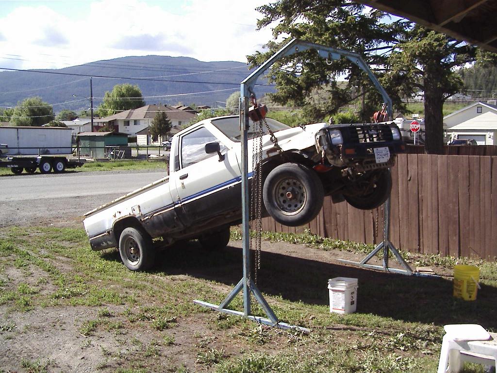

i built a gantry that can be disassembled/reassemble by one person and loaded in the back of a pickup truck.
it has lifted close to 5 tons using the outboard rigging points and can lift a 2000lbs welding machine from the center point. it is built using 2x2x.125 wall hss for the legs and 2x2x.187 for the top. i built another one like it with 8" wheels but it's lifting capacity is far lower because of the wheels.
i don't mean to hijack your thread, just throwing out some ideas.:)
