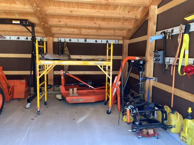

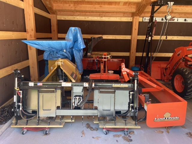

:cool2: 16FCE95A-E1E8-4A35-A179-ED3F1492BFE3.jpeg45E726EA-17F3-4F3D-AA4D-7F1253E01F42.jpegI have Northern Tools Gantry on wheels for use in my tractor attachment shed. It has been indispensable for me to move and organize my attachments by myself. I can lift up the attachment and place car 展heel Dollies or similar load bearing dollies on wheels underneath them and then move them around in a large game of Tetris in my shed. I got a 4ooolb rated gantry that is height adjustable but went with 2000lb rated chain hoist, so there痴 the limit. I also found having a 3 ton quick lift hydraulic jack, can help similarly for placement of wheel dollies under attachments. The gantry was indispensable to disconnect and connect that PTO auger attachment. I can move this whole gantry and attachment (still chained but weight resting on wheel dollie) over to a shed structural beam and strap the auger to the beam as those attachments are a bear to handle (and dangerous).
