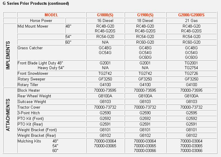

Here's a pic of the implements for the G2000S from Kubota's site.

I found that page too. Thanks. What I can not find is where to buy them. Perticualy used.

I have a G1800S, which is basically the same, except it is diesel.
Does your unit have the rear PTO? If not, the tiller is a no-go, as the rear PTO kit is NLA.
You also need the three-point hitch option, also NLA.
The tiller itself is NLA as well.
The PTO runs at (if I remember correctly) 2000 RPM, and has a special spline. You can't connect "normal" 540 RPM implements to it.
Sorry for being such a ray of sunshine. You still have a great machine for mowing grass, and towing a yard cart (I actually had a hitch receiver made for mine, and pull my 4.5x8 utility trailer with it as a yard cart). It also comes in handy to pull my splitter around to where I need it, if I don't have the hitch on my B7100.
The best source for the tiller, snow blades, snow blowers etc, are Craigslist, eBay, and your local used-tractor place. What I found, though, is not many selling the implements separately, but packaged with the tractor. The G1800 and G1900 seem to be the most common.
Your tractor shares these implements and accessories with the following models:
G1700
G1800(s)
G1900(s)
G2000(s)
