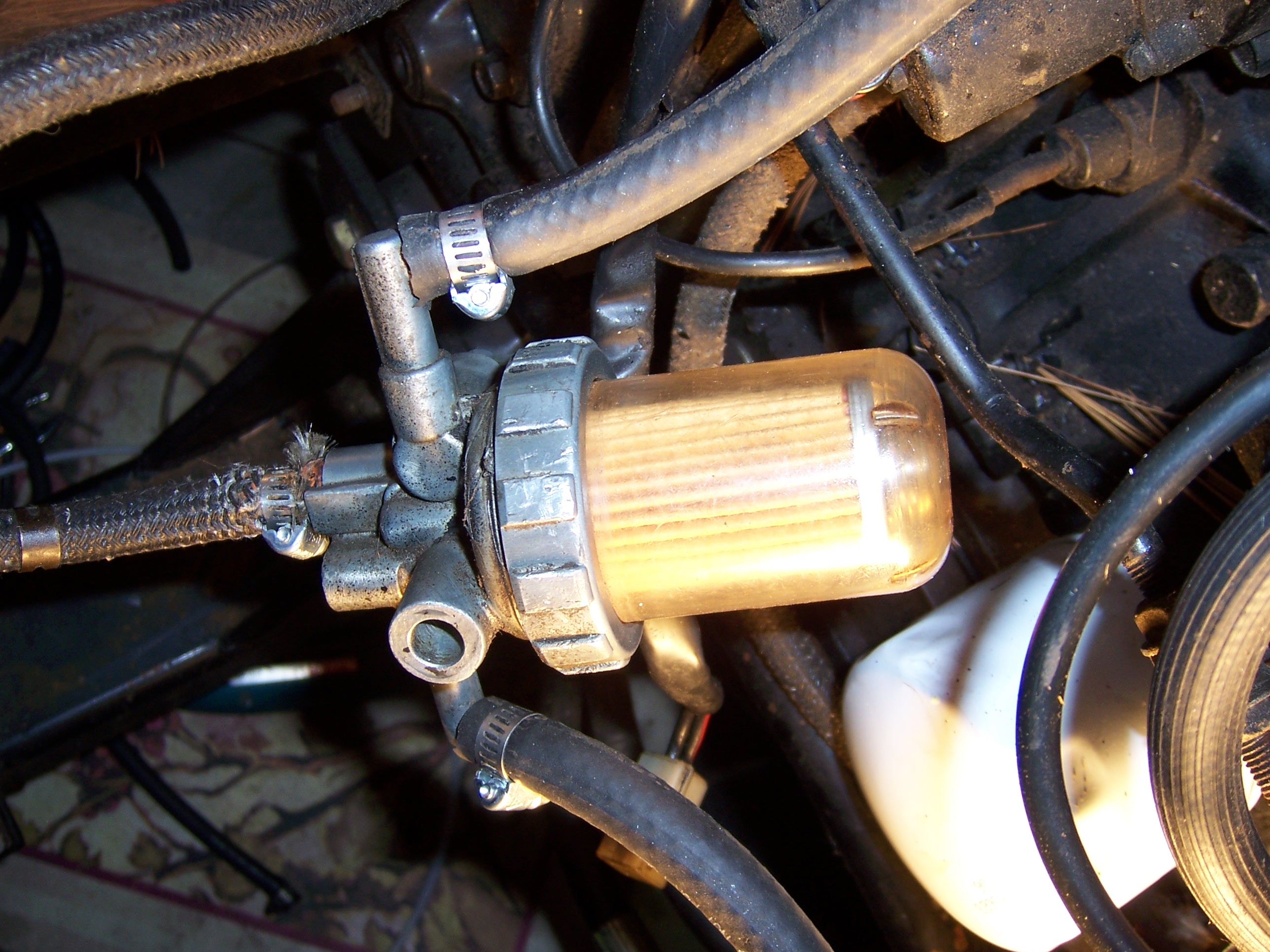

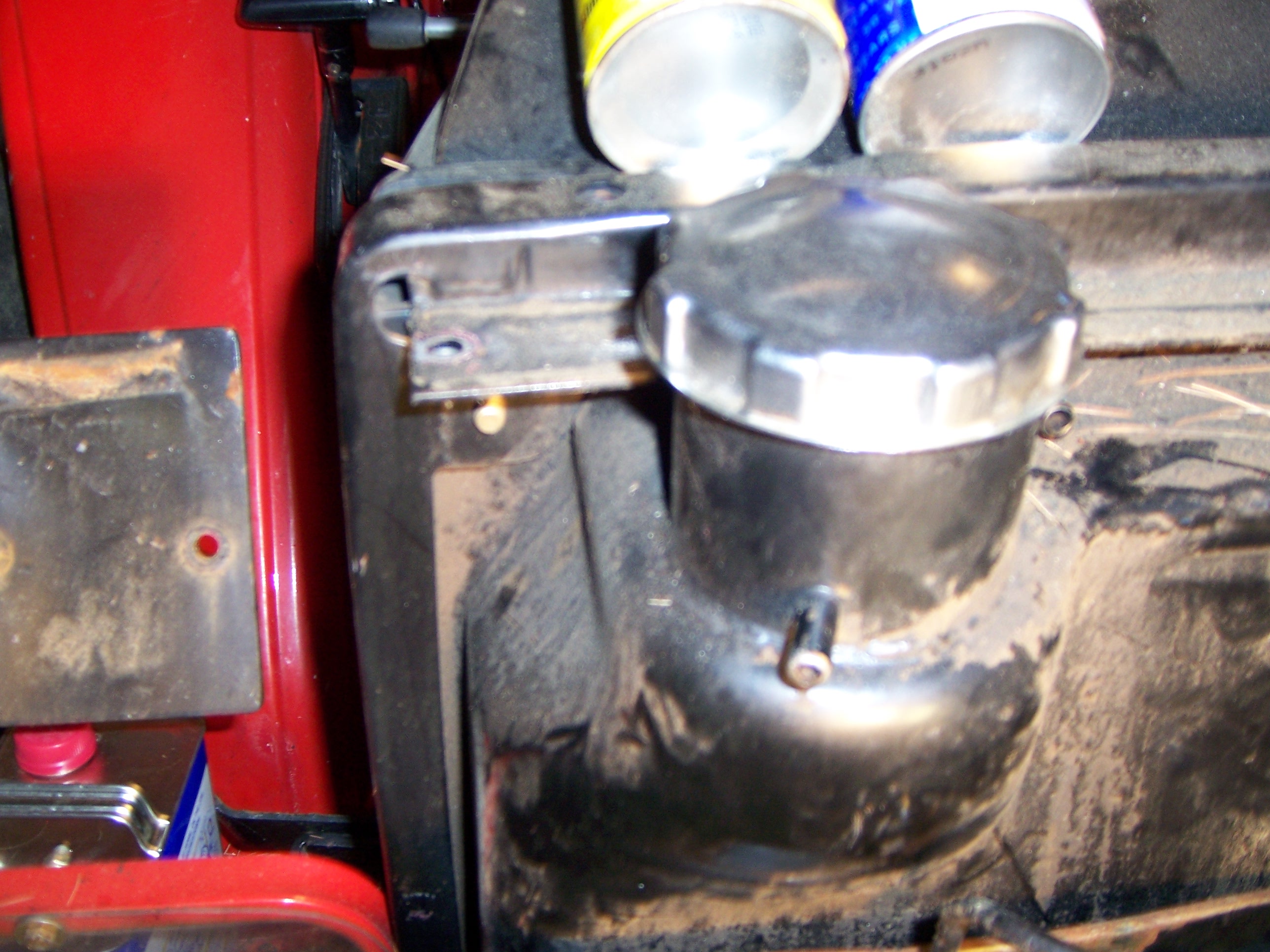

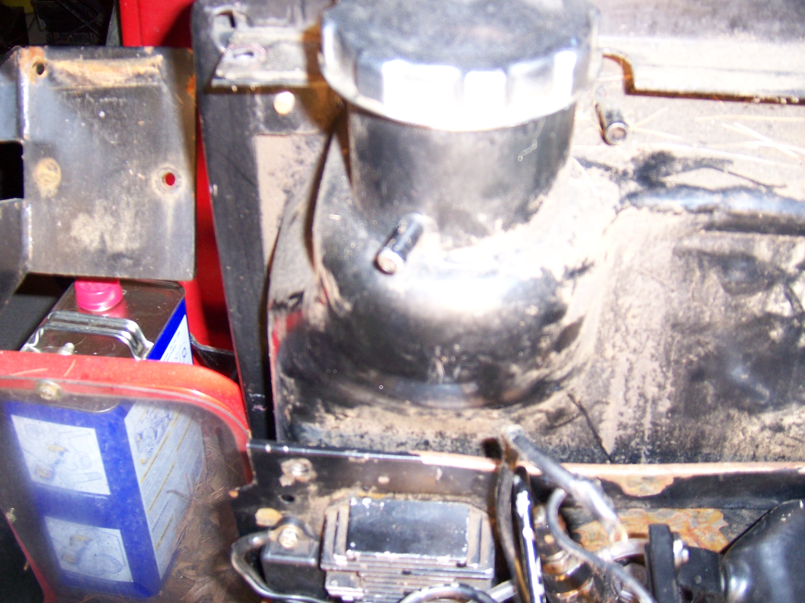

Hi:
I have just fixed my head and I am having trouble remembering the connections on the fule lines.
The parts book does not really show me the answers.
1. The fuel tank has 2 little pipes coming out the top.
One off the top of the tank and the other on the fuel cap pipe.
I think that maybe these connect together in a loop - but why???
2. There is a fuel 4 way connector. 2 small pipes and 2 larger ones.
1 small goes to the injectors the other small goes to the block
1 large goes to the right side of the fuel filter ????? the other large goes to the same part on the block.
Where does this mount??
I thought it mounted behind the fuel filter BUT it is very tight and you can't remove the bowl with that mounting.
If you have FX can you send me pictures of that side of the tractor???
email - joe@aksbio.com THANKS
/ FX22D
#2
here are some photos of the Yanmar FX22D fuel side
