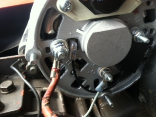

We took reading from Red wire lug and it was 12.6---12.8
D+ reading was 12.6---12.7 We tried cranking the tractor and the voltage had a jump to over 12.6 but after it cranked it dropped back to right under 12.
As for the gray wire and Blackwire they both come from top of engine right across from ear of alternator. If I disconnect both wire from where I have them connected they just dangle.
Here is a picture of the alternator: photo.JPG you may need to turn pic to correct position.

Was the 12.6 volts on the D+ with the key on or key off? Was there any voltage with the key off on that wire?
As for the voltage dropping out (right under 12volt) that is normal when you crank the motor.
Now I want you to do this.
Start and run the tractor
check voltage again at the red wire lug with the tractor at idle and then bump the throttle up to 1/2 to 3/4 throttle and recheck it again.
If you only show the 12.6 volts with it rev'd up, I want you to take a piece of wire 4 to 5 inches long and strip back both ends just about 1/4" and then I want you to touch one end to the red lug and the other end to the d+. You only need to touch them for a brief second. What you are doing is manually exciting the regulator.
Once you jump them I want you to check the voltage again at the red lug while its still rev up. I am hoping you find 13.6 volts or higher after you jump the exciter wire (D+). If you find that you have good charging voltage on the red lug, I want you to bring the tractor back down to idle and test the red lug again and see if the same charging voltage is there.
This idle point is where you say the light starts flashing on the dash. My main concern is what voltage it is putting on while rev'd up. I would almost guess that it will be less than 13 volts, but possibly just a tiny bit more than the 12.6 with the key on.
How old is this alternator and was it a reman or a new one?

   / Fuse box location on MF 231 (not231S) #18
I really think you have a bad alternator. I don't know how old it is but if you have voltage at the exciter wire it should be charging. I am going to look up one more thing tomorrow at work, but I am hoping this is bad reman on the alt.

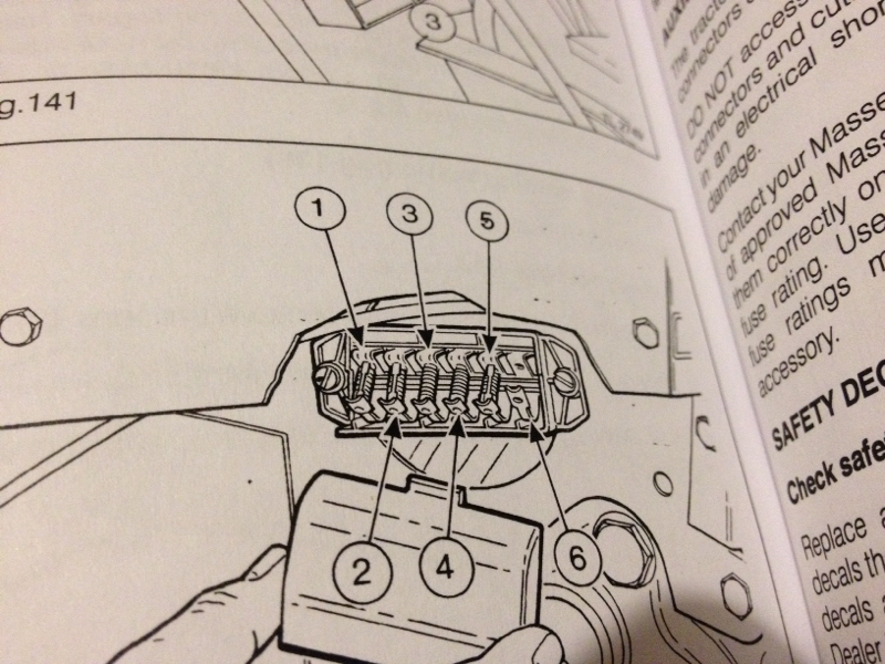

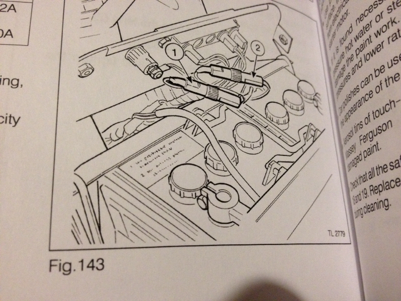

   / Fuse box location on MF 231 (not231S) #19
I'm gonna see if I can post a few pictures with my phone. The pics are out of the "Operator Instruction Book" (owner's manual) for a 1998 Massey Ferguson 231.
