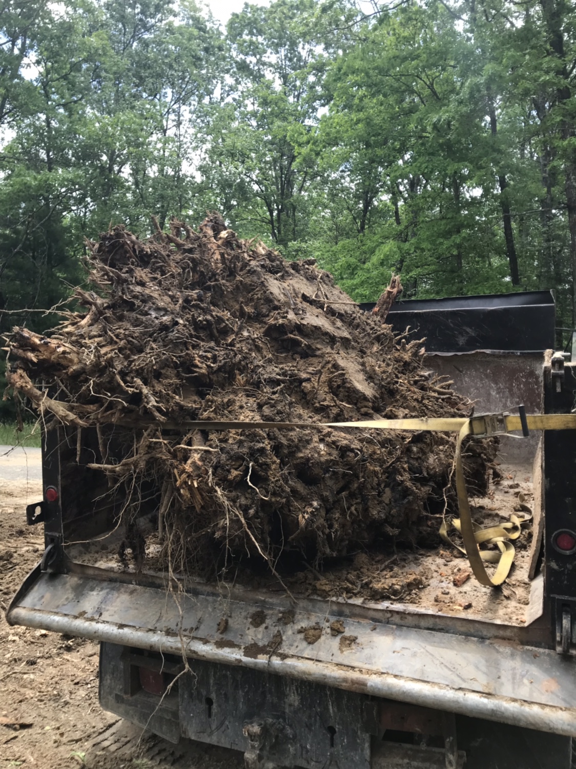

This stump isn’t even 30 inches and I had to make a team effort with the 19,000 pound trackhoe and my m59 because neither one could pick it up by themselves. I didn’t care to dig stumps with my 310. but I won’t dig big ones with the M59.

Here I was thinking I was just being too gentle with my new machine and tomorrow I could give it a little more oomph. But now I am getting a clear message that it likely isnt a good plan to try. Thanks.
