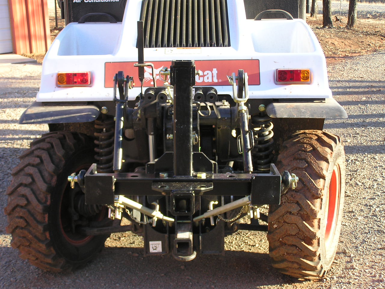

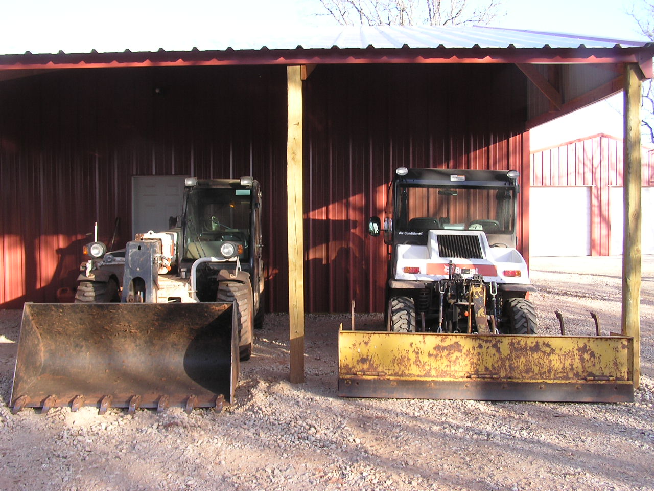

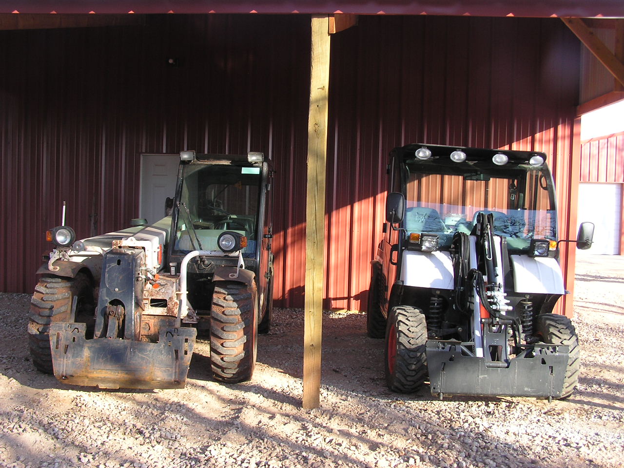

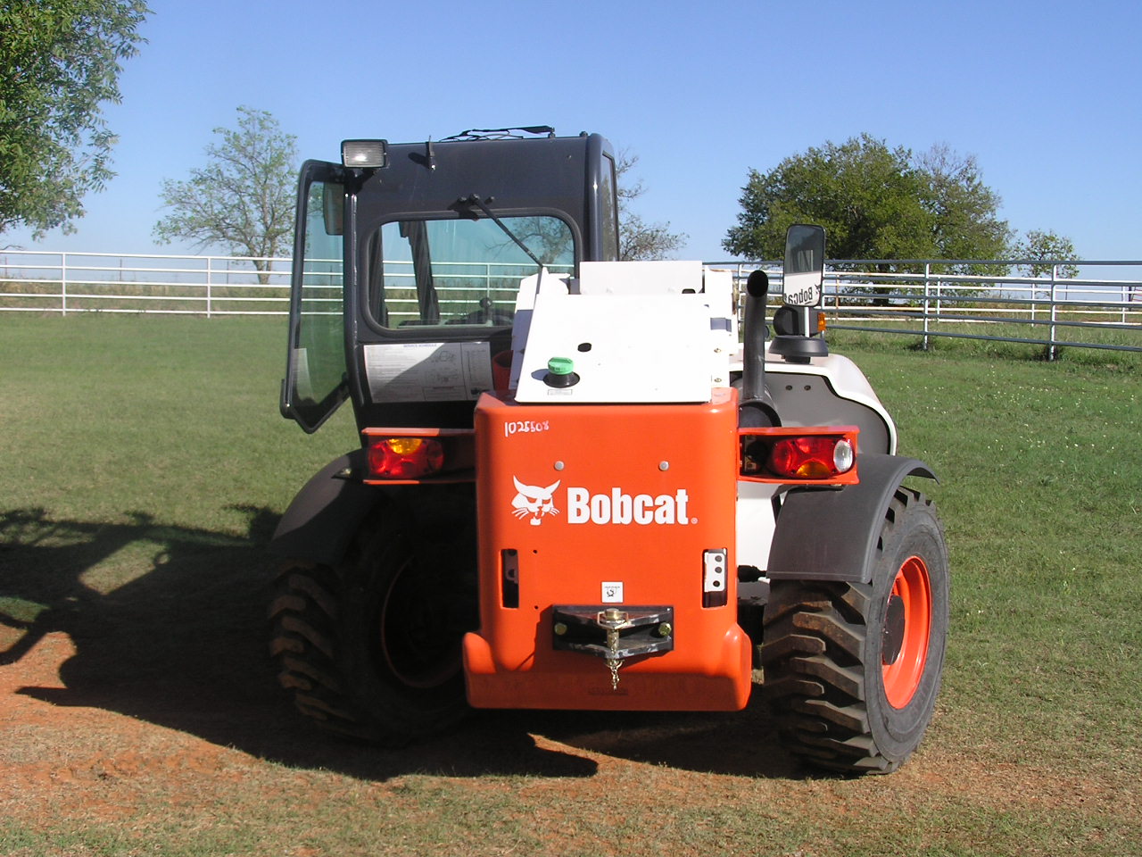

It depends on the machine. Both of these are full time 4WD, there is no 2WD switch or lever.
The Toolcat has a switch for 2WSteer or 4WSteer.
The V417 has 2WSteer, crab steer or 4WSteer.
Neither one tears up the grass when turning. :thumbsup:
