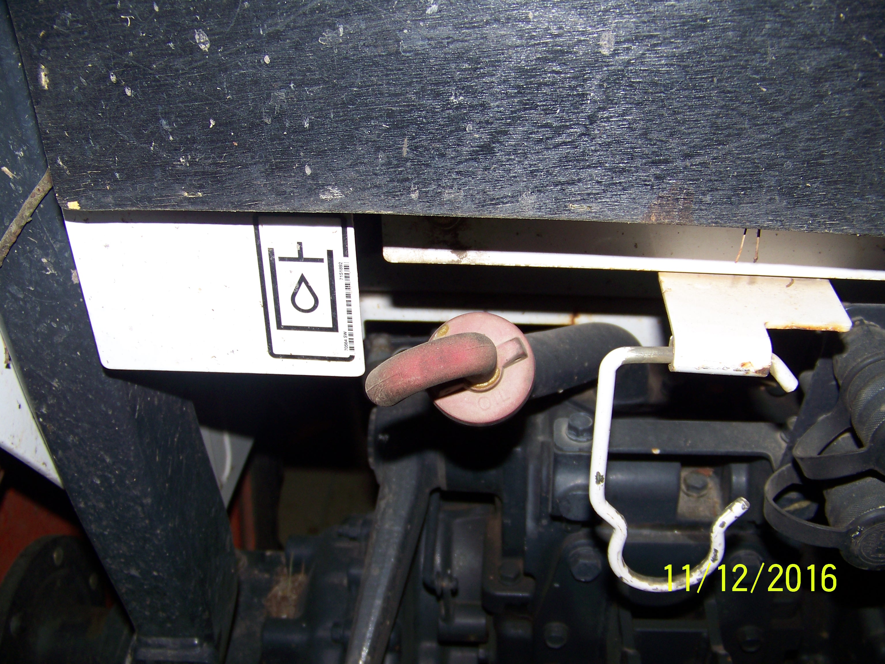

Thinking I remember a funnel end will fit right in the fill hole on the hydraulic and swallow up the fluid pretty fast. You are looking at the attached picture hole?
I bought Kioti filters from Mowpart. Hydraulic T2185-38031 $35.18, Hydrostat T2195-38031 $21.92. This was April 1st, 2015. I did pay shipping and tax making my total order $71.76. About the same price you paid.

Just wondering how hard this is to do and if there are any tricks or tools needed. I change my own oil. Just wondering how hard the other filters are to get off. Also to fill the hydraulics, is there another fill location other than the little tube out back. I have a Bobcat CT 235. Thanks for any thoughts sources for filters, etc. I do get good prices from Bobcat on most of them.
One other question, and I know this will kick up a storm. Is there another brand of Hydraulic oil folks know is good (good or better than Bobcat). I have access to most brands) I am not talking about the TSC/Sam's/Walmart brands either, unless these are proven. Thanks
Tip: park your tractor on 4x4s to get some extra clearance while working under it.
Tip: use a chain wrench to remove factory oil filters.
Fluid wise, Kioti specs 10W20 hydro-trans oil. Napa sell it as
Two gallon pails.
Five gallon buckets.
Front axle Kioti wants you to use either hydro trans oil or up to 90W gear lube. I just put in one gallon of 90W and a quart of 80W85W90W into my front axle. This to say it isn't fussy.
