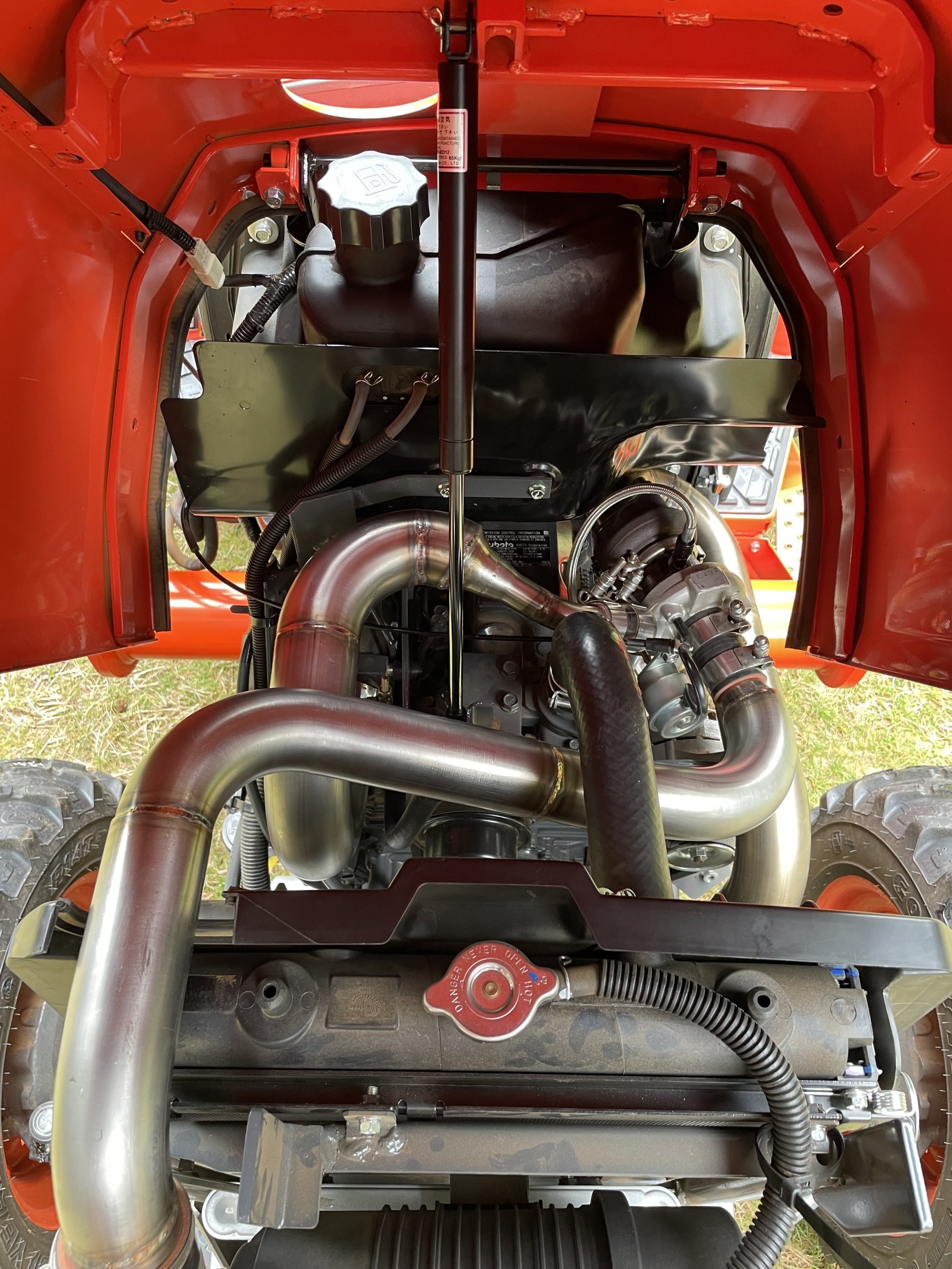

Yep, adding fuel will give you a reasonable increase in power. Or, you can add a Turbocharger like I did on my Kubota L2501.
The L2501 went from 24 HP/19 PTO to 44.1HP/35 PTO with the Turbo Kit on the PTO dyno.
Mike
I like your turbo setup, but adding just a turbo will not do much without also burning more fuel!
Just saying.
Just saying.
Thank you. Yes, a combination of the two is required for a substantial increase in power.
Mike
Good work! Any cars you did this to? What charger did you use on the tractor?
