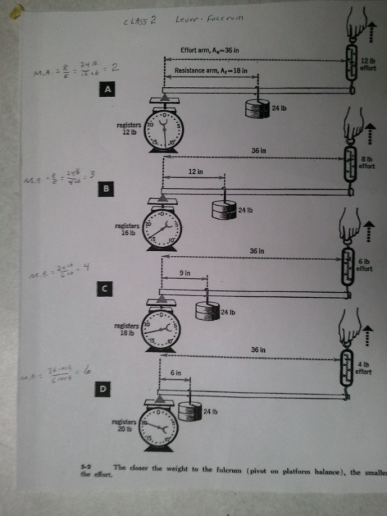

scanned an old physics book of mine, dont know if this will turn out right, info about a class 2 lever-fulcrum.

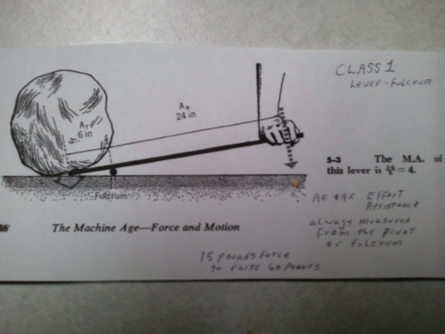

and a scan with a class 1 lever fulcrum

clicking on the above thumbnails brings them to an almost readable view.
