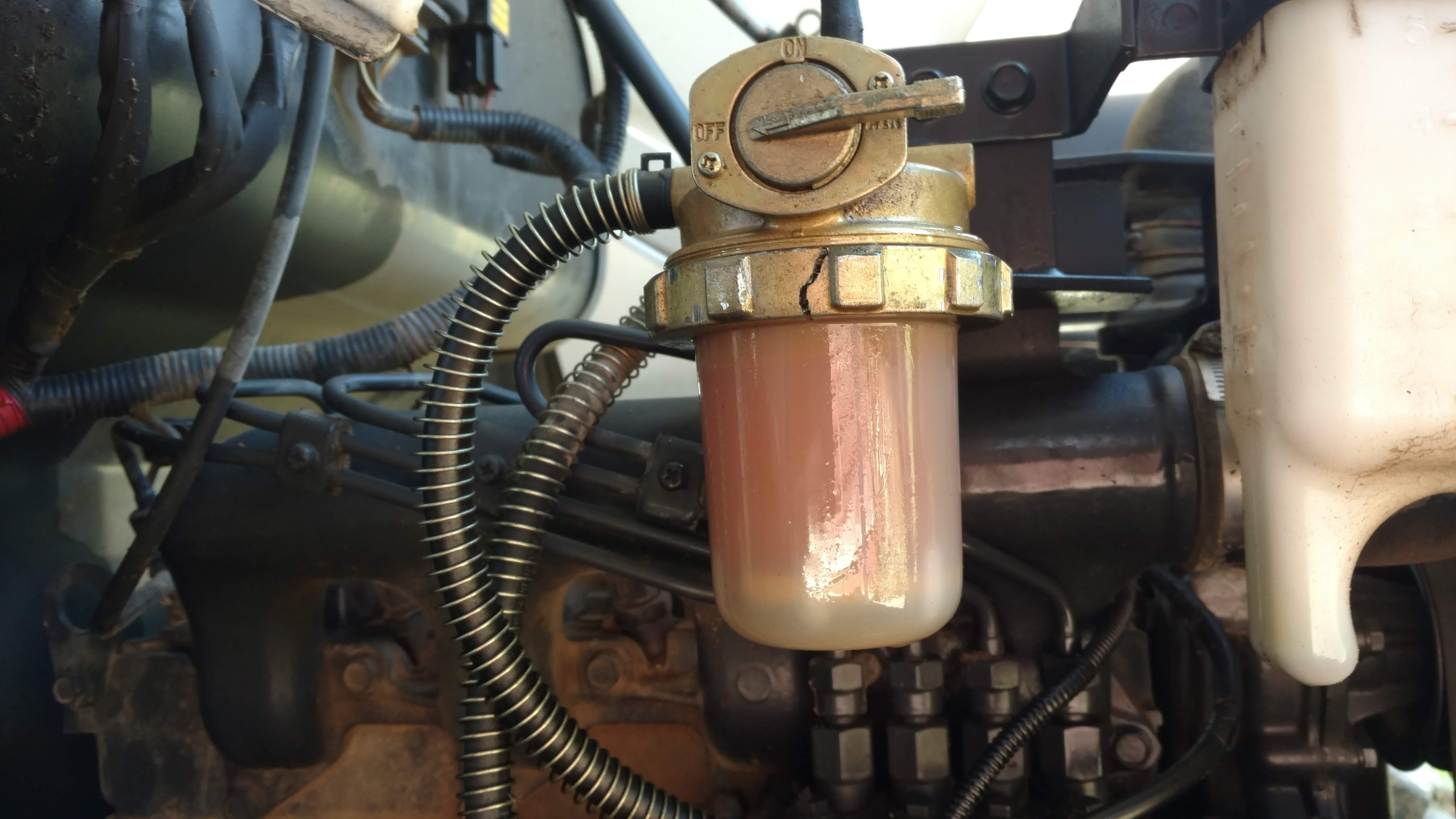

Could use some help finding "retainer" to fit,or a full new assembly.
I am wondering if this part is the same on the Kioti. I'm not certain as the Kioti diagrams I could find do not show the breakdown of the filter assembly nor a good pic. I can get a Bobcat part, but it will take a few days though and I am down, with good weather, now. :(
I am cross posting to the Kioti forum. Moderators, my apology if that is a no no.
Bobcat CT450, SN:ABHM11193 - 50HP, 4cyl Daedong - Similar/same as Kioti DK45/DK50
I am looking for service parts for above named tractor.
I believe that item 15 is the compete Assembly, containing all of the other parts.
My actual need is Item 17, Retainer. Mine is cracked.
However, while in there I would like to put new seals, filter, spring, etc.
So, I either need item 15, or all of the other items.

Picture of my filter assembly:

Curious how it cracked
You and me both. Haven't had ny issues up to now. Was out working the bush hog and grapple started smelling diesel. Normally its smokeless and near smell-less. Thought hmm I did just fuel, maybe I spilled some? No, I am too careful. Maybe winter version is different somehow and smellier? Seems far fetched but more likely than me spilling fuel. :p
Anyway, stop. Investigate. Smell fuel, touch filter housing, moist. Hmmm. Look around, and there it is. Cracked. Been fine for 10 years, today, not so much. :D

For the moment, I did what I had to and ordered a new assembly from Bobcat, probably paid 20% more than the Kioti part. I was hoping to find something within and hour or two from home, but alas. Surprisingly, Michigan Iron told me there is no cross. I also ordered a new retainer nut. If that all that's wrong, rather than have a spare of something I have never needed in 10 years, I think its time to update the filter on that embarrassingly poor filtered Kubota.
