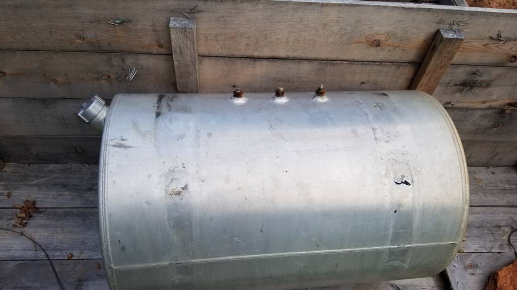

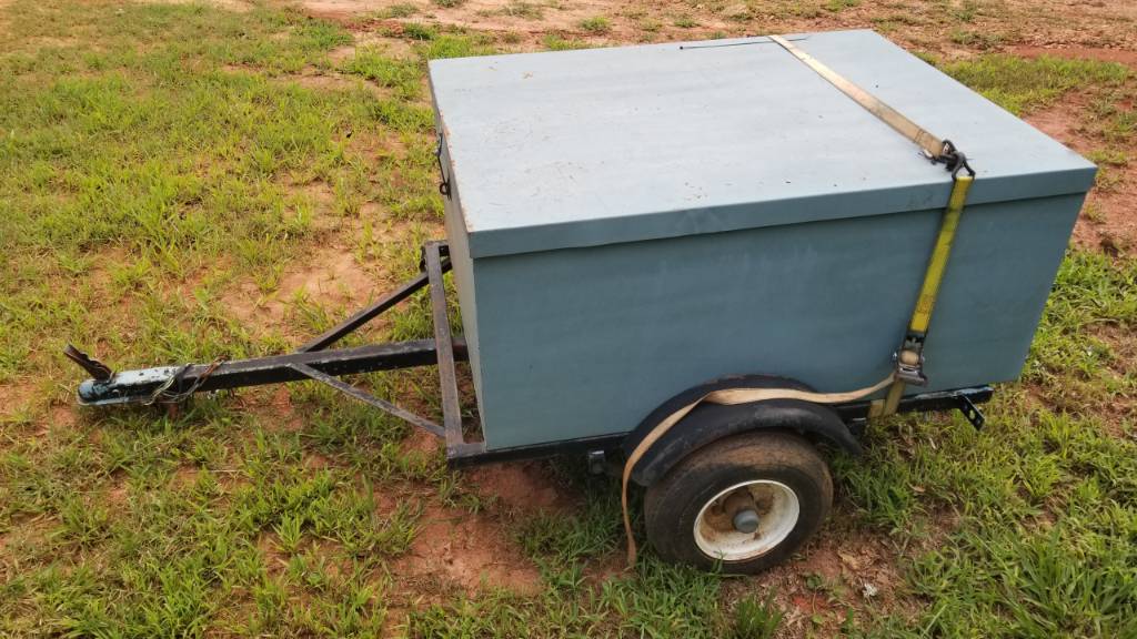

Sorry to have written the original post & not followed up on it, but things have been a bit hectic this week. Here's a couple pictures of the tank & trailer. I would only be traveling about 5 miles to get the fuel. I am sort of a weekend warriors doing things with the tractor on our 15 acres. 30 gallons of fuel would last me 2-3 weeks and would eliminate the need for the stupid DOT 5 gallon containers I 1have been using. I usually end up spilling about a half of a gallon trying to get the fuel to flow into the tractor because of the convoluted design, & having to push this & hold that, plus the things are not vented so it takes forever. I'm looking for something that is user friendly, & will let me refuel quickly! 20180726_194939.jpeg20180726_194930.jpeg

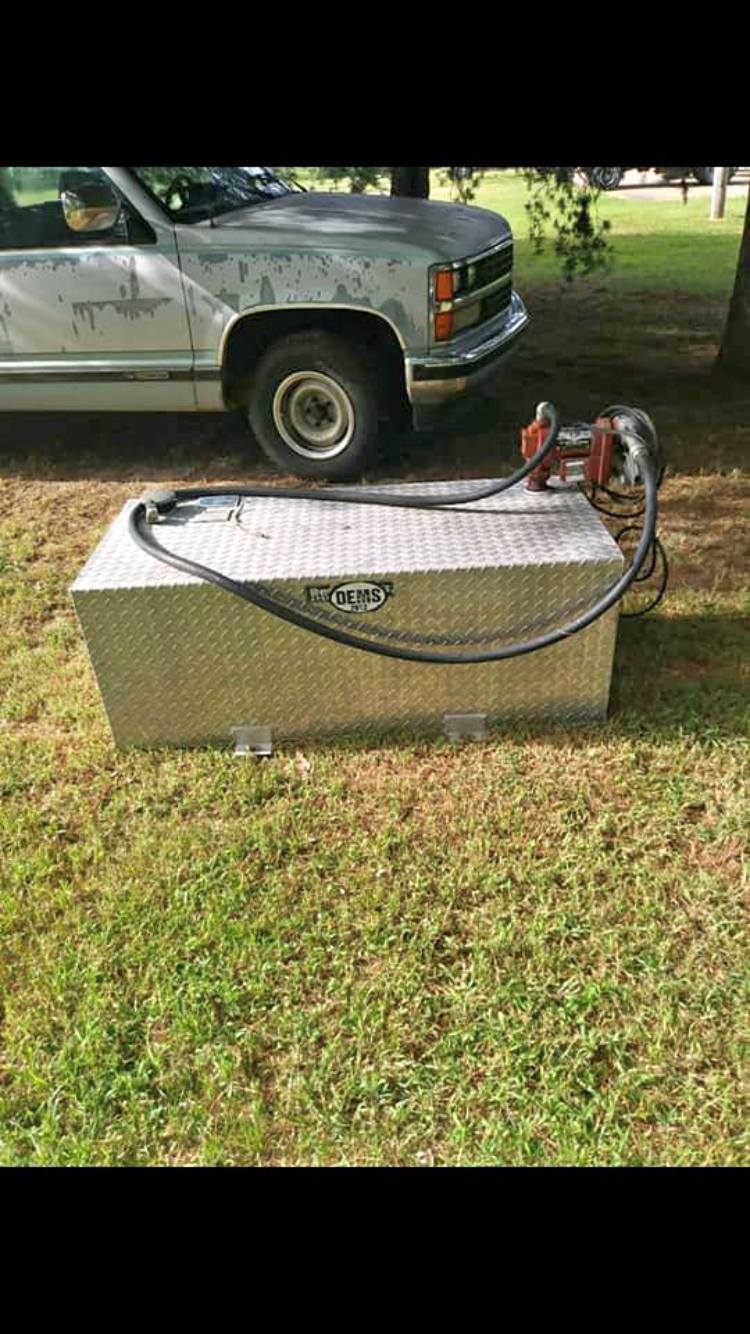

I have the same idea of making a fuel trailer. I have a old trailer that was gave to me that I took with the intentions of just cutting it up for the metal but I got a 3500 lbs axle for $50.00 and I have rims with tires sitting in my barn that would fit the new axle so I was going to buy the springs and put the new axle under the trailer. Then I was going to weld on some angle iron to bolt a wooden floor to and then add finders. For the tank I have 2 ideas. 1. I was thinking of just bolting the tank directly to the floor and it would be used strictly for a fuel trailer. or 2. I was going to build a heavy duty pallet to bolt the fuel tank to that I could load with my forks on the FEL and have either a way to bolt the pallet to the trailer or use my big 2 inch wide straps to strap the tank down. That way I would then have to trailer to use for other things like hauling my mower of the 4-wheeler behind the wife's suv. I plan on putting a filter and water separator on the pump. I bought the tank and pump used from a guy who was just needing the money so I got a good deal on it. But after reading your comments about the laws about having a fuel trailer I'm wondering if its legal for me to do this or not.
