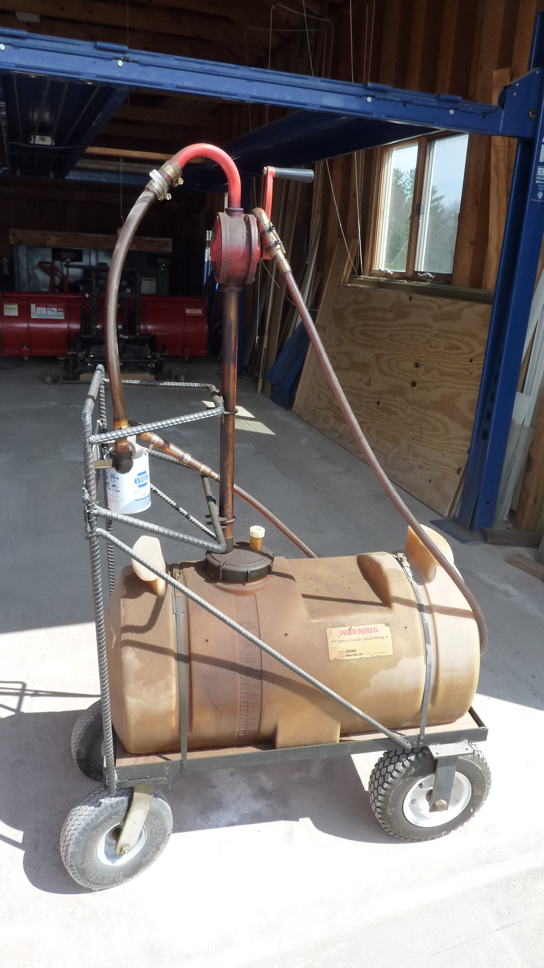

I would definitely check your local laws before towing fuel on a small trailer. It isn't legal in my state so I did something different.
Originally, I strapped an old 26 gal. sprayer tank with hand pump to a small pallet and loaded it in my pickup with the tractor FEL forks. It's a fairly long drive to the truck stop for off road diesel otherwise, I'd just drive the tractor down there with the tank in the FEL bucket.
Since then, I made up a crude cart from scrap I had around and strapped the tank to it. It's easily moved around the property this way. I can load it in the pickup with forks or the FEL bucket. It isn't pretty but it cost almost nothing and has worked fine for just about 20 years.
Last year, I replaced the hand pump with a 110V diesel transfer pump. I have electric service to my shop and barns so a 12V portable pump isn't necessary. A portable DC pump and battery would certainly work though as you plan to do.

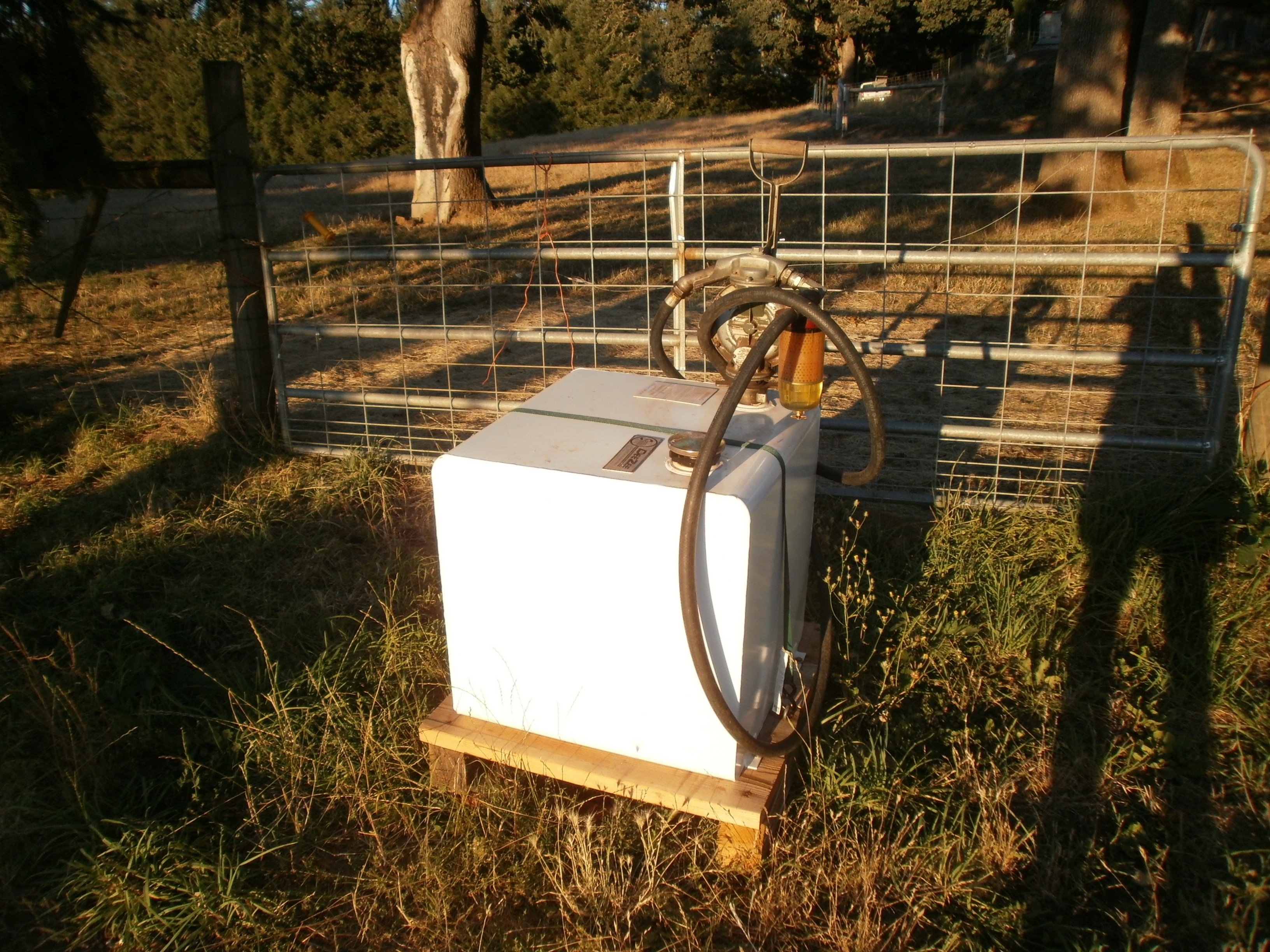

   / Fuel trailer #7
I don't see the point in a thirty gallon tank and trailer.
Fifty seems the minimum and a "code" set up is safer although higher cost.P8050013.jpg
   / Fuel trailer #8
Fifty seems the minimum and a "code" set up is safer although higher cost.]

   / Fuel trailer #10
I’ve got a 50 gallon tank strapped on a heavy duty pallet that I set in the back of the truck. I’d like to have a bigger tank because diesel is about $1 or more a gallon cheaper in the winter but besides that the setup works way better than 5 gallon cans.
