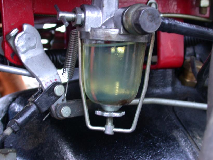

Hi Tim,
Here is a picture of the hand tightened nut that holds the fuel bowl on my KM554. Notice that there is less than 1/4" residue in mine now. I think this is acceptable.

<font color="black"> </font> Thanks Rob,
After draining the fuel tank and "Then" discovering the sediment bowl I already had clear duel in the bowl.
I'll know to keep a close eye on it.
Tim
