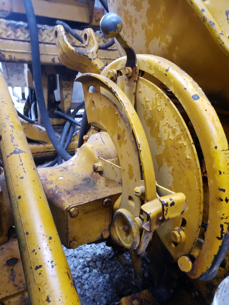

Yesterday I wanted to also check the lifting arms for the three point. Since its a backhoe it appears that the three point has never been used I pushed the arms down and the arms raised like they should. I think the draft lever should be in the up position but the lock knob is stuck for now. I don't know if they will lift with a load.
Resized_20191003_113645(1).jpeg The paint still in the mounting holes looks original. The lift and draft levers look unused. I'm also fortunate it was ordered with a p.t.o. Some backhoes don't have one.
Got off topic here but I have a question about the three point lift in these tractors. I have been trying to verify that the pump only runs when activated by moving the lift lever.

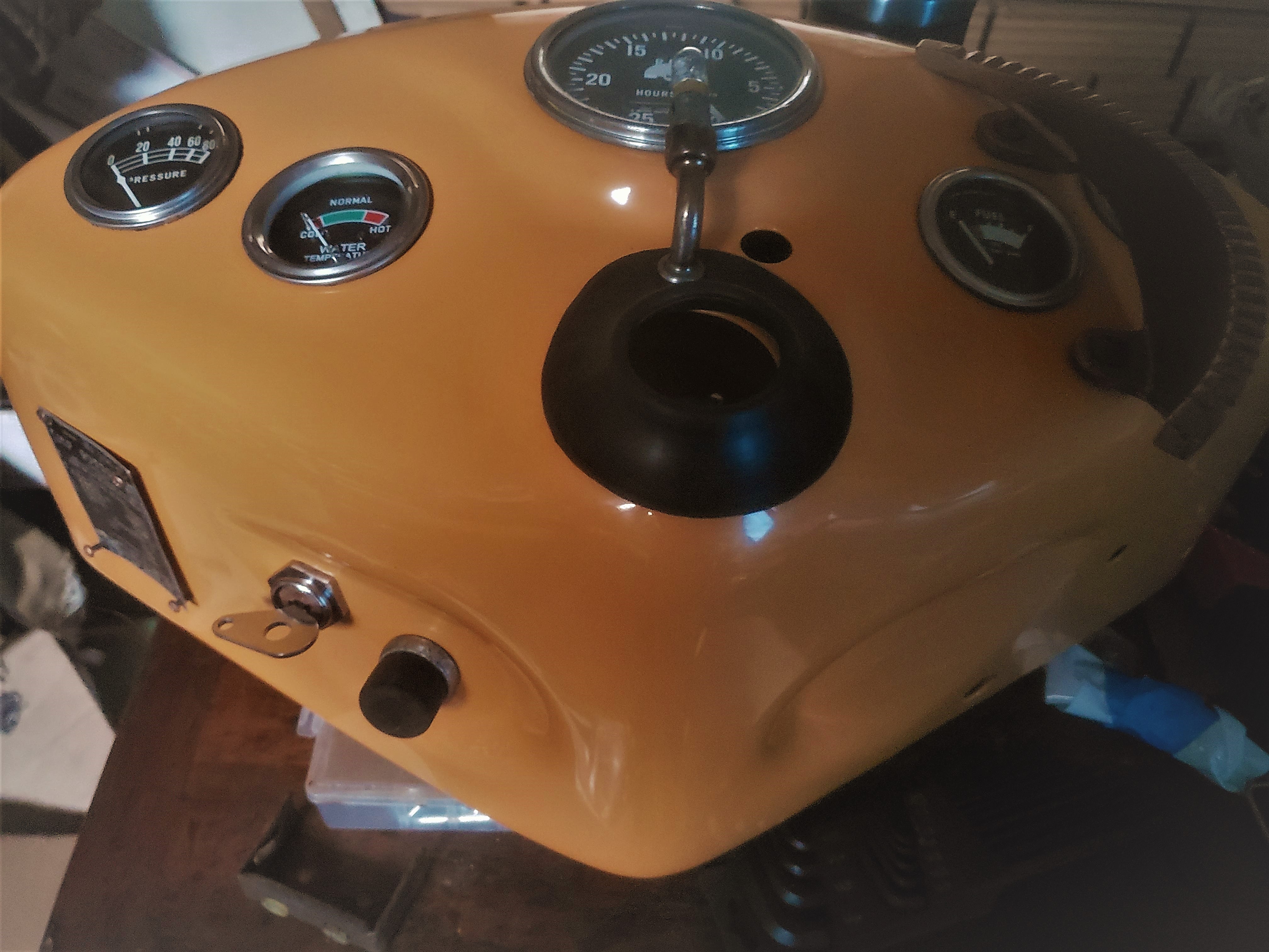

Here is a sample of the finish the Sheet metal is getting.
