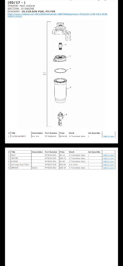

I was reading my owners manual tonight. XR3140HC. It shows a “fuel heater” fuse. What is that? Are they referring to the glow plugs? I also read about the sensor on the fuel filter that plugs in but I’m guessing that’s a sensor for water? I tried to google this but came up empty. Here is a pic of that page in the manual.

It is just like it sounds. Above your fuel filter is a small heater that would run during cold weather and it's purpose is to keep fuel from gelling.
   / Fuel heater? #3
You should see if there is a fuse there and if the heater is there. They use the same parts on a lot of different models. So you may have it and you may not.
On my fuse panel under the left side of the steering wheel I had 2 fuses that weren't used but there was a lead coming from it so I used one for the 3rd function. I plan to use the other to energize my relay for light pods and light bar.

Number 3 should be the heater.
