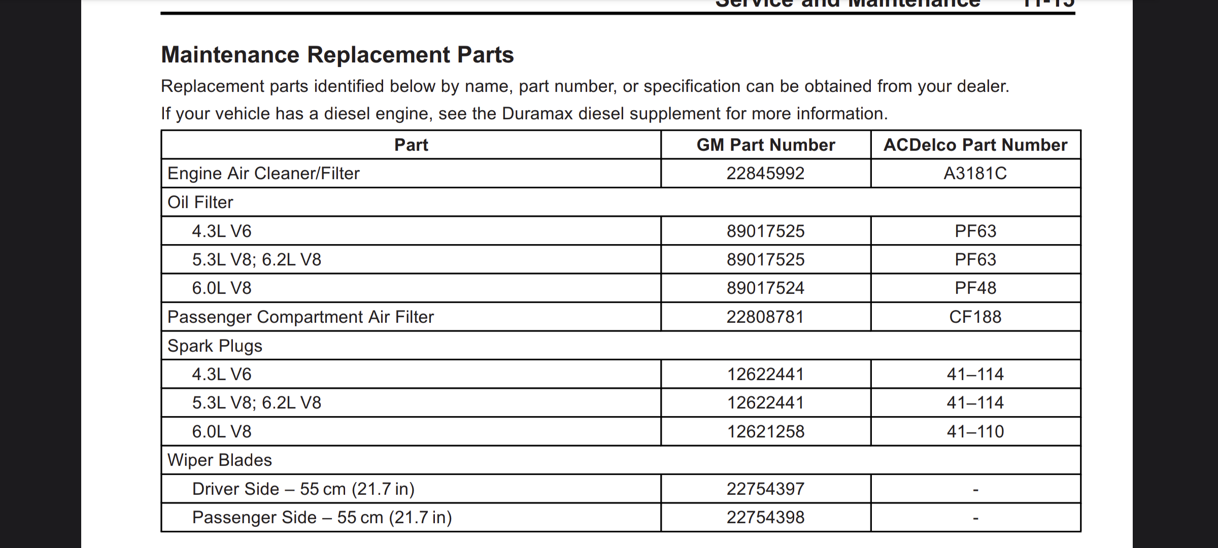

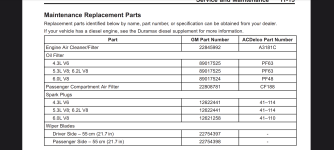

OK, I've read most of the posts in this thread. Then I went and did a search through several owner/operator manuals I have. A "15" and a "19" RAM pickups, a Jeep Compass, Chevy Equinox, a Branson 8050, a NH 8160, NH 6050, a CIH Puma 125, and guess what folks.....
Not a single solitary one of them provides part numbers for the various filters.
Every single one of them does say to see your dealer for the filters and fluids.
If you want part numbers for the factory filters get the danged parts catalog,
if you want the service instructions get the danged service manual.
Silverado. I guarantee the Equinox manual has them listed too.
