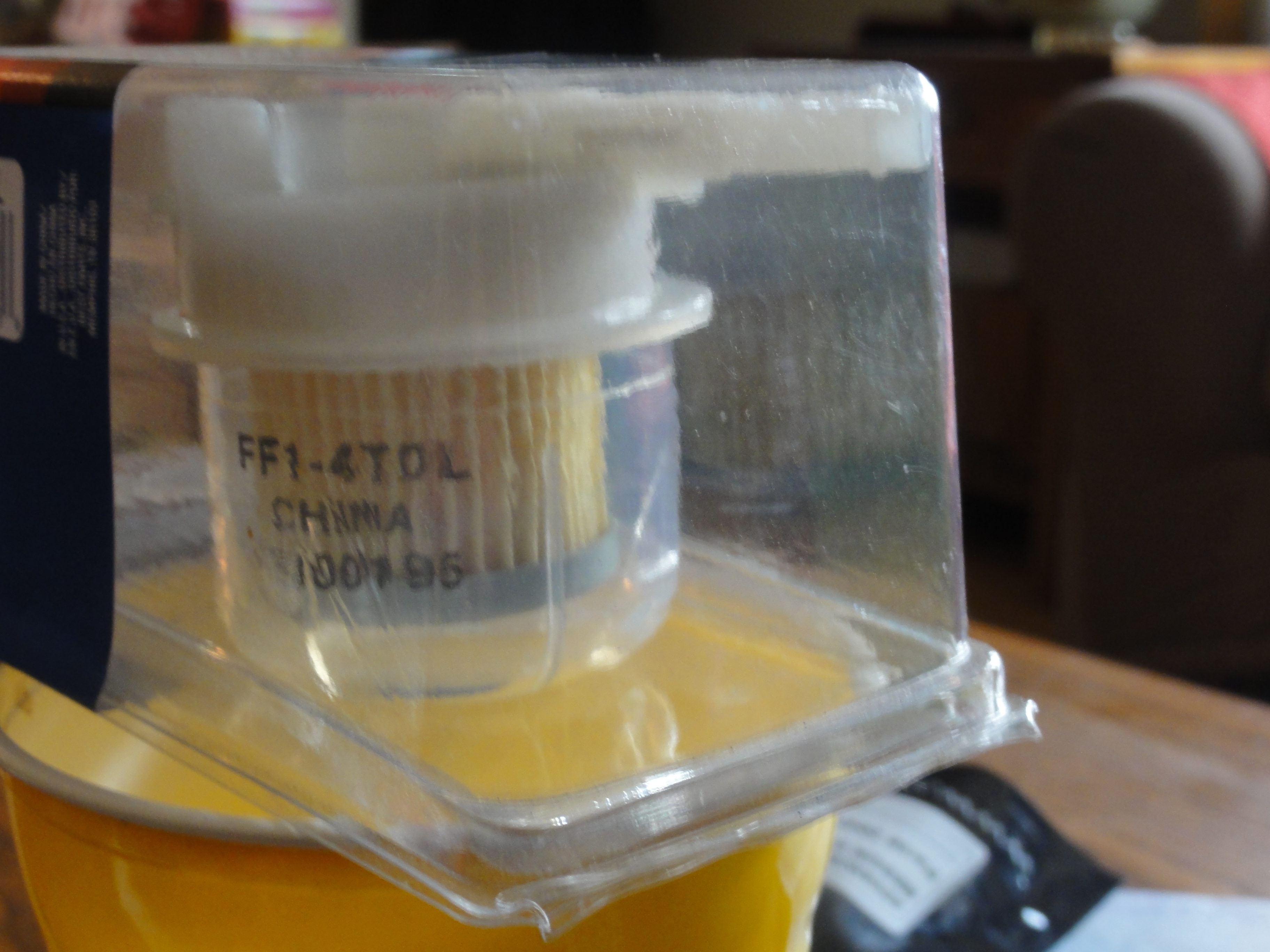

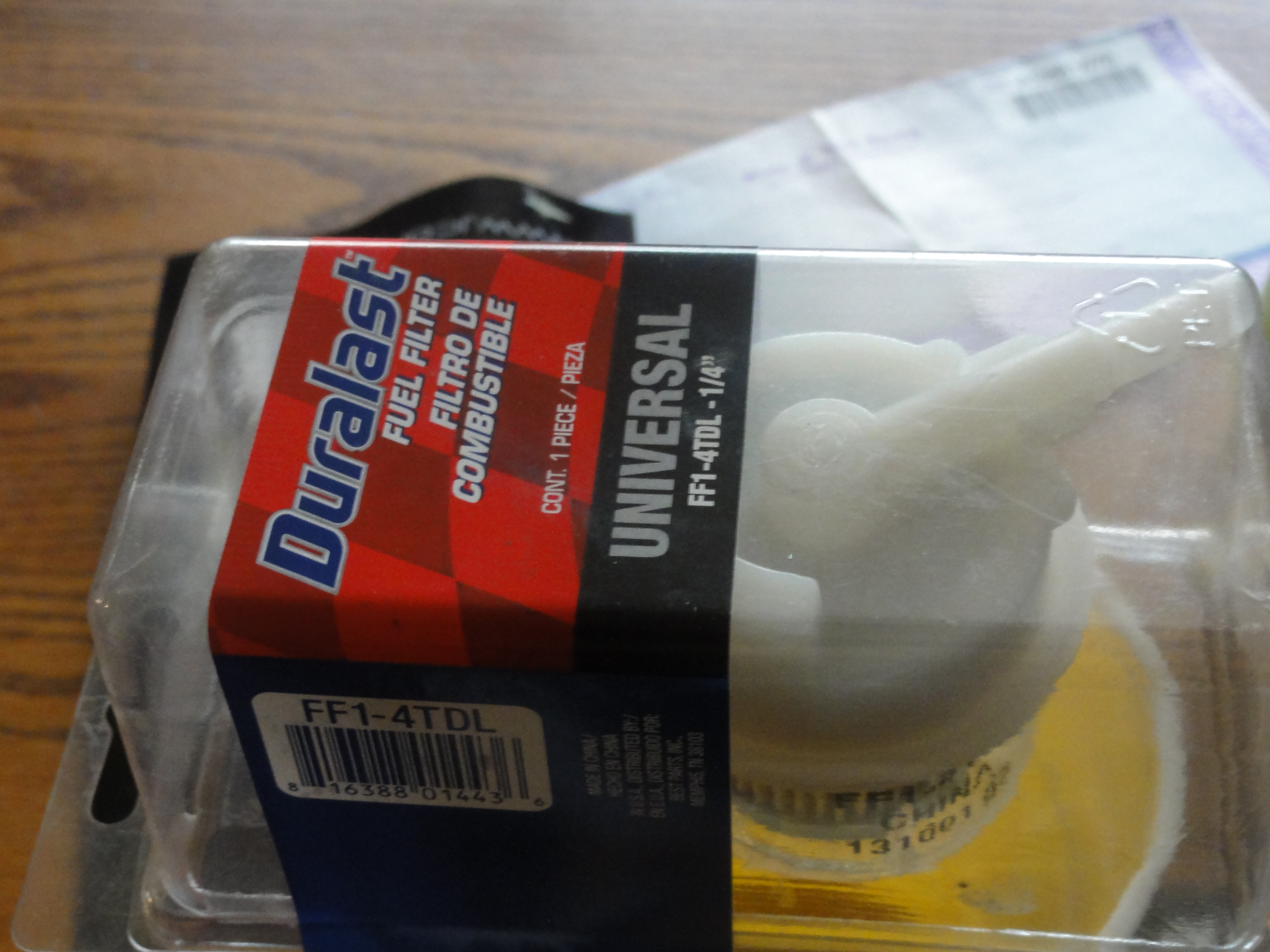

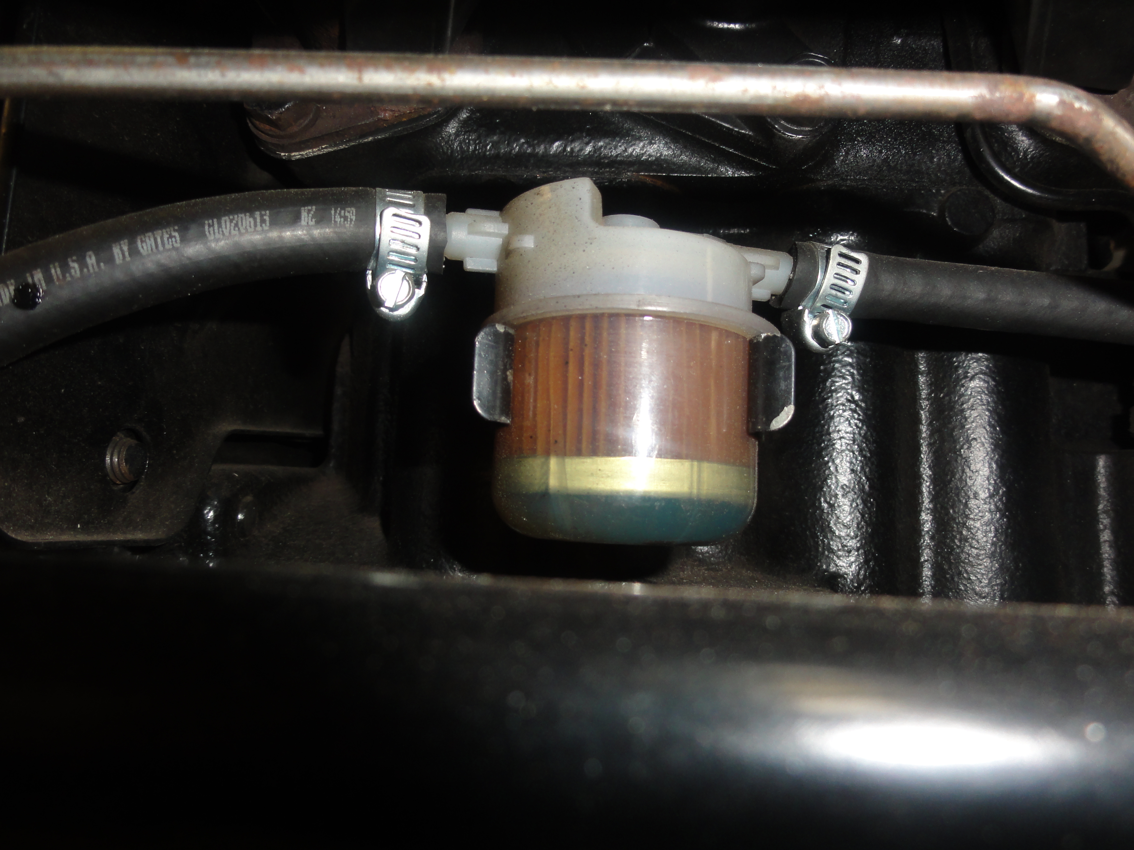

   / Fuel Filter Assembly #8
Here is the filter I have been using since I rebuilt my tractor.
I buy them from Autozone. Its a Duralast universal filter part # FF1-4TDL.
It fits into the holder/bracket that the original filter fit into.
I didn't have to change anything or make anything to mount the filter.

   / Fuel Filter Assembly #9
there's no water separator or drain on that, so it's not made for a Diesel.. notice that the original filter has the outlet high up on the filter, so the water that accumulates will not enter the pump until you get a lot of water buildup that is..
   / Fuel Filter Assembly #10
holy mackerel !!! did you notice that the outlet on the one I'm using is on the top or up high?
The outlet is in the center of the filter element that's inside. Hmmmmmmmm so the filter
would really have to have a lot of water in it to enter pump. And its clear so I can see
if there is water buildup. I have been using those filters for 6 years so I hope
my tractor doesn't find out I've been using the wrong filter, its liable to explode.
The filter that's on my tractor now has been on there for 4 years.
As for a drain, those filters cost around $5 dollars so if it does get too
much water in it I can change it.
