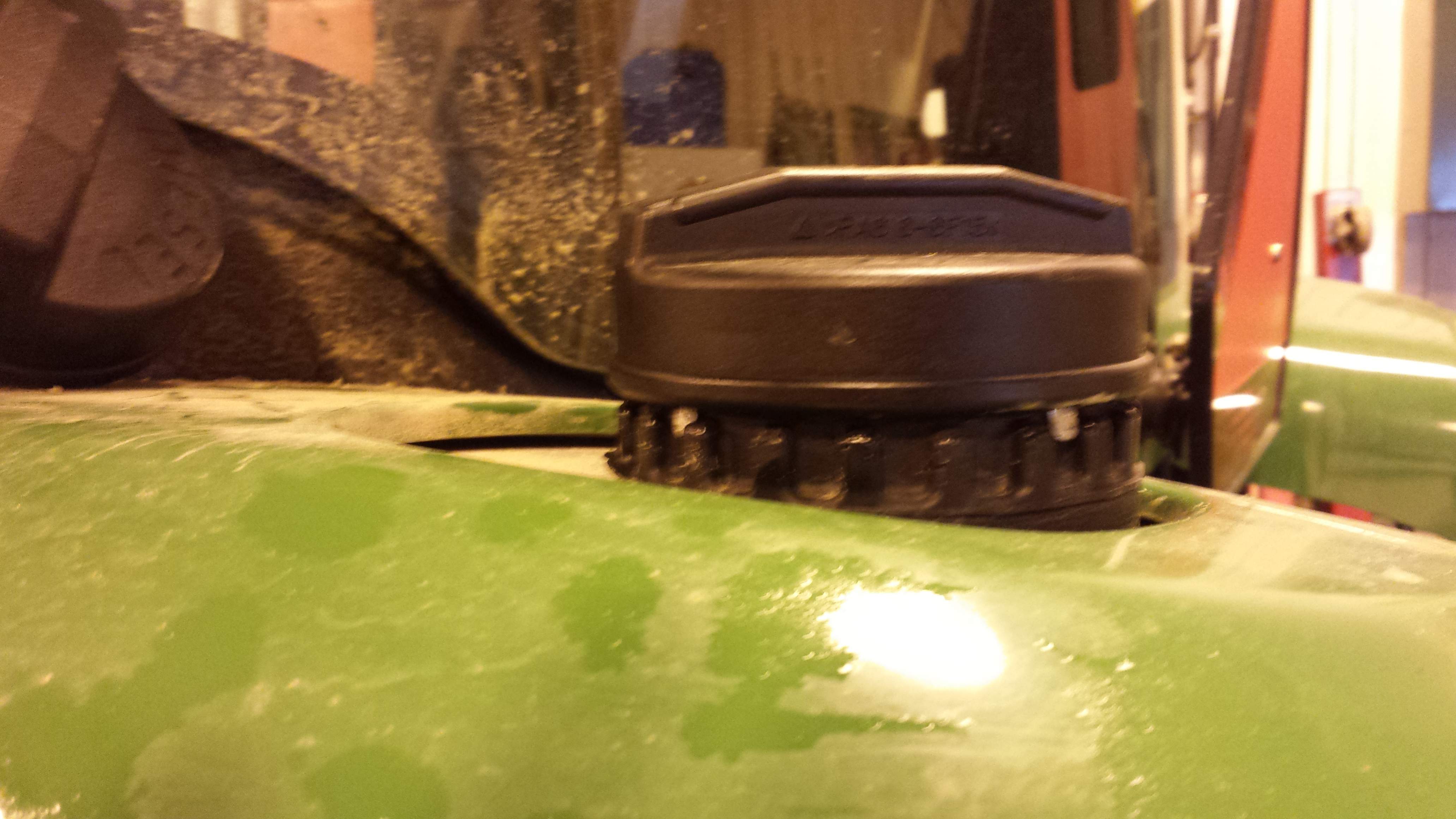

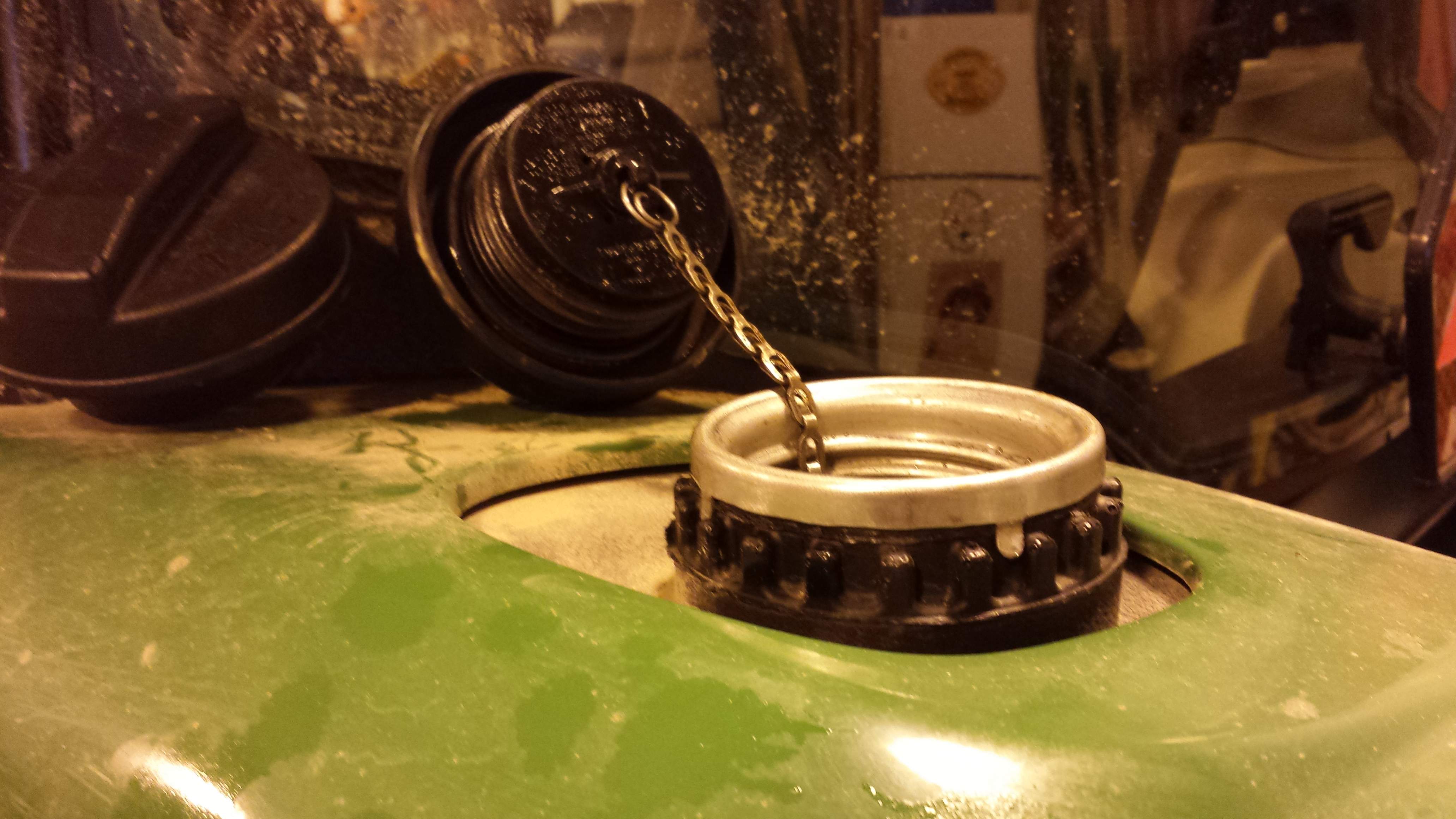

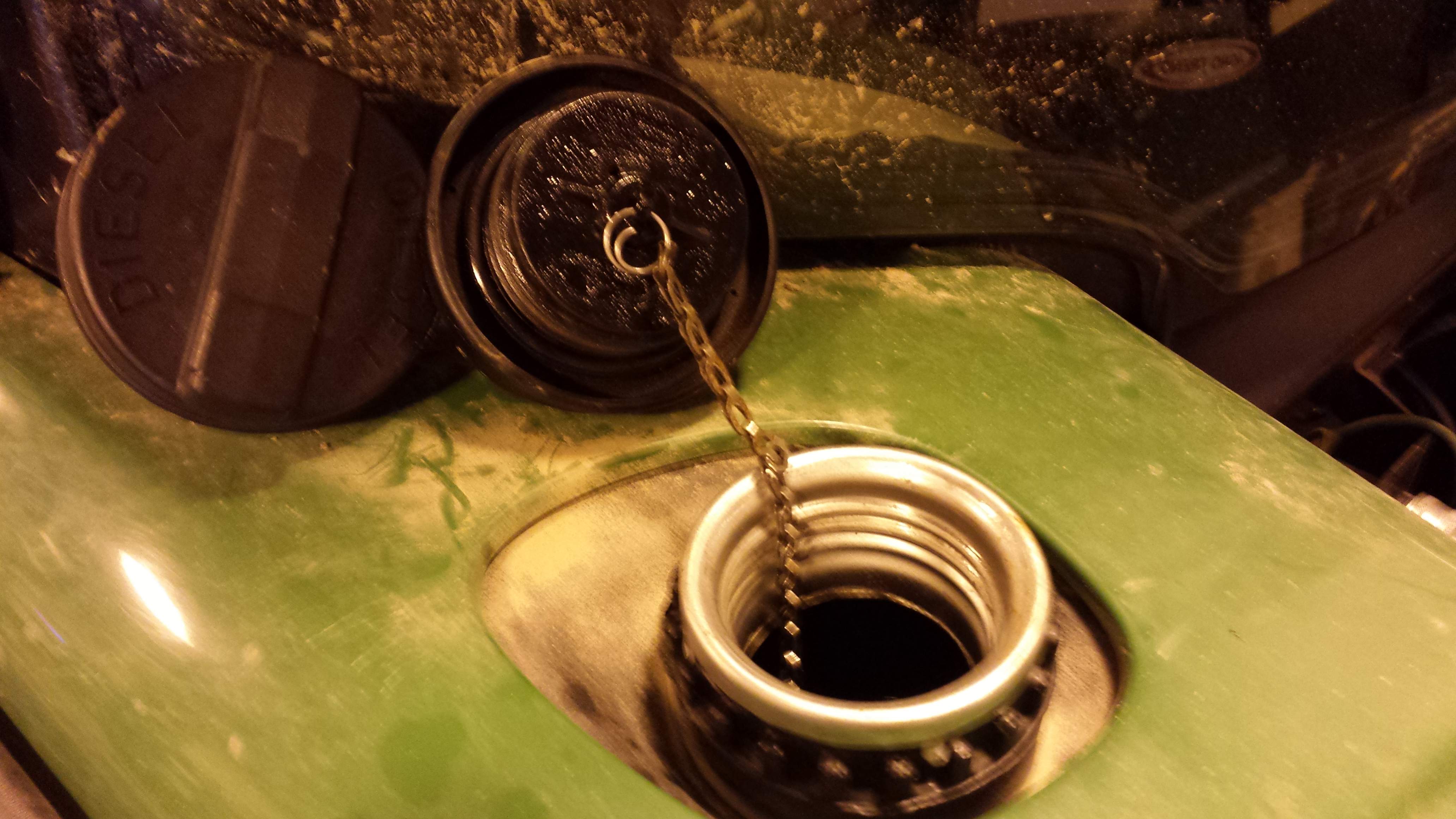

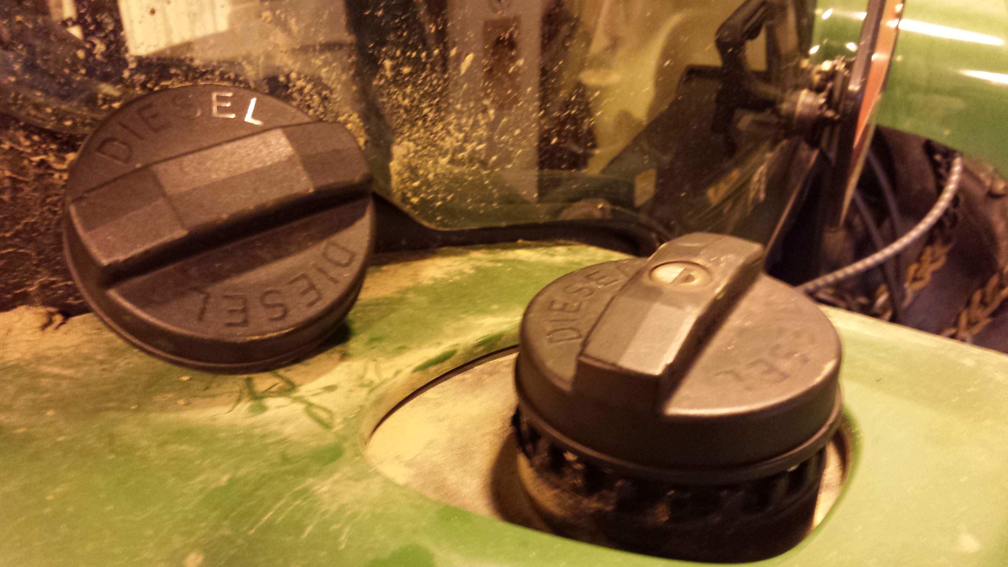

I went and took some pictures to explain this insert. Like I said mine was really rusted and that is the reason I replaced it. My tractor is a 2006 model and both the original and keyed caps are ratchet type. JD must have done a cost out on the cap. You may only need to pull those tabs up maybe 60 deg approx. to get then to bypass the locking reliefs. The new insert is a cheap date if that is the problem. One other thing you may not have the metal liner like my tractor, maybe another JD cost out and you are locked up poly to poly. Then there would probably not be any tabs showing. Hey I have been wrong before. Later. 20150201_140431.jpg20150201_140506.jpg20150201_140709.jpg20150201_140823.jpg
/ Fuel Cap on 4520 (another dumb question) #7
Like I said I have been wrong before. You have a completely different fuel cap setup than my cab tractor. I checked in the JD parts catalog, so disregard all of the above. Later
