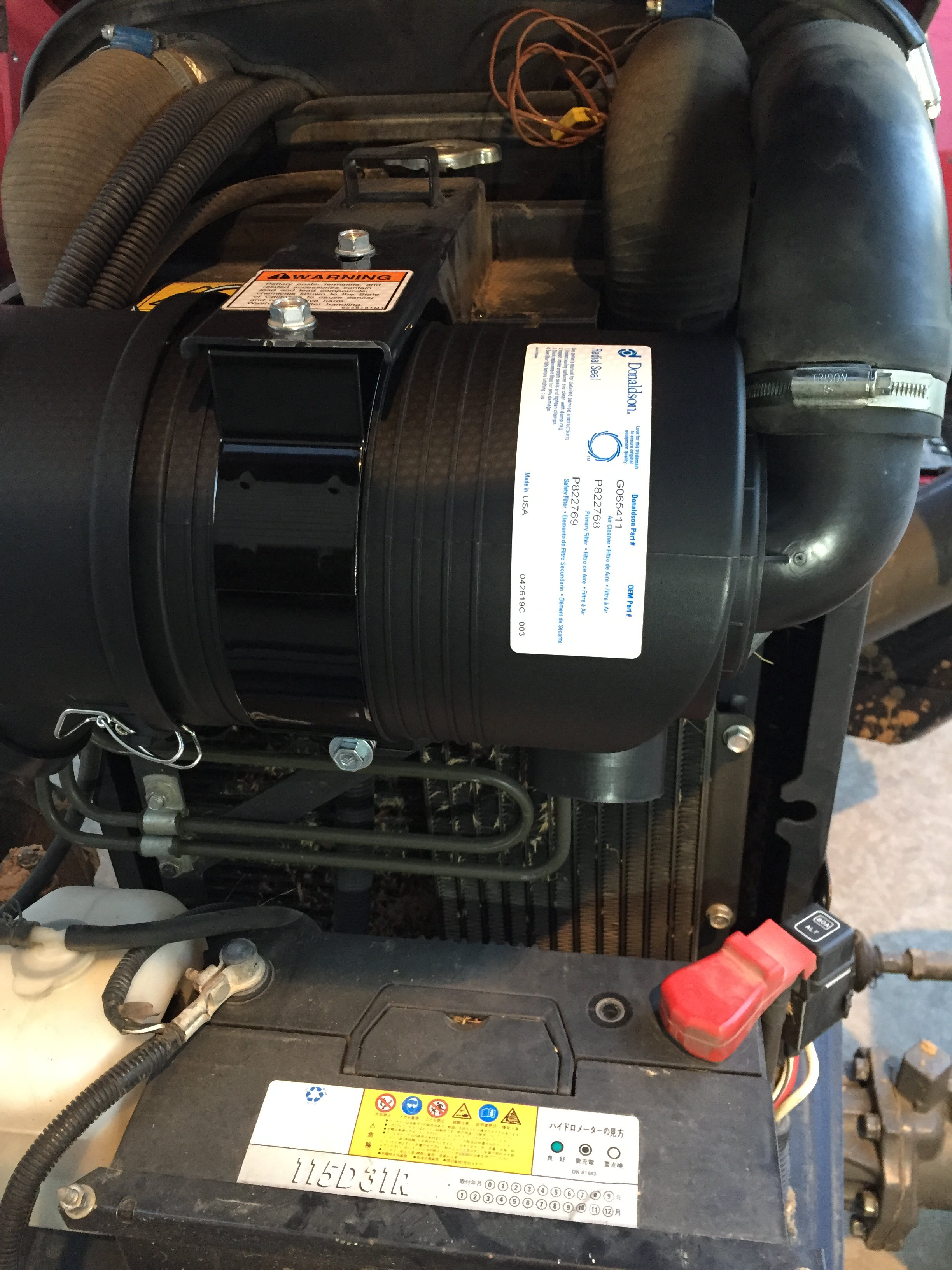

I’ve been watching this thread for over a year and doing my own research trying to find alternative sourcing for 1758 filters with no luck so I’ve gone another direction. Donaldson #G065411 along with mounting bracket #H008441 is a bolt-in replacement for the OEM air filter housing. Prices vary quite a bit depending on source but after some shopping around I had both pieces delivered for $140. The housing comes pre-loaded with both inner and outer filters so for less than the cost of an OEM filter change you have new filters in a new housing that incorporates cyclonic pre-cleaning like the factory original but the real beauty is now your replacement filters are Donaldson #P822768 (outer) and #P822769 (inner) available for $20-$25ea from multiple sources. The oil filter (7064196M91) crosses to WIX 51344 so now the higher frequency filter changes are a small fraction of what they were when bending over at the dealer parts counter.
The 1742’s on up call for the same filters so it should work on those but the 1736 calls for different filters. This likely wouldn’t work on them but Donaldson may have a solution for those too. I didn’t check but Donaldson #G065411 is part of a family covering a range of sizes. The oil filter is the same from 1736 to 1759.

Thanks for letting us know!

Terrific information. THANKS! My joy will be complete when we find the Transmission/Hydraulic filter from Wix.
